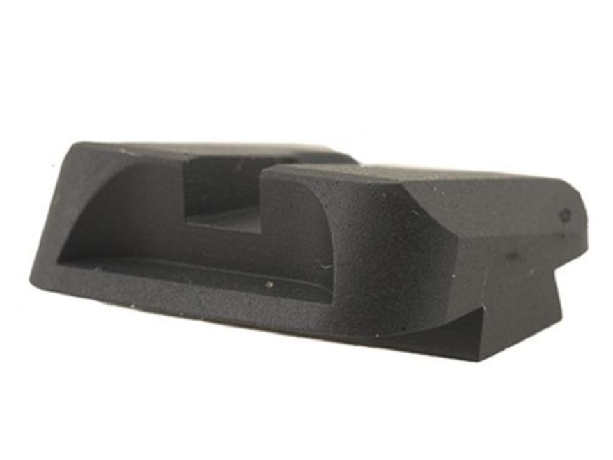

These sights are great for defense, short range, fast sight picture. Big front, wide rear gap. Good setup for compact pistol. Shoot and have fun. :v:
Wow ; I love those sites, who cares how it shoots.
Thats love at first bite.
I’m pleased with the Novak sights I selected.

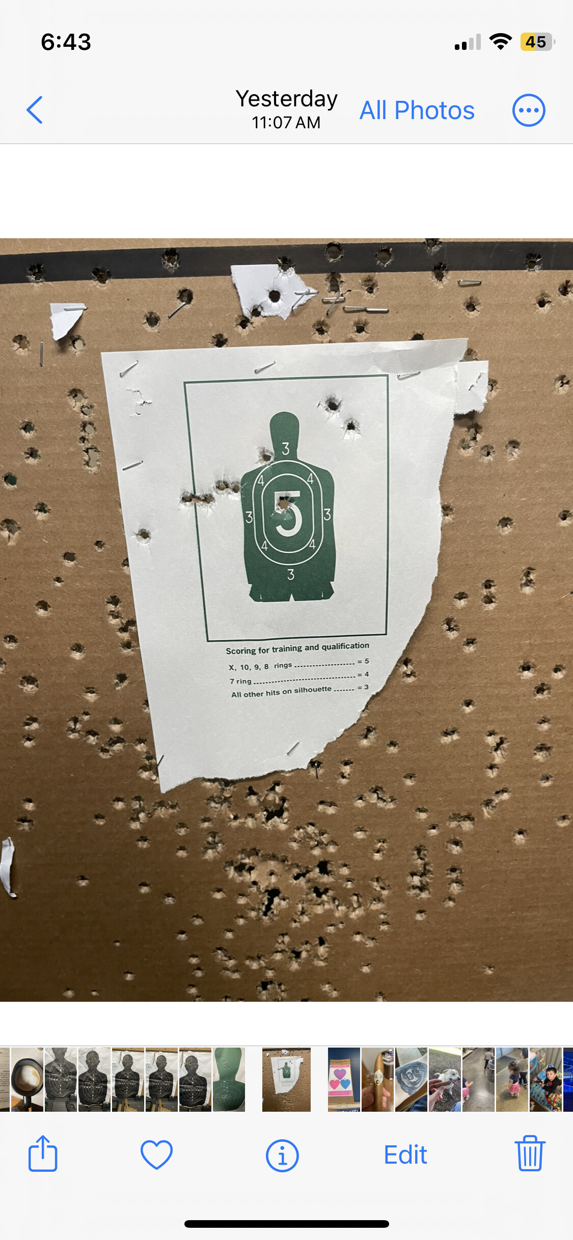

Still seem to go left. Not down just left. I think it might be my trigger pull. My 43X has one of the tighter Glock triggers. Ir feels heavier than my 19x and I’m sure the smaller frame does not help. I get really ocd about this stuff lol. I think it’s a fine set up for self defense.

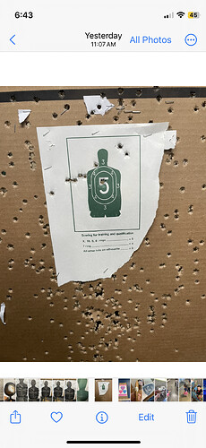

1st pic is various ranges. Range of the target also varied, I was all over 3 yds to 18
Yds though I think I spent more time at 5-10z Some of the shots that seem off target actually arn’t I was trying to shoot the 8 and the 7.
2nd pic I took a small paper and put it 10 yds out. The shot that is right on target might have been from me changing the trigger pull from the pad of my finger to the finger crease. I think pad is still better though because I can rip shots off faster. Wish they were all center.
The OCD part of me wants to just buy new sights and let a gun smith install them (though a gun smith inspected mine and said they looked decent), but then chances are I would be down $100 still shoot left lol.

Yeah I look at those pics and it makes me think of the thickness of the gun. I am not going to get that perfect angle finger placement with a thin gun.
I might pull out my PC Shield 9mm… but that trigger pull is probably less than 4ibs and will likely shoot better. That gun also has a safety. Since I started carrying above the family jewels I’ve found I’m okay with a heavier trigger pull, and I don’t do safety’s for carry anymore.
I love the 43x. I shot it at the range and I was shooting great with it. When I bought my own 43x I do feel like my trigger is not as smooth as the one at the range. I was kind of hoping it would just gets better after tons of rounds because I don’t really like modding the trigger. I’ve heard the complaint that Glocks vary a lot with their stock triggers. Some are amazing out of the box and others are really stiff. My 19x trigger is amazing… but it’s also a thicker grip. I LOVE that gun but the convenience of the size of the 43x makes me prefer that for carry.
I’m not worried about it at the moment, but I’m going to keep an eye on it. I think going smaller with a gun is always a compromise. I never thought I had large hands, but I’m a bigger dude. I add a bigger backstrap on my 19x. So I think the grip size alone. The sights are also designed for fast target acquisition and easy sight pic. Put orange on target and pull trigger. It does work.
So I may be dealing a level of precision that is not necessary, that being said I don’t like that the groups shift left a little bit :joy:. Doesn’t happen with the 19X but it is thick boy that fits my hand like a dream.

I might go ahead and try some new sights. If they were down and left I’d think more of me, but some of my shots should be on target. I’m not in a rush to do it though because I can confidently hit a target 10 yds out. It’s not like it’s off target.
Only thing that stinks is I do like the Ameriglo set up I have with the bright front sight. I might try the true glows again. I have those in an M&P too. I also like the Glock night sights that’s what is on my 19x but they’re not as flashy on the front sight post. I’ll let the gun smith use their fancy pusher, my pusher is a cheap Amazon one.
I’ll think on it and see lol.
I like the tru glows. The Ameriglos were just a bit cheaper and I hear nothing but good about them. Might just be me or how I installed them or the way I’m shooting. But it’s been 2 years so I can justify a new set of sights. I’m dedicated to mullet Glocks now. No intention of changing :joy:
I’m a big fan of the Ameriglos. Have them on my 19 and 43 and haven’t had any issues at least when I’m doing my part properly.
If you have an always on laser cartridge you could confirm if the sights are lined up properly. Though sometimes the laser cartridge doesn’t line up perfectly within the barrel. There is also a very slight chance that for whatever reason the barrel isn’t aligned perfectly within the slide. So the sights could be perfectly aligned with the slide but the barrel could be off just enough to have an impact at longer ranges. I have a cheap rifle that I had to set the rear sight way off to the side because the barrel doesn’t line up perfectly with the receiver.
On the user error front I have relatively small hands and find I need to change my trigger finger position on different handguns depending on the size of the grip in order to get a consistent trigger pull. Dryfire practice with a striker activated laser cartridge can help clean up trigger technique and smooth out the trigger a lot quicker and cheaper than live fire.
When I installed mine I just pushed them in. I did not size it. Ameriglo says this is how it should work, but I know most guys still size the sight. I wonder if between that and my cheap sight pusher I did something.
I just pushed mine in with a very cheap sight pusher. Then I fiddled with them until they seemed perfectly centered. Used a piece of paper with a pencil mark to determine it was even on both sides. Worked better than the real measuring devices I had available at the time.
