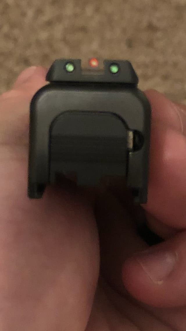

Needless to say I started the day shooting left, and left the day shooting more left with a funky looking rear sight…
I went ahead and centered the rear sights as best I could at home. Figure I’ll be alright as long as I’m not getting into 20 yard gun fights anytime soon :joy:.

There’s also the reality that G43X is a smaller gun than my 19X. (The trigger is also heavier). My expectations with the 43x may be a little high compared to shooting the larger pistol. I like the bigger gun, but I find the 43x better for edc. I think there’s a good chance the sights were fine when I started the range trip, if not slightly off, and it’s more of me being rusty (work was really busy for awhile and I did not dryfire or go to the range). When I drifted the sights further left, you can see the line on the picture…

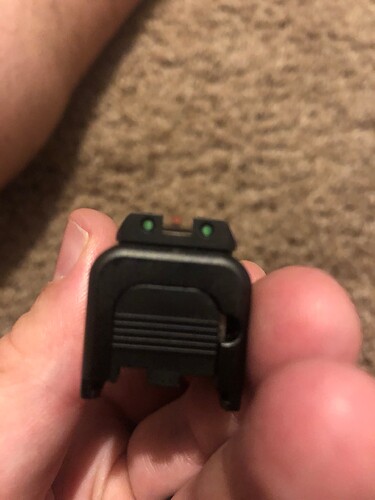

So I looked at the sights again today and they didn’t look right (slightly left) so I grabbed my tape measure and marked the middle of the rear sight and the slide. I drifted it ever so slightly to the right. Of course now it appears to be drifted to the right with the naked eye, but I’m going to stick with the measurements.
Before:

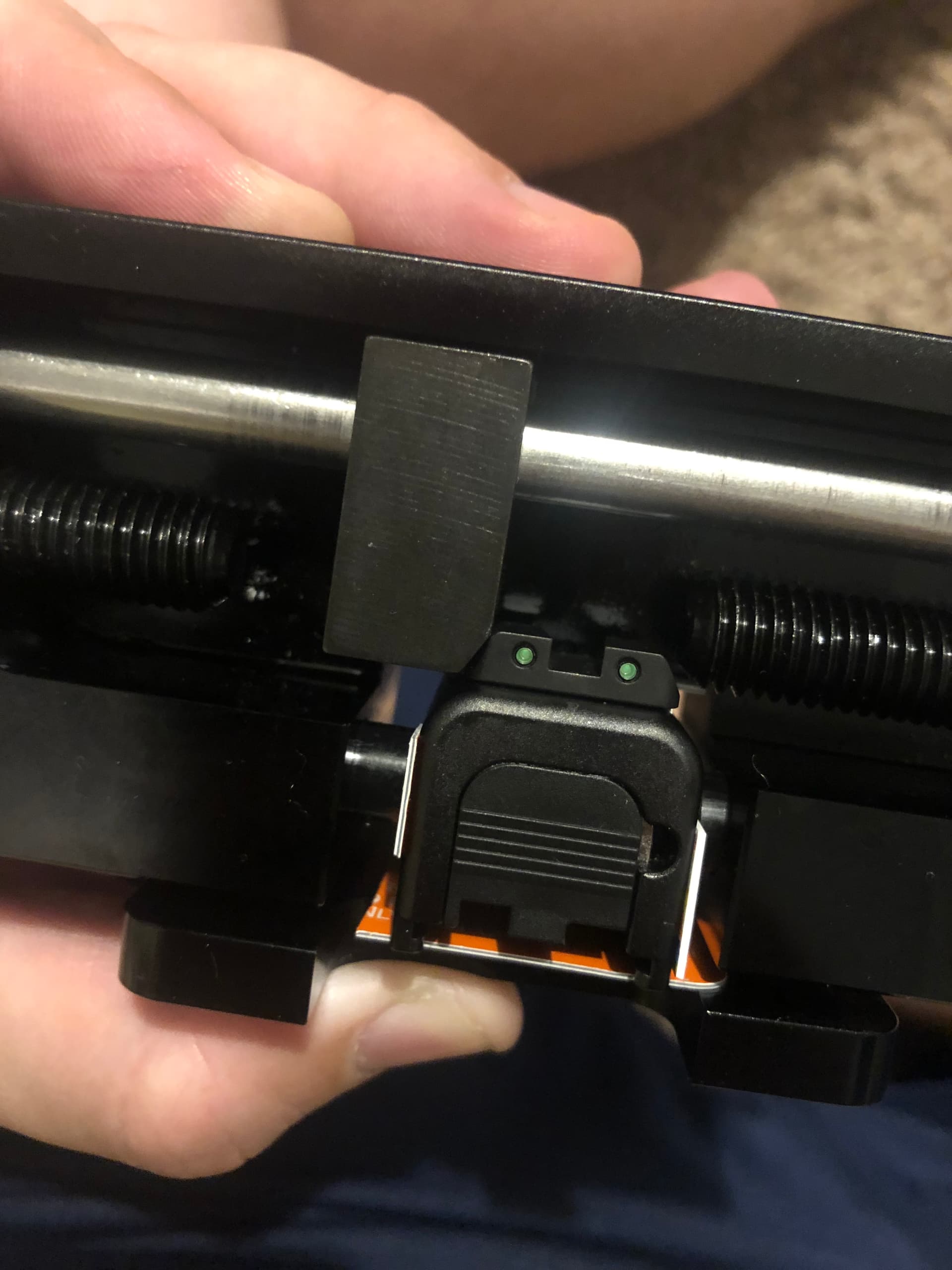

Using my sight pusher
After measurements:
Doesn’t look centered. You won’t be able to do this precisely without caliper. :expressionless:

PS: always make a witness mark on your site with a pencil before you move it around. Also understand that sites without a slave screw have a directional dovetail.
It looked shifted to the left before. I barely shifted it to the right. Now it looks like it’s drifted to the right. It’s like I’m playing seesaw.

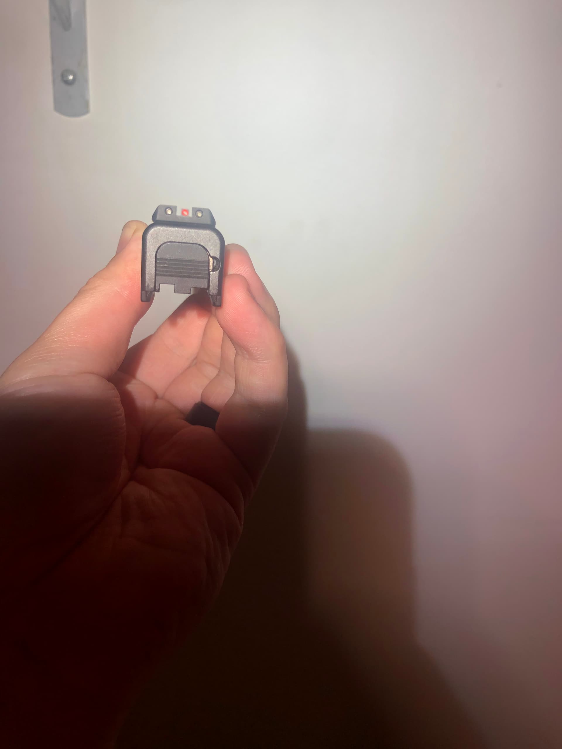

A 2022-06-17 18-26-37
Simple picture pixels measurement.
You are about 20% shifted right.
