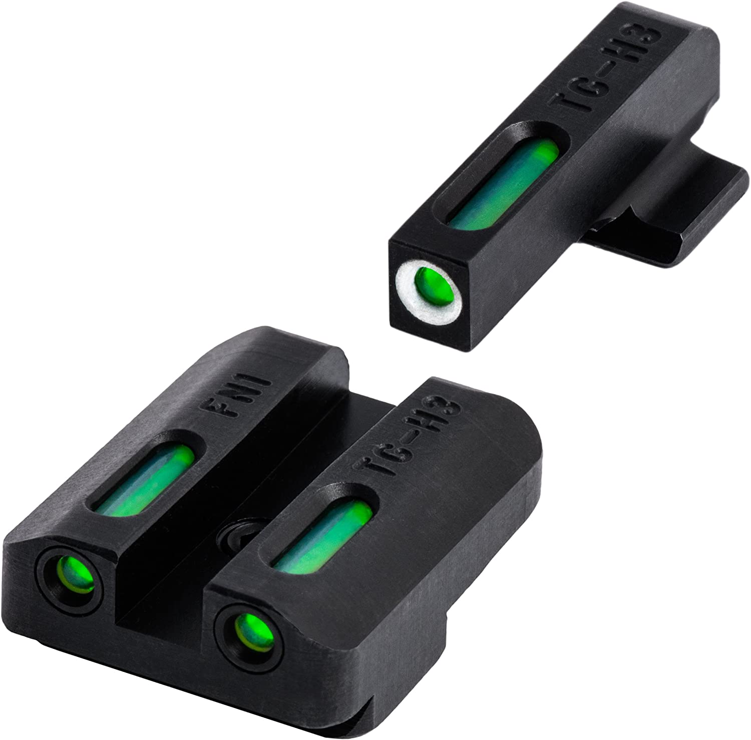

I changed out the sights on a pistol and took it to the range yesterday. I shot it with my elbows resting on the firing line ledge at an indoor range. It consistantly grouped about 3" to the left of where I was aiming with target 15’ out. I shot a different pistol I own with OEM factory set sights and it grouped right down the center, so I don’t think too much of the shift left was me. Also, the pistol in question always shot where it was pointed with the OEM sights.
It has a sight radius of 5.5" now (about 0.5" shorter than the OEM sights). I lost the 0.5" sight radius due to the new front sight:
When I did the geometry, it says I need to push the rear sight 0.092" to the left to come into alignment. That looks like a lot to me!
I’ve never installed sights myself before, so hopefully someone with experience can tell me if this is not unusual, or maybe I should be moving the front sight instead, or maybe moving both? FWIW, I aligned the base of the new sights as close to center as I could measure.

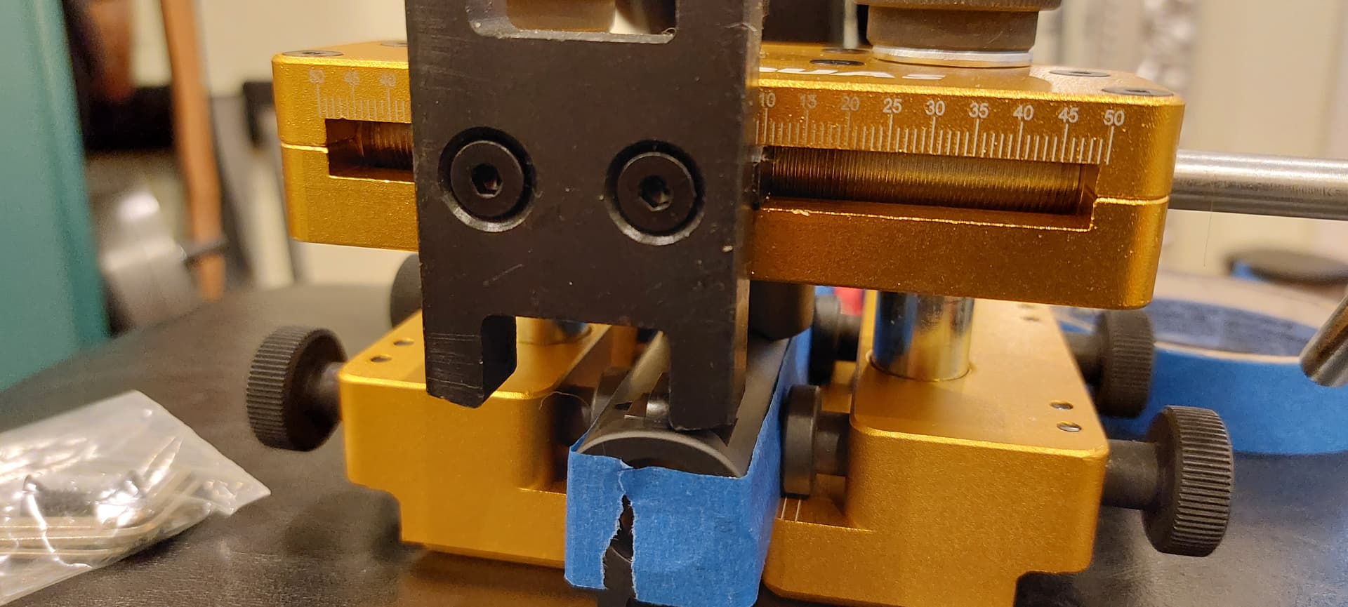

I could not imagine trying to fine tune with hammer and punch. This is a photo of the front sight going in:

I bought the Wheeler universal sight pusher a few months ago. So far, I am very happy with it. I have only pushed the sights on my Sig M17 and my P365 so far. It went well both times.
Still, I found that using some WD-40 brand penatrating oil took the drama out of it. I let the sight blade soak for an hour. I also tapped on the pusher blade/block (the part contacting the sight blade) a couple of times to get it moving while under pressure. The directions tell you about this procedure.

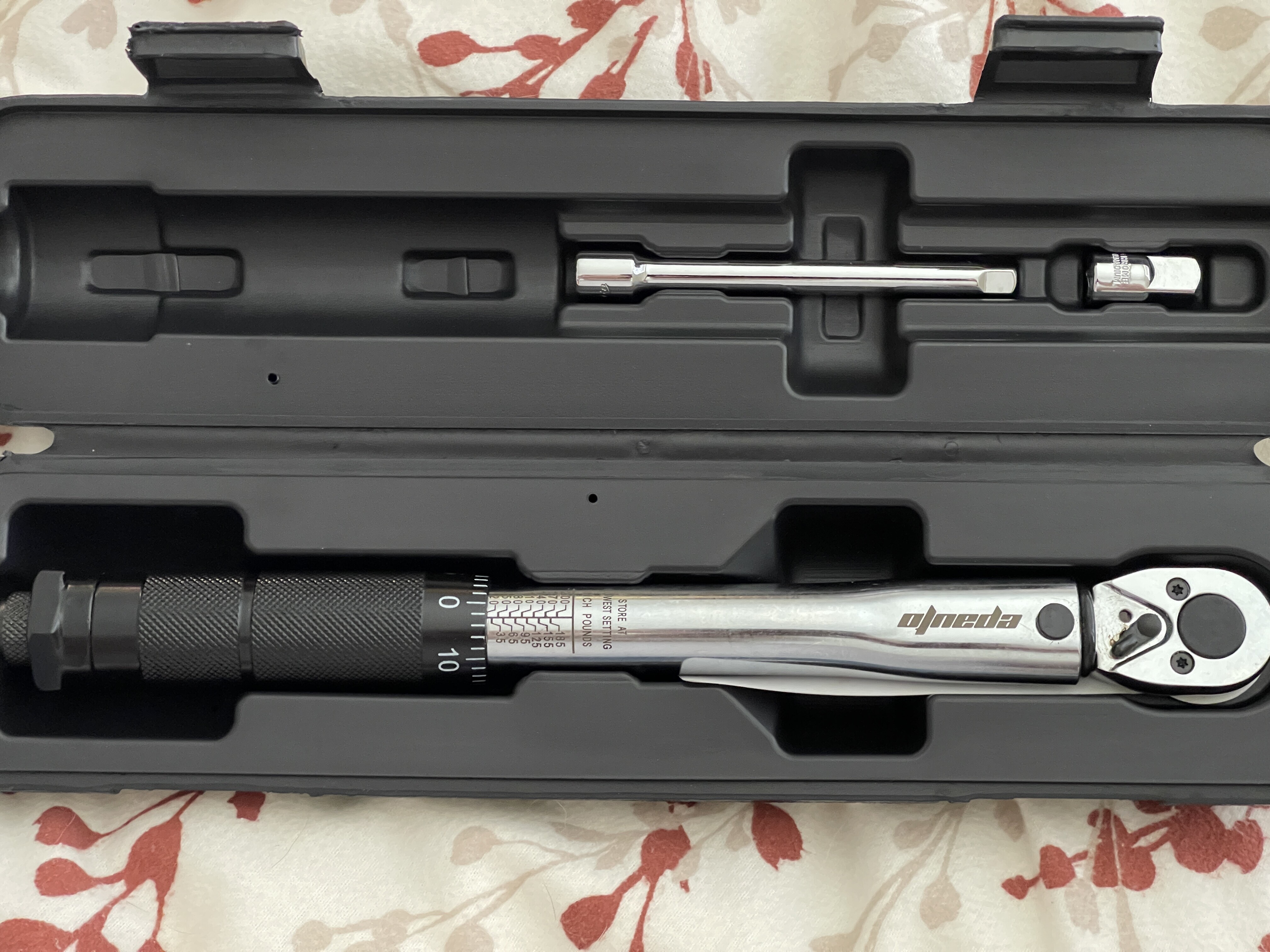

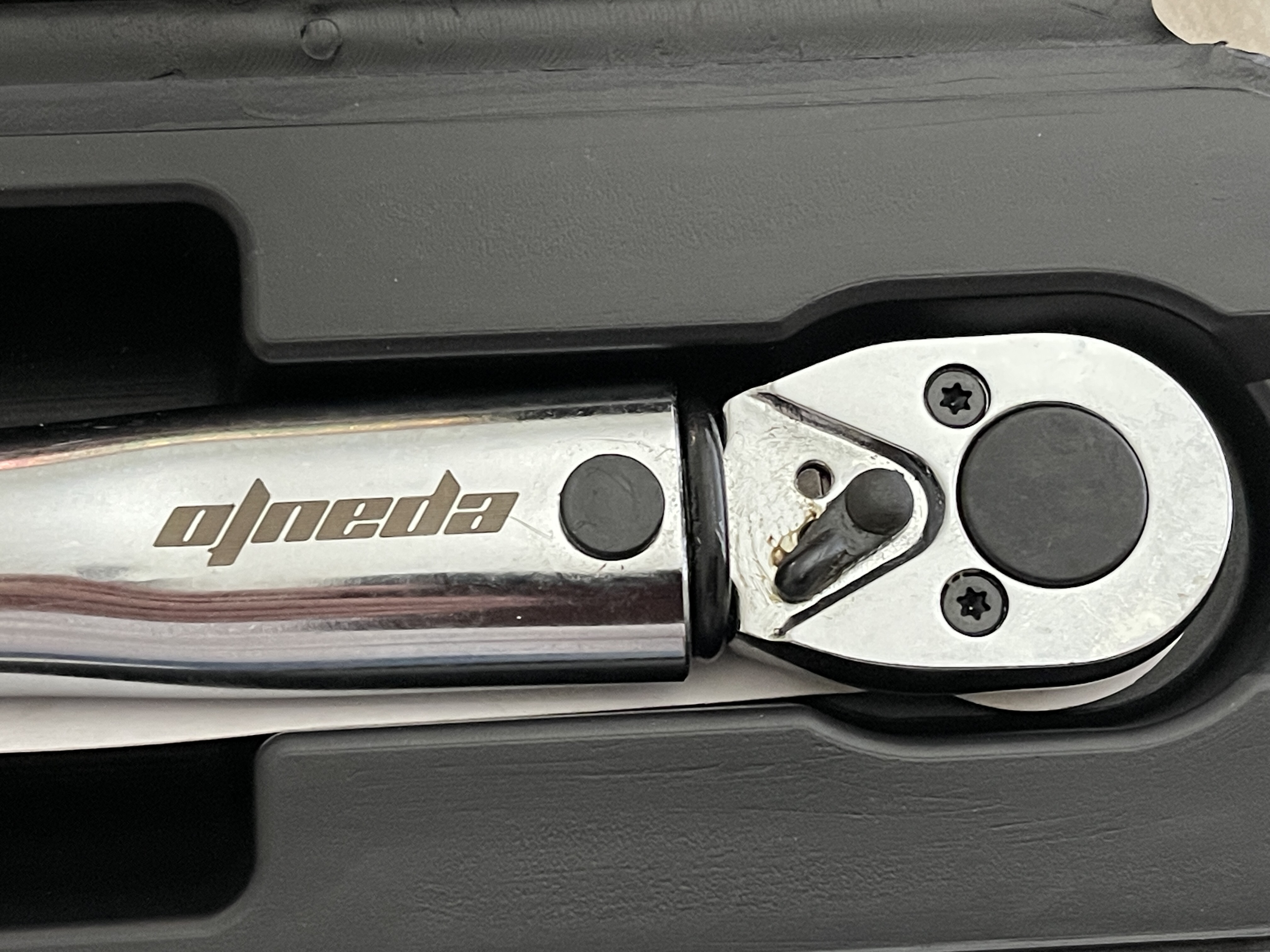

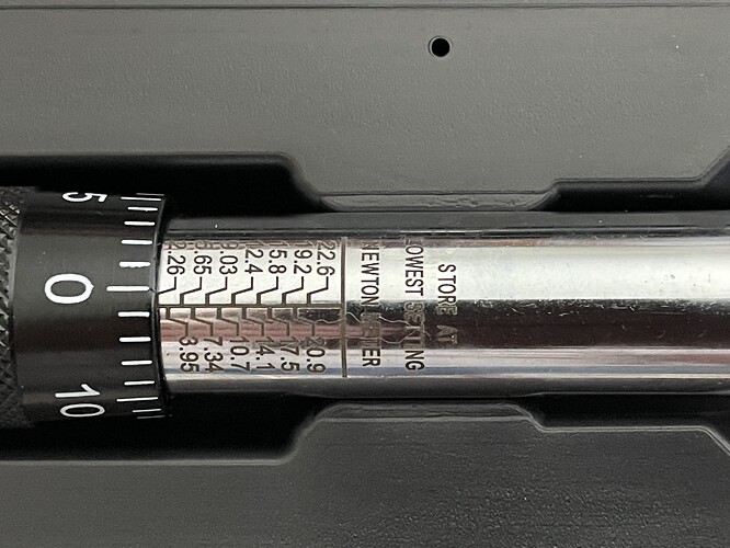

It was a very eye opening experience for me the first time I used a calibrated screwdriver. It is surprisingly hard to put 1 ft-lb (12 in-lb) of torque on a Phillips Head screw.
