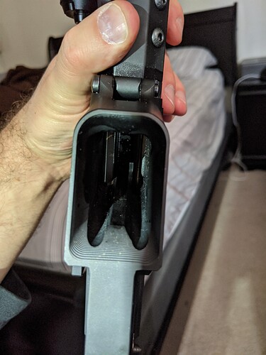

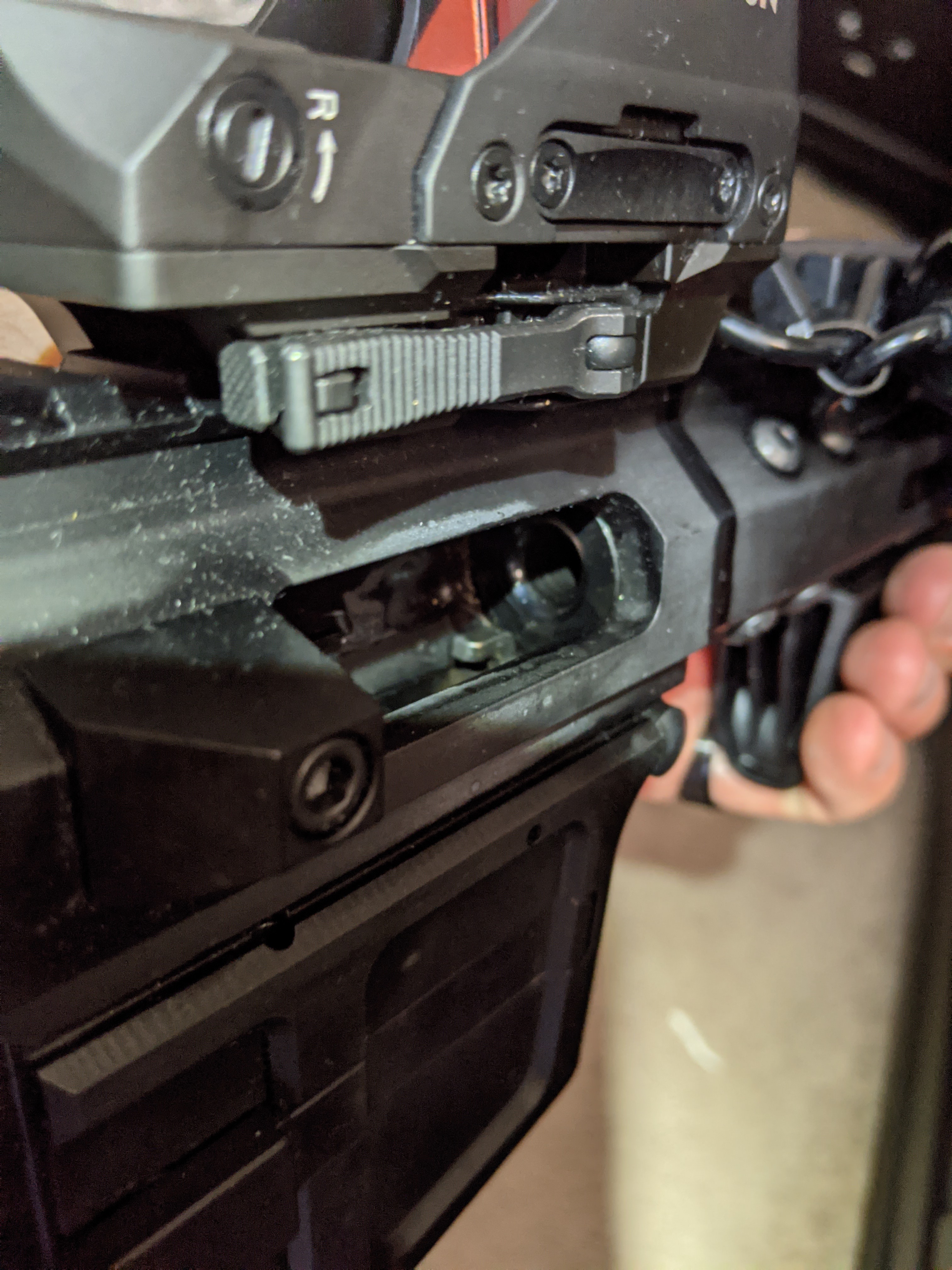

My five Glock OEM mags are all brand new. It’s possible for one or two to be defective but not likely all five. Here’s a couple pictures I took.
Looks like a good run to the chamber. Extractor may be the culprit. Pull the bolt and see if the extractor is in good shape and will pick up the head of the cartridge. Maybe a spur or just something stuck in it. Guessing here but worth a look.
