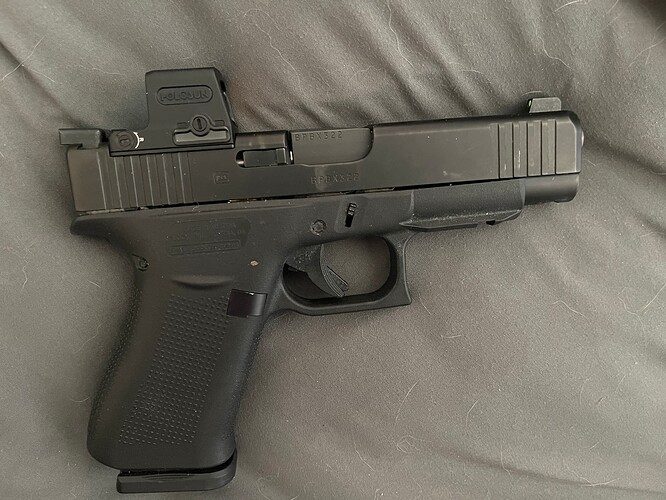

Holosun 507k-gr-x2. That’s a slightly smaller version of the 507c x2, and has a modified rmsc footprint. The shield is a thinner profile, and iirc has a rmsc cut.

Holosun

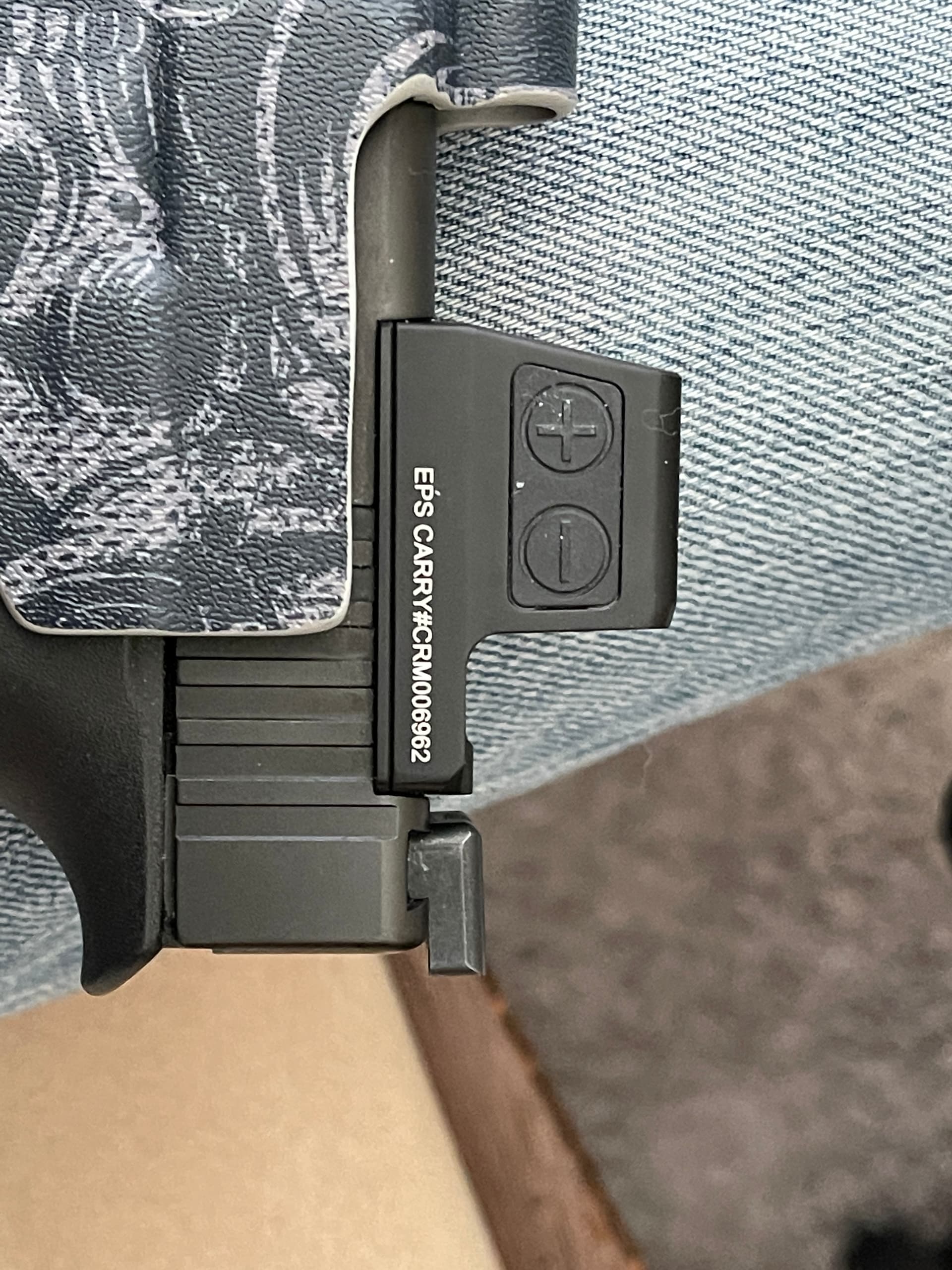

My Shield Plus optics ready wears a Holosun 507K. I would buy the same again. Or the EPS Carry

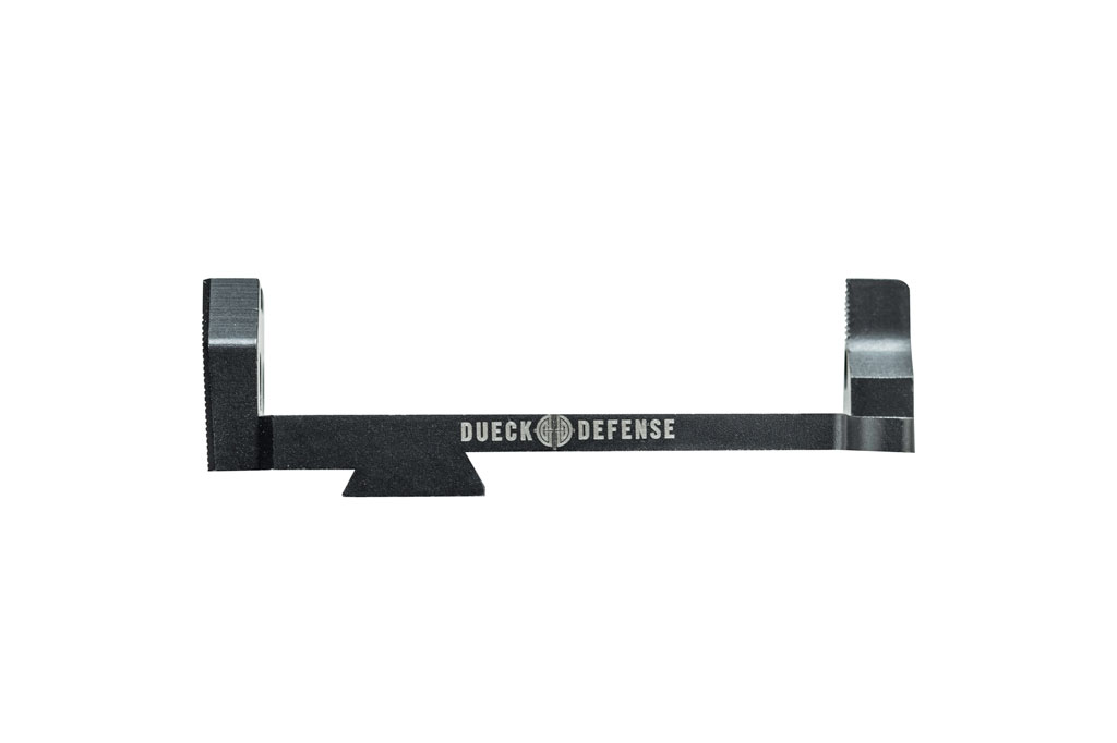

I bought my EZ in 2000 so it’s not “Optics Ready” but the following website has a mounting plate that looks like it will work: Optic Mount Plate for Smith & Wesson M&P 9 Shield EZ and Shield EZ 30 Super CarryPistols
One thing I noticed about that particular mount is that you will have no rear sight. This would matter if the rds malfunctions. Some people have no cowhitness,and don’t mind, but I prefer it.
Yes, I hate that that mount gets rid of my rear sight, but I’m not sure what options are out there for me. Thank you, Levi2.
