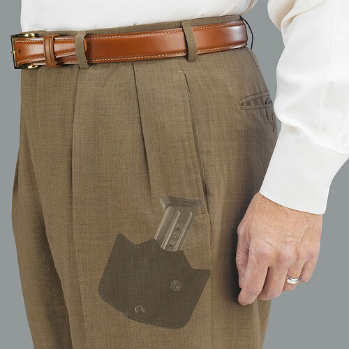

Although no experience with the NeoMag, I’ve been using the Galco PMC (Pocket Magazine Carrier) in my jeans for years with my single stack 45 mag and love it.
Here’s the link to the P365 XL version: PMC Pocket Magazine Carrier
Thanks, I haven’t seen that one. I’ll take a look at it. A question I have is when you pull the mag does the holster want to come out with it or is it like a sticky holster that will stay where it is at.
It’s the rough side of leather, and the shape of the holster helps hook it in the pants while pulling out the magazine. I’ve only worn it with jeans or jean style pockets, so I don’t have experience using it with dress pants or horizontal cut pockets. It also has a tension adjustment screw.
The hook design on the magazine is common for pocket holsters for pistols/revolvers.
