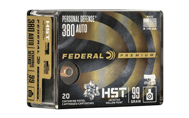

For 380 ammo. I have an LCP 380 and have done a lot of looking at ballistic test. The best for both penetration and expansion appear to be the Federal HST and Sig Crown. Just MHO.
I can’t speak to the Sig Crown ammo but the .380 HST is the only HST caliber that I do not trust based on the properly done tests I have seen. There is some variability in the tests but it has a disturbing tendency to over expand and under penetrate through properly calibrated bare ballistic gel and the tip tends to clog after going through denim layers with little to no expansion and significant over penetration. Not sure how they can get the HST to perform so reliably in other calibers but it is so unreliable in .380. Though they have similar unreliable expansion issues with their 9mm 150 grain Micro HST out of very short barrels even though it was supposedly designed for short barrels. Their standard 9mm HSTs seem to perform reliably out of short barrels.
The new Federal Hydra Shok Deep seems to perform consistently well through bare and covered ballistic gel based on all the tests I have seen and many of those tests were done with the short barreled LCP. My choice before that came along was ammo loaded with the old Hornady XTP bullets. They don’t expand very much or very consistently but they seem to always penetrate within the FBI standard range of 12-18” regardless of how much or how little they expand.

You are correct. I confused one of my 9m preference with 380. I feel shame
. My second got to 380 is Hornady Critical Defense. Those are just my choices to make the 380 a respectable defensive round.
