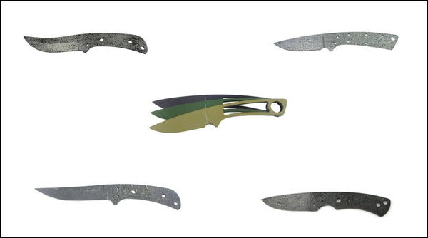

Yeah, most of the time a Damascus billet will not come hardened. Here are some kit knives that will come hardened, and all you have to do is put them together. The steel type is not listed, but you can always contact the company for the steel type. I order materials from here and they have never let me down.

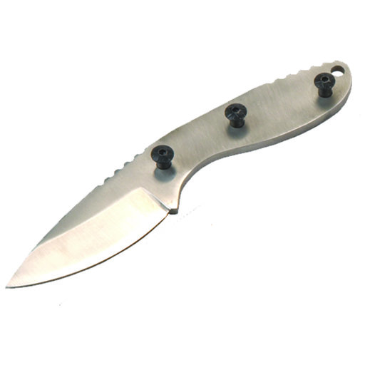

This is a kit I used from the WoodCraft store that I got on a whim one day
This is what it ended up like after I re contoured and shaped it, I buried the pins inside the scales for the “no show” look.
On it’s maiden voyage I ended up taking apart an entire deer with just this blade and my EDC pocket knife. I spent a lot of time getting the scales to perfectly fit my thumb and middle finger when gripping it, the index finger rides on the spine of the blade. It was a fun build and has served me well over the past several years.
