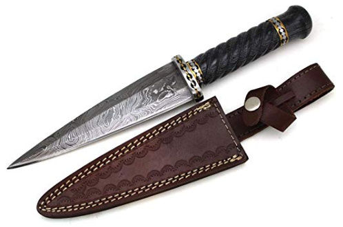

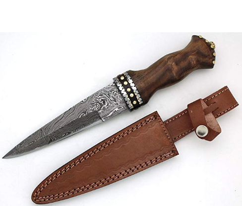

I’m also looking for a boot knife and looking at these:
either this style:
or this style:
or maybe this

As a side note, your dirk or dagger styles are not good choices for general everyday use. Also a lot of people end up cutting their self with one until they learn not too.
@Jacob2
Another reason to avoid dirk/daggers is some states have laws against double edge weapons.

I know you won’t like this, but if you’re going Damascus you need a reputable knife maker using quality steel. Because of the nature of damascus a lot of Pakistani knife makers are cobbling crap metal into beautiful looking pieces of art. But they will fail when put to use. It’s not just Pakistanis doing it, but a majority of the people doing are. The quality smiths doing Damascus will ask for a lot because it’s a lot of work in addition to the costs of materials. That’s the nature of Damascus unfortunately.
