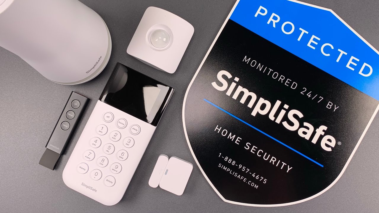

Simplisafe - started as an alarm company, has expanded into video, doorbells, etc. Doesn’t work without subscription, subscription includes professional monitoring which calls 911 for you if needed.

We have SimpliSafe at work, home, ranch, church and in our travel trailer.
We’ve always an easy time setting them up and maintaining them.
From what I read about in the comments section on Youtube, Simplisafe has since updated their system this year and the $2 device is longer valid to override the system. I would contact Simplisafe CS to verify with concerns or questions.

Simplisafe offers wifi cameras with a steel shutter that slams closed when not in use. Added privacy in entry / indoor areas.
