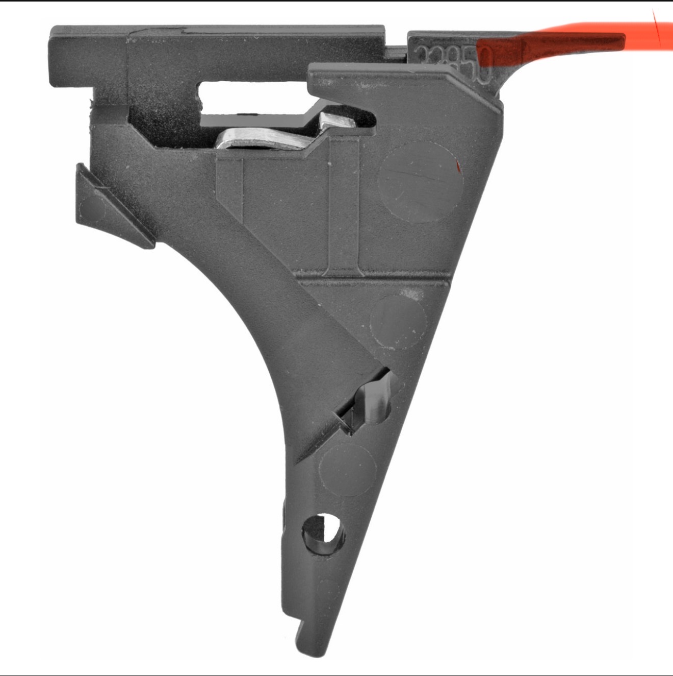

Had 2of these at the rang today (2 out of 200+). I haven’t had time to check out the gun yet but from the looks of things they must have come straight up instead of feeding horizontally into the chamber?
Twice? :thinking:
It looks like the round hit the trigger mechanism housing
Double feed?
I hadn’t thought of that one, but on the second occurrence when I cleared the gun two round fell out…
Do you have a spare magazine you can try next time?
Thank You my friend Another good one. The failure occurred with an after market Promag .22 LR 25-Round Magazine for Glock 44 . Next time I’ll try the CA compliant 10 round mag that came from Glock
I think that’s the only round count that is OEM for the 44.
