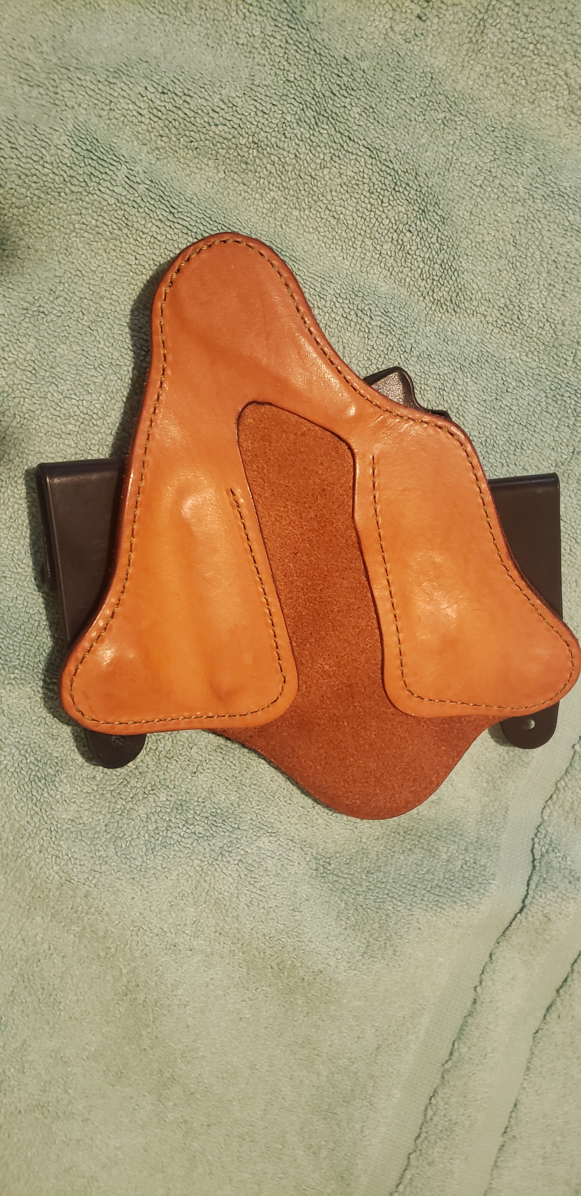

Here we go, have a IWB holster fits well and holds the XDm well. When I draw, as
in practice draw - my weapon clears my shirt and all well. When I go to put it back
in, I find it almost impossible to return my weapon to my holster. Are there pieces
on or in the holster that need tweeking. New to IWB holsters, that is why I am asking.

May sound silly but are you over tightening your belt. I think you have a high bred IWB holster, kydex and leather backer. Or try lowering the clips on the holster just so the flared lip of the kydex is obove top edge of your pants.

Here are pictures of the Minotaur IWB I am trying to get working. OldGnome, I do not have trouble with my kydek OWB with reholster. I carry at 3 oclock and all has been
good until I started working with this IWB. Is it possible that my belt is collapseing
the kydex holster after the weapon is drawn? I am going to try as Craig6 suggested
and move the clips so the kydex on the holster is above my waist band. Thanks
Craig6 for all your suggestions.
The clips are already high enough, to the previous suggestions.
The kydex shouldn’t compress to the point that it is making reholstering difficult. I do see screws involved in your kydex portion where in my hybrid holsters, they are usually riveted.
You could, however, have your belt too tight that it is making the LEATHER compress and make it difficult to reholster.
I have a similar construction alien gear cloak tuck, and it worked perfect for my Smith SW40v, but when I changed out the kydex part to fit a Glock 27 on the same backer, it pinched the pistol so tight I couldn’t remove it or get it back in. Worked perfectly after I put wider spacers under the kydex. Glock 27 has a smaller frame and allowed the leather backer to bend more around my hip area.
I’m thin physically. The leather backer deforms further than intended as I try to bring it around to 3, rather than its designed or intended 4-5 position. When it deforms on my hip bone, it pinches the pistol frame.
When it is set up right, and worn in the right body location, I really like the AG holster. Very comfy all day.
@Glock27ccw - Thanks for the info, My EDC is a springfield XDm.
I will try moving the the clips so the kydec is above my waist band
and loosen my belt, and move towards the 4 oclock position. We
shall see what happens. Mike
@Glock27ccw I am so OCD that I will go to extremes to make this holster
work. If I have a holster to carry with I will make it work some how some
way. Be safe and carry.
Do the clips go under the belt such that the clips are clamping onto the fabric of your pants? If so, it would seem the belt is not supporting the holster during re-holstering, but rather holding the holster down during the draw. If that is the case, you might try a different clip design.
