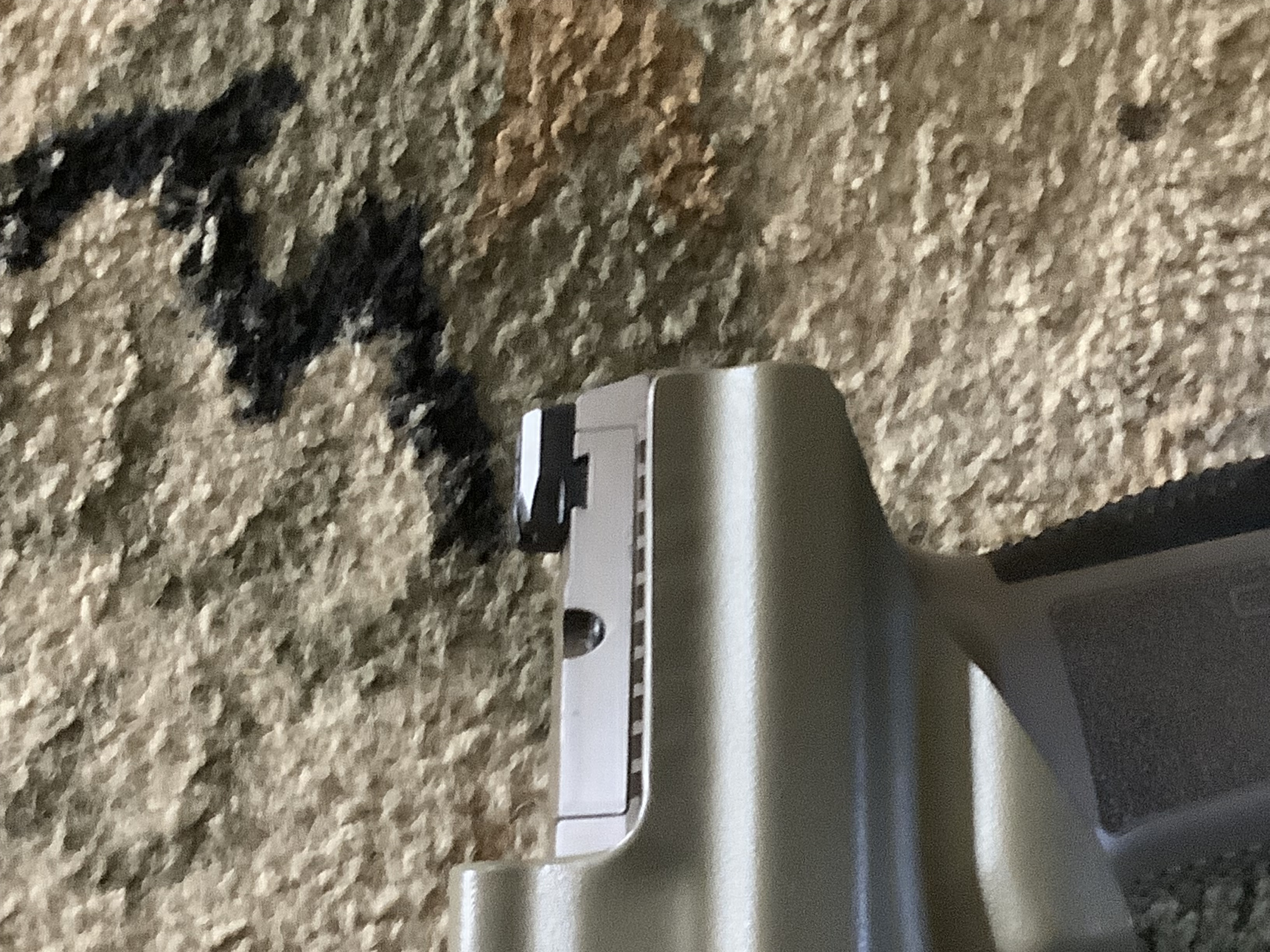

I had to get a new holster for my TP9 because in the old one the TP9 was digging into my side creating an open sore. Also I have lost some weight and am taking up more of the belt to cinch it down tight. The TP9 clicks into place which I like but it’s slowing down my draw considerably. I’m working on the draw but just can’t seem to find the right way. Saddest part is I just bought the thing and really don’t want to buy another if possibly.

I’m carrying it OWB between the belt and pants waist. It’s not the holster digging into me, it’s the gun slide. The maker said it was designed for a TP9….
So the holster is actually shorter than slide?
Yeah, some manufacturers made such type of holsters (I still cannot understand what might be the reason to have muzzle sticking out from the holster). :thinking:
In such case, I recommend a new holster that covers muzzle. You will have more room to play with discomfort.

I’m a little confused from your posts.
  1. Does the new holster have the problem with the slide? Or is that not an issue with the new holster?
  2. Are you saying the problem with the new holster is that it is hard to draw because it’s tight on the gun?
  3. Was the holster designed to be OWB or IWB? If it was designed to be OWB, have you tried it on the outside of the belt instead of between the belt and your pants? I would think that some OWB holsters if worn inside the belt, the belt might put extra pressure on holding the gun inside the holster making it harder to draw.
  1. Looking at the holster, it has a thin tab coming up to cover half of the slide. The upper half of the slide is open and the corner of the rear sight is exposed.
  2. Yes and that the holster wiggles during the draw canting the holster forward and I have to reposition the holster back on the belt. It’s like the belt clip isn’t big enough to fit the belt.
  3. It was designed for OWB.
