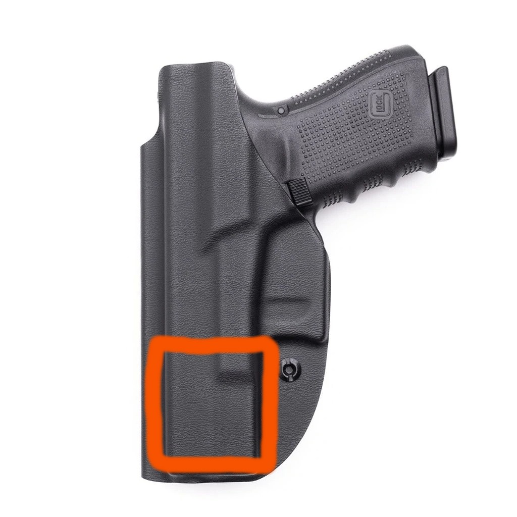

I grabbed this image off of Vedder’s website (pretty sure it’s the right one?), put the heel pad/cup in the orange area. It will prevent the muzzle there from pressing against your pelvic area. To prevent it jabbing in the leg when you sit, try skootching it left/right an inch or so along the belt

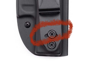

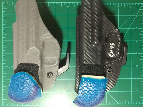

I use a Vedder Light Tuck for my most carried pistols (CW45 and PM45). I had to make some modifications to make them very comfortable for appendix carry (1 o’clock).

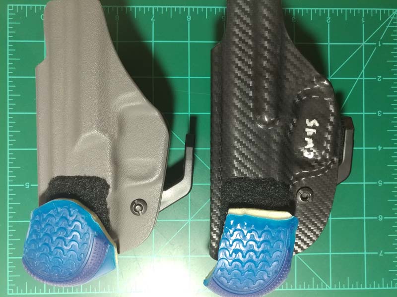

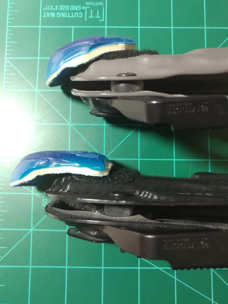

The PM45 is so small that I didn’t have to make adjustments to the ride height, but I did cut down an inexpensive gel shoe insert to be both a wedge and something to smooth over the edge at the barrel end. I got self adhesive velcro from HD, put the soft side on the holster (so that if I don’t use the wedge it wasn’t abrasive), and the hook side on the gel insert. Also worth noting, for the “wedge” to better conceal it needs to start below the belt line.

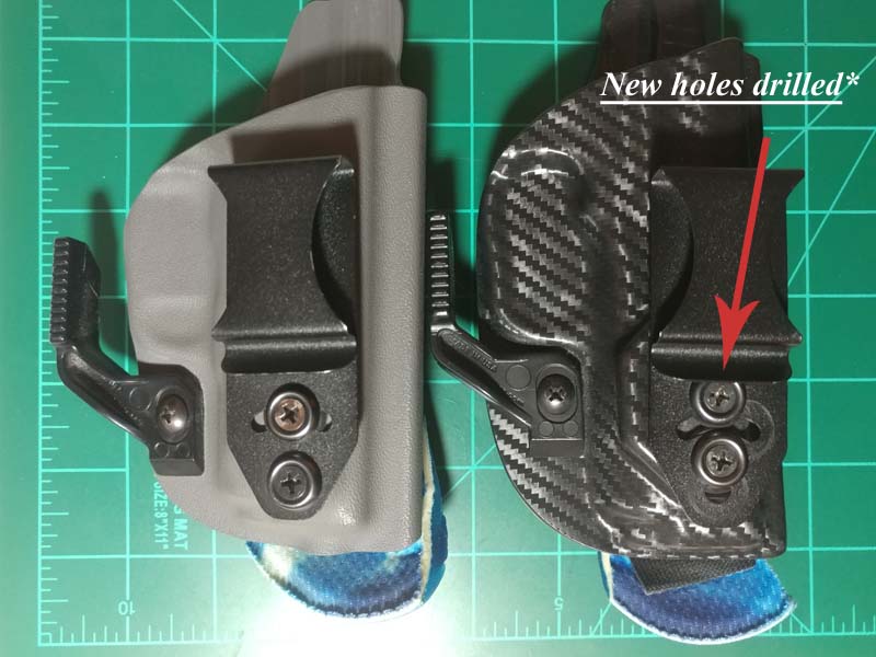

For my CW45, in addition to the gel insert/velcro, I drilled two holes in the metal clip to raise the ride height. The barrel now sits a hair higher than on my PM45 setup, and is at least as comfortable as my PM45 setup.
Side note: I use the Vedder Claw for better concealment (the improvised wedge also helps).
Edit: Attaching pics. It won’t win any beauty contests but boy does it make a difference in comfort and concealability for me. *Used carbide/concrete drill with drill press on slower setting and oil plus an aluminum backing under spring steel clip when drilling. Touched up holes with Rustoleum paint to prevent rusting.
