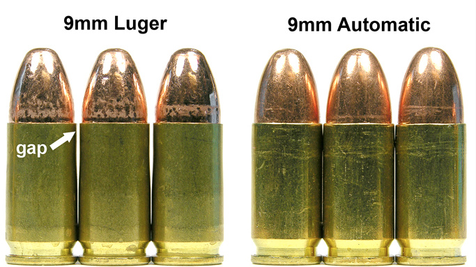

What experiences do folks here have using Luger vs. Auto with the P365 or XL variant? Have Luger rounds ever jammed and, if so, more or less often than Auto rounds?
I bought some Gold Dot Speer defensive ammo when I picked up the XL but noticed it was Luger and I haven’t heard many good things about Luger ammo (malfunctions and what-not).
Maybe there’s a difference that I don’t know, but I thought that they were the same.
The casing of Luger ammo is a bit smaller near where the slug sits. With Auto, I believe the casing is the same width for the entire length.

Today I learned there is a 9mm Auto…
Thanks. That’s pretty much the info I was looking for!
I think you may be confusing the 9mm Luger, Parabellum et al with the 380 Auto also known as the 9mm Kurtz
The 380 Auto (also 9mm) is a straight walled case (0.373" all the way to the base) while the 9mm Luger is a tapered case (0.391 at the base and 0.380 at the mouth).
That said you can shoot 380 in a 9mm (much like the 38SPL and the 357 Magnum) but it may or may not have enough “ooompff” to operate the gun depending on the platform. There is also a difference in rim diameter 0.374 for 380 and 0.394 in 9mm Luger.

I think 9mm Auto never reached mass production. It was a prototype made from .38.
9mm
Hmmm. have I just copied @Enzo_T’s post… :stuck_out_tongue_closed_eyes:
The gap in 9mm Luger may cause a problem with feeding from magazine, but simple “mag tap” levels the rounds evenly and no more issues.
