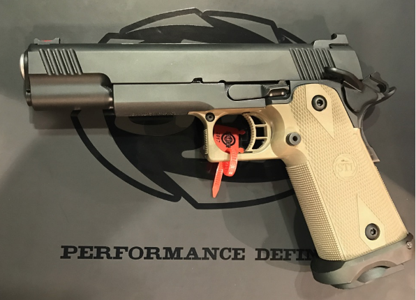

Classy 2011:
sti2011
CC 2011 (single stack):
stacattoc
The staccato c is a very nice shooting STI.
