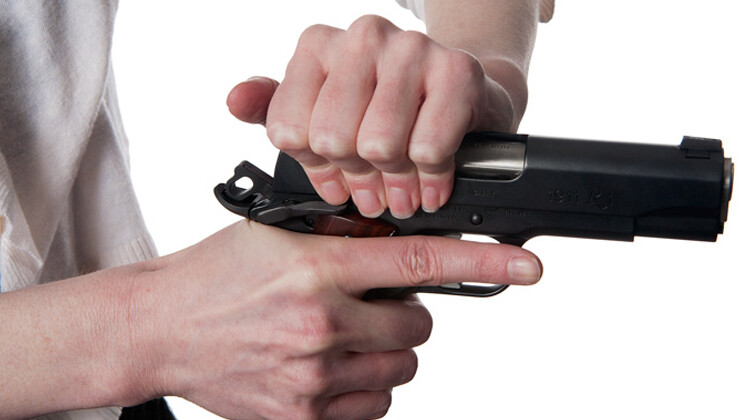

Great points all. I remember once when taking a newer person to the range— asking them to stop and let me know if the there was no “bang”, and keep it pointed in safe direction, until I could inspect it. There were .22’s, so we had a few “hangfires”.
This link talks about what a “squib load” and “hangfire" are, the importance of hearing, seeing, feeling one before and when it occurs, and what to do next. Do it safe, check your range-bag first aid kits so they are still properly stocked.
