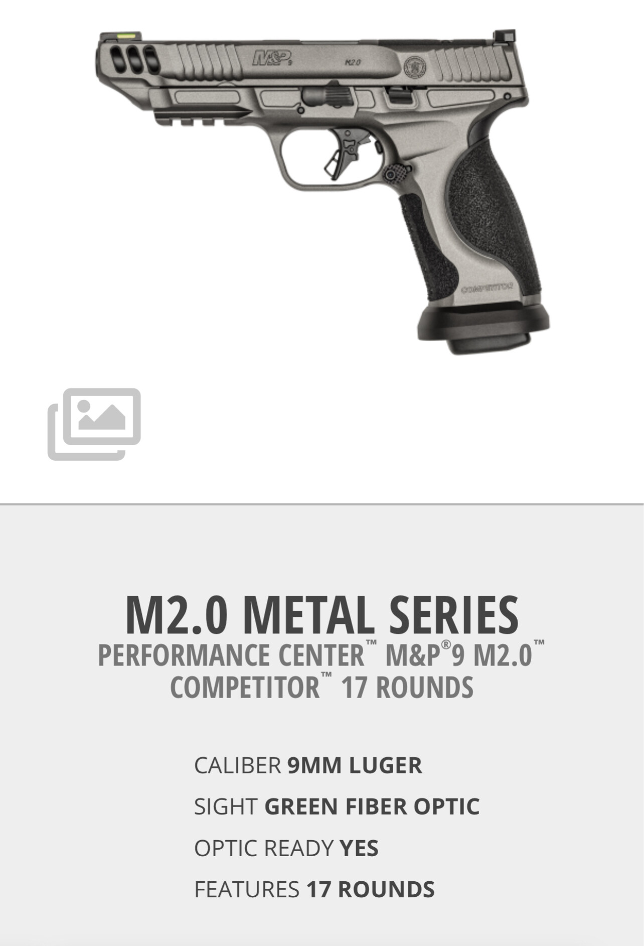

If you talk about straight trigger of non 1911/2011 pistol - there is a simple explanation.
That trigger operates on the axis. The trigger pin is located on the top of the trigger shoe creating the hinge.
When you press it to the rear, you need some strength and additional movement of your trigger finger to pass the virtual line coming down from the trigger’s pin (the hinge) .
When you use the straight trigger you need less power and less movement of your finger to achieve the same result.
The ideal trigger is flat and perfectly vertical. To have even less extra movement - 1911/2011 is the solution.
This one can be considered a perfect non 1911/2011 trigger:

Some are getting on board. Smith and Wesson is doing a great job of mimicking Apex swaps and putting really good factory flat face triggers into their M&P 2.0’s and Shield Pluses
M&P M.2 is a great example of manufacturer being listening users’ complaints.
Thousand owners swapped the original hinged trigger to Apex and then posted the info on official forums.
Now the legal problem with changing trigger has gone and people are more willing to buy and carry stock M&Ps.
Part of the reason I sold my Shields was to buy the Shield Plus because I had Apex trigger and Talon grips on my Shield and then the Plus not only added capacity but had a “factory Apex” trigger, basically, and also a superior grip so no need to add to or modify the grip.
I also had M&P’s with Apex triggers and I sold or traded every one I only have the factory triggers now…and they have a flat face and break farther forward…because S&W fixed the issue(s) I and many others listed as the “yeah but” when evaluating those guns
