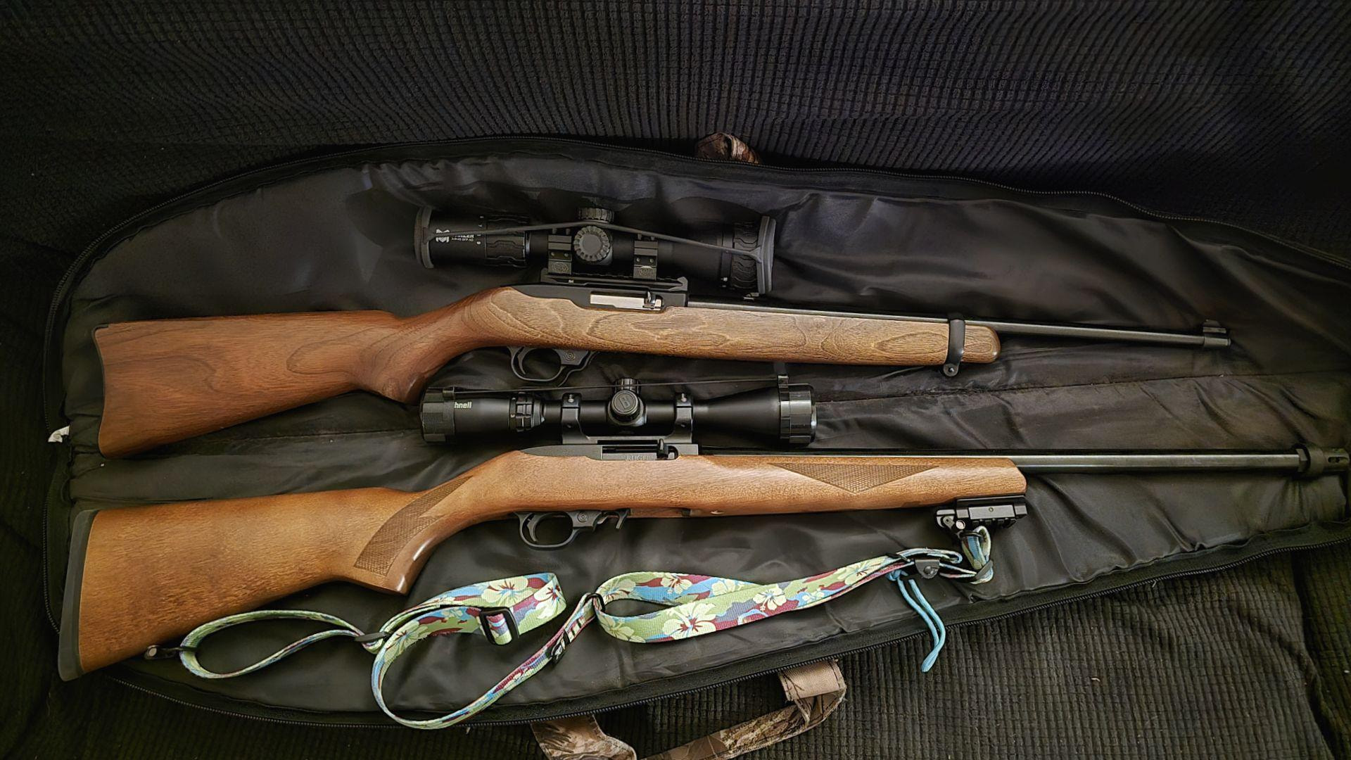

The vintage 1968 10/22 18” on top, the 2025 10/22 LVT TALO 20” on bottom.
Basically from what I understand the 10/22 LVT TALO was an exclusive configuration where they used a tapered medium-heavy bore (0.93” down to 0.75”) that’s 20 inches and threaded. As well as having a solid wood stock with some checkering decor. And I was curious how such a barrel would compare to my standard vintage one.

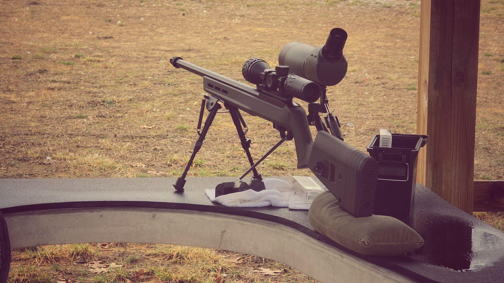

So this is the set up
  • I moved over my Monstrum 3-9x40 AO scope, with a extended rail with bubble level over to his.

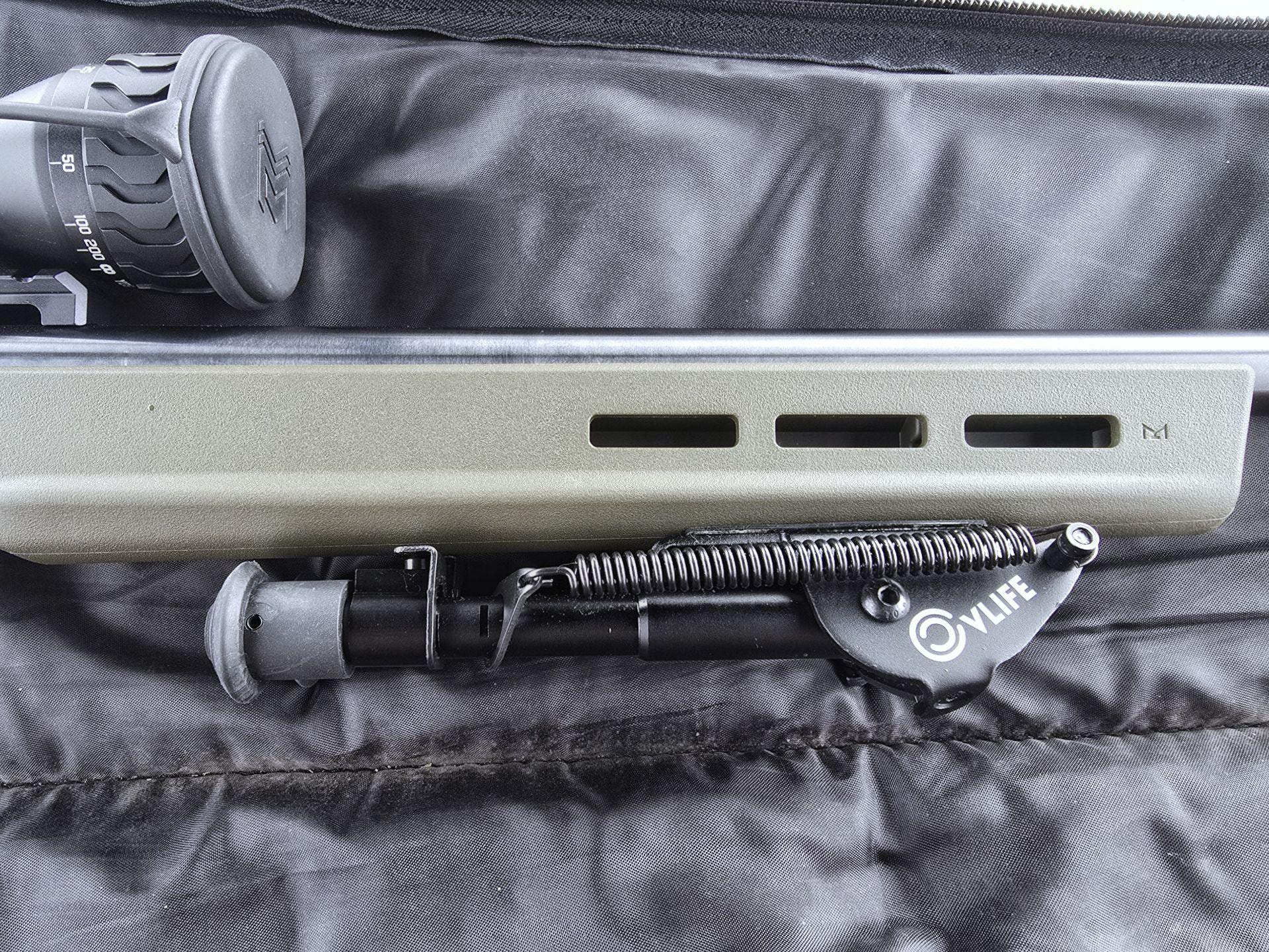

  • Took off the wood (walnut?) stock and put on a Magpul X-22 Hunter
  • Added an inexpensive MLOK bipod (didn’t have anything to tap in a swivel nut)

Yeah, I was thinking maybe dedicating that to bench rest and seeing just how accurate it could be. What distance were those targets?

Just 25 yards on those, I had just zero’d indoor a couple days before, and few folks took up all the 50 yard lanes when I got there (they were playing battleship) and I was just reconfirming everything, was also windy today.
