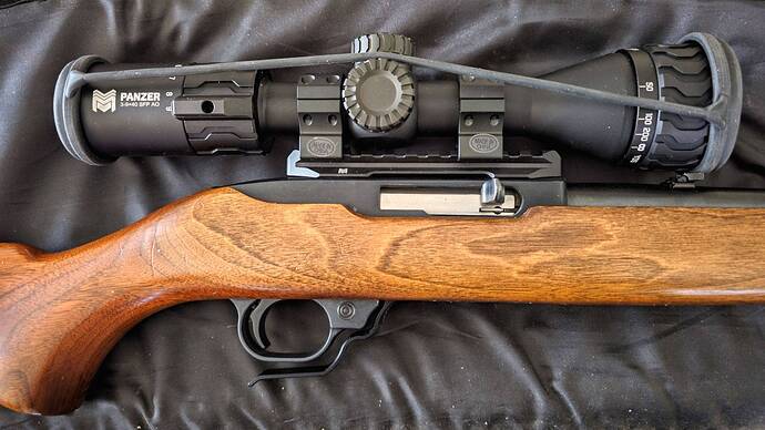

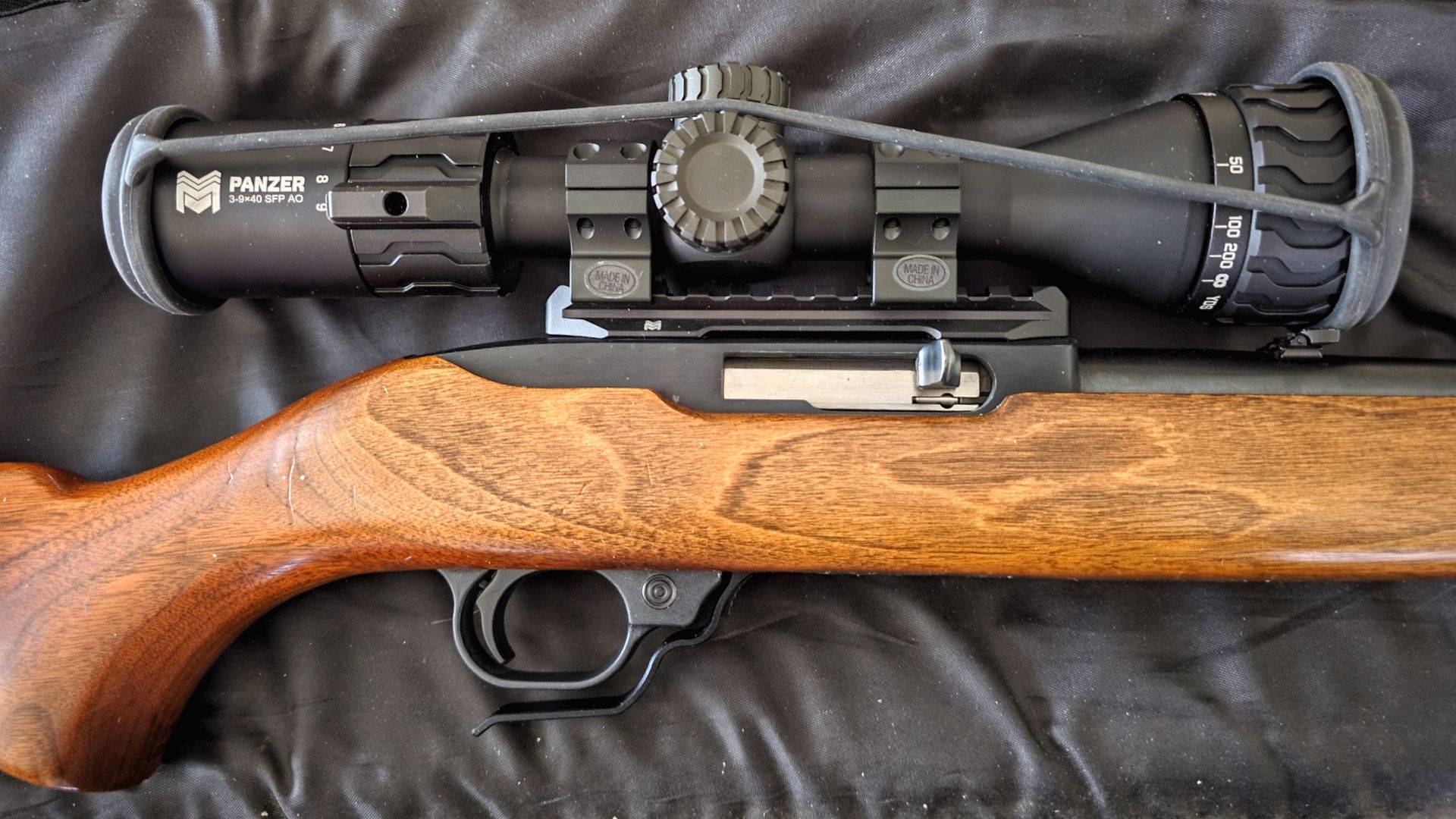

Definitely a Modern + Vintage mix look going on with my 1968 Ruger 10/22 (of which I put in an extended mag release, auto bolt release, and Monstrum fitted rail).
Decided to get an inexpensive scope (about 44 USD) that is a Monstrum Panzer 3-9x40 MPVO with Adjustable Objective lens which does from little less than 15 yard up to 200 yard then infinity to allow for the target to be focused with the reticle, rather than a blurry mess for closer target with ones fixed at 100 yards. I set up it’s positioning at home and made sure I had a clear coverage at both 3X and 9X before I headed to the range.

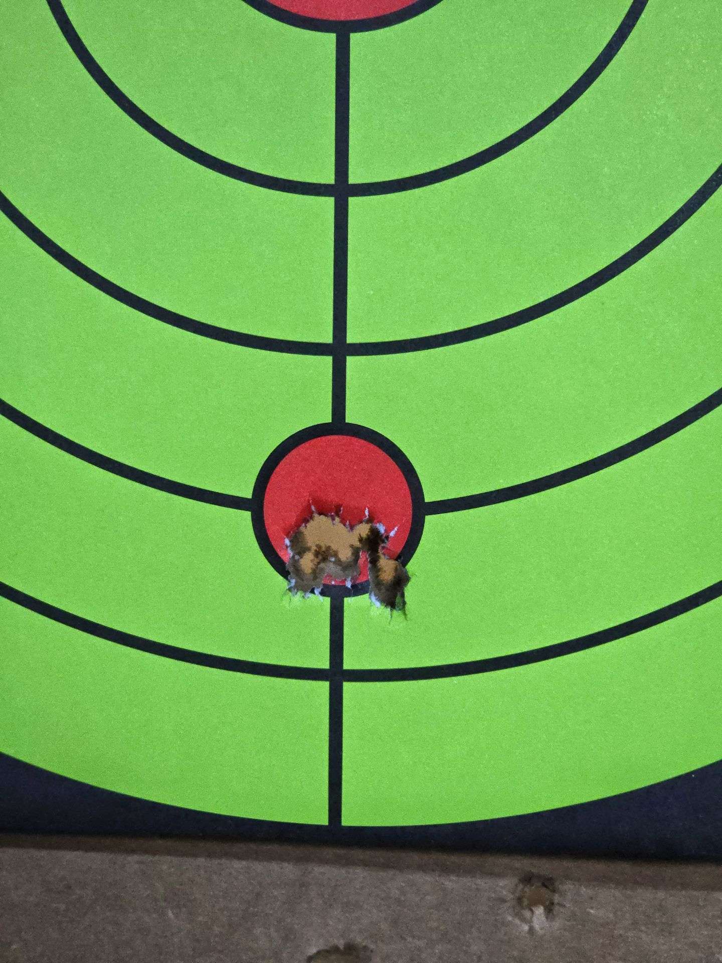

The close up here is with the Aguila .22 Super Extra 40 grain copper plated round nose that I wiped down the night before from the bulk 500 box.
It’s 10 rounds at 20 yards and the red circle is 1 inch.

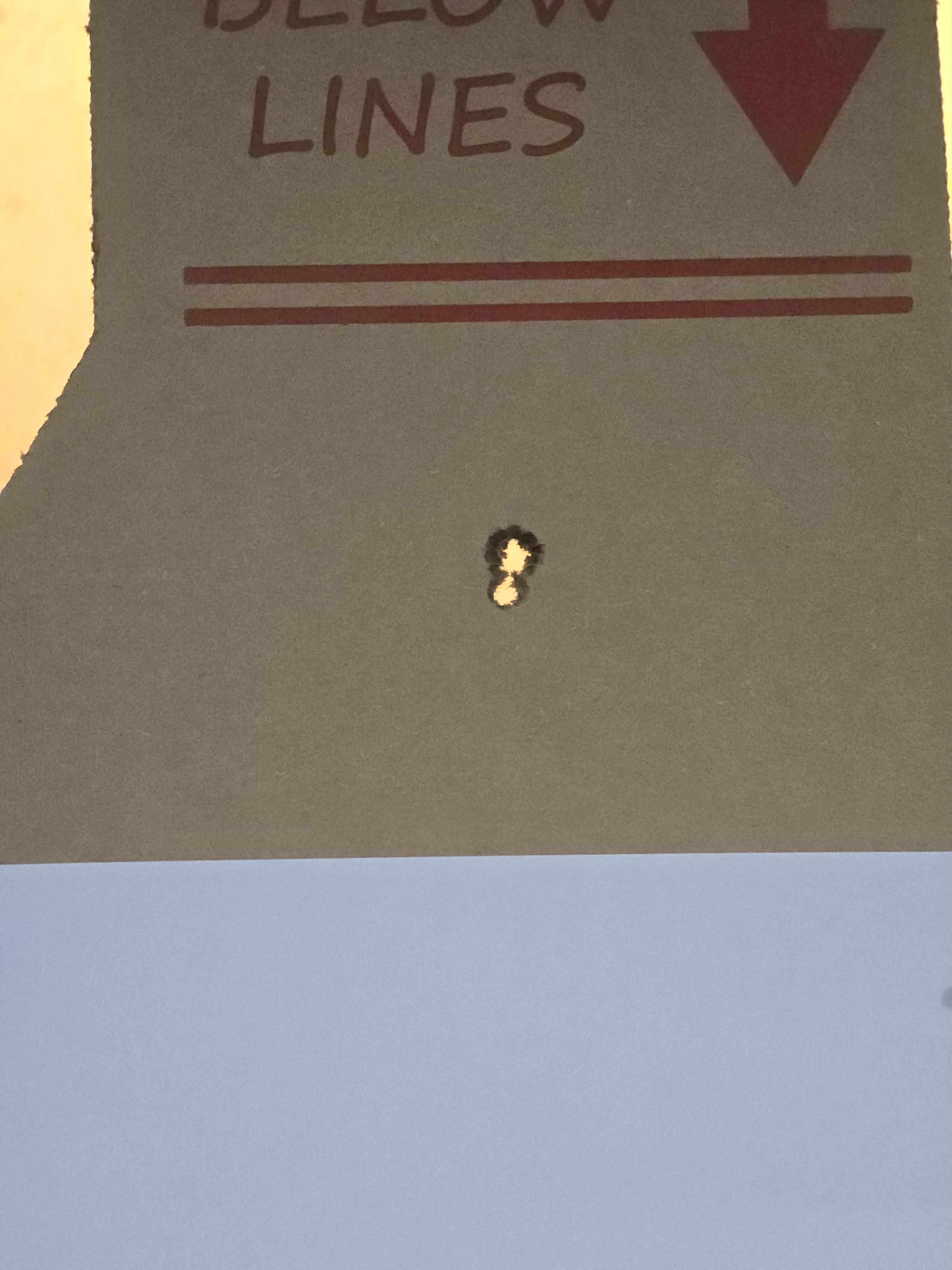

And just for shits and giggles, the final round of the night, I aimed a little below the pre-existing hole (probably 9mm?) on the cardboard at 20 yards and got lucky putting a hole right next to it.

Got some new scope rings for it, this time 0.8” center height, it doesn’t allow for me to bring it back as far as reversing the cantilever mount, but it does bring it down much closer to the bore.
So it’s a little more natural lining up my eye to the stock.
