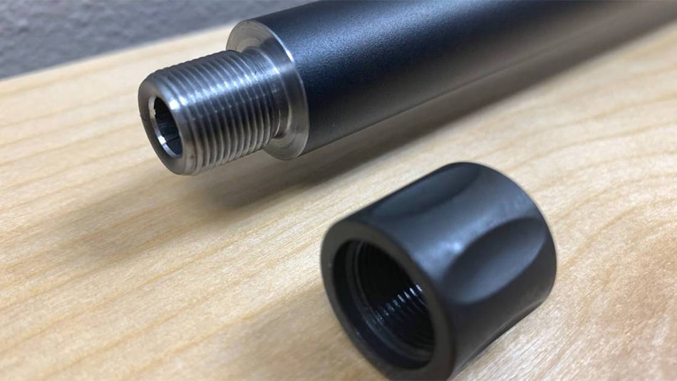

As for your barrel not being threaded, most competent gunsmiths will be able to cut muzzle threads if they own a lathe. Had the 16" barrel on one of my R700s turned a few months ago. works flawlessly. Most only charge $75-100 as well, making it typically a cheaper option than opting to just replace the barrel
Usually, most american .45 cal barrels are threaded 5/8x24, but id advise checking that before just trying to jam a muzzle device on it. messing the threads up has consequences that typically involve a lathe lol
Thanks for the info. Actually, both guns have threaded barrels, its that the muzzle brakes themselves do not have threads on the outside. I know they make adapters that one can get and they’re not expensive. Biggest problem is with the 50 beowulf, although a silencer does exist, very hard to come by. Thank you very much for the info and link for the bushmaster though, mine is actuslly threaded 5/8x32.
