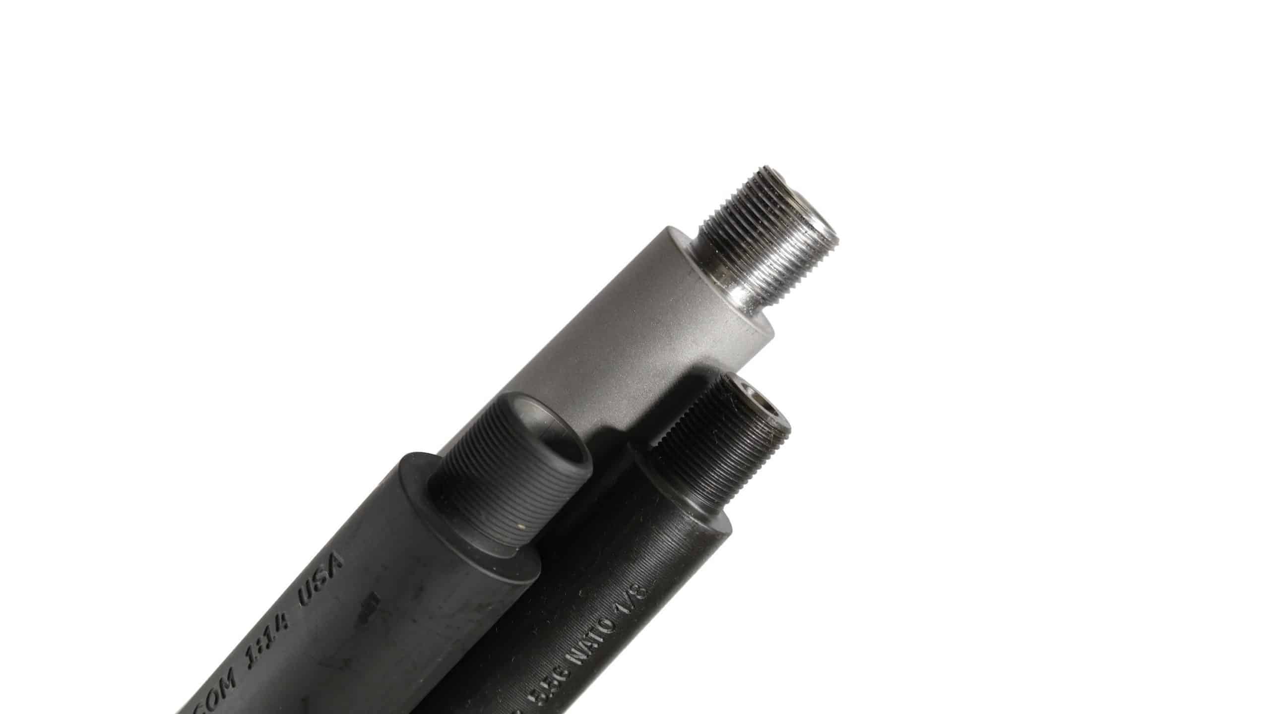

And also when you’re looking at different muzzle breaks/flash hiders you have to figure out what thread pitch your barrel is. I have no idea what the saints thread pitch is and how you would figure that out?
Yes, tax stamp, yes you wait. My average wait time is about a year, and you plop down your money before you apply for your stamp, so you have all that money out there and nothing for a year. As for muzzle devices, every brand requires a different muzzle device. The nice thing is that most suppressors come with an appropriate muzzle device. So all you have to do is make sure you order the right thread pitch, but luckily most thread pitches are standard for the bore size.

If you are going through the process and pain of getting a suppressor it would serve you well to have the BORE and the muzzle THREADS aligned. It will serve you no good service to screw on a can and have the first round be a baffle strike because the muzzle threads were not concentric with the bore. It is a simple task for a gunsmith with a lathe to index the bore with the threads and may or may not require cutting but the effort is worth it. In general AR-15 muzzle threads are 1/2" x 28 TPI but there is no telling how those threads were put there or if the bore is concentric with the OD of the barrel. At worst it will cost you a new tube if things are really out of whack.
As far as muzzle brakes that go with various suppressors to effect a QD (Quick Disconnect) attachment they are all proprietary. I prefer SureFire cans and attachments but even they will unscrew given sufficient beating. Yes I have shot more than one can off the front of a rifle, thank you tax payers.
The only reason I would not check the muzzle threads vs bore alignment is if I was using an over size can with a thread adapter, say a 1/2" x 28 TPI to a 5/8" x 24 TPI for a 30 cal rifle on an AR. YES you can use a 30 cal can on a 5.56 to fair effect but NOT the other way around.

@Craig6 I have noticed that pretty much every 5.56 is 1/2 x 28 and haven’t really came across anything else. I’ve checked most forums and for my AR it seems like I fall into that category as well. I have been looking at the SilencerCo Saker 556K ASR and it comes with both the can and flash hider but there are so many I like. The Trash Panda by Q is another one so I guess it’s just preference at this point. I have a local gun shop that I will probably end up having them do the work instead of buying shims and whatnot and going through the process myself the first time.
@bmurphy315 I won’t tell you what can to buy nor will I make a recommendation beyond what I have stated . 1/2" x 28TPI is the standard for a 5.56 am I would be rather surprised to find a production gun without it unless it is an off caliber platform like 6.8 SPC, 7.62x39 or 300 Blackout or some such. My point is simply that a bore check is worth the pain and inconvenience to ensure that you don’t get a baffle strike on the first round or the 5000’th round. Nothing quite like holding a $200 tax stamped $800 paper weight in your hand for the lack of $100 in one time insurance. Tolerances stack and if they stack against you it will end badly. It has been a long time since I did the math but I want to say 0.002" out of concentricity from bore to threads would net a baffle or can strike with a 7" can with only a little wiggle room for heat droop. Since you have a SA Saint you may want to call them up and ask if teir tube is “suppressor certified” if the knuckle head on the phone says “You can certainly screw a suppressor with the proper threads on…” ask for a supervisor or tech and let them quote you page and verse about concentricity of the bore to the threading on the muzzle. I wouldn’t be surprised if they asked you to send it back for a check, and I would.

It is my understanding all 556/223 barrels are 1/2x28.
