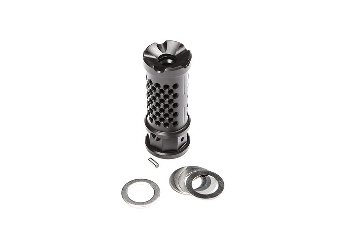

The pinned and welded device is something you don’t want so the weld just needs to be ground away so the pin can be dug out. Unscrew the old one. Then spin on your new favorite flash hider with a new crush washer. If the barrel isn’t 16” minimum then the new device has to be pinned and welded to satisfy the length requirement. Otherwise it’s a short barrel rifle. Edited to add the length of the new flash hider you select needs to get you to 16” minimum and then pinned and welded. If your barrel is 16” without the muzzle device it doesn’t need to be pinned and welded.

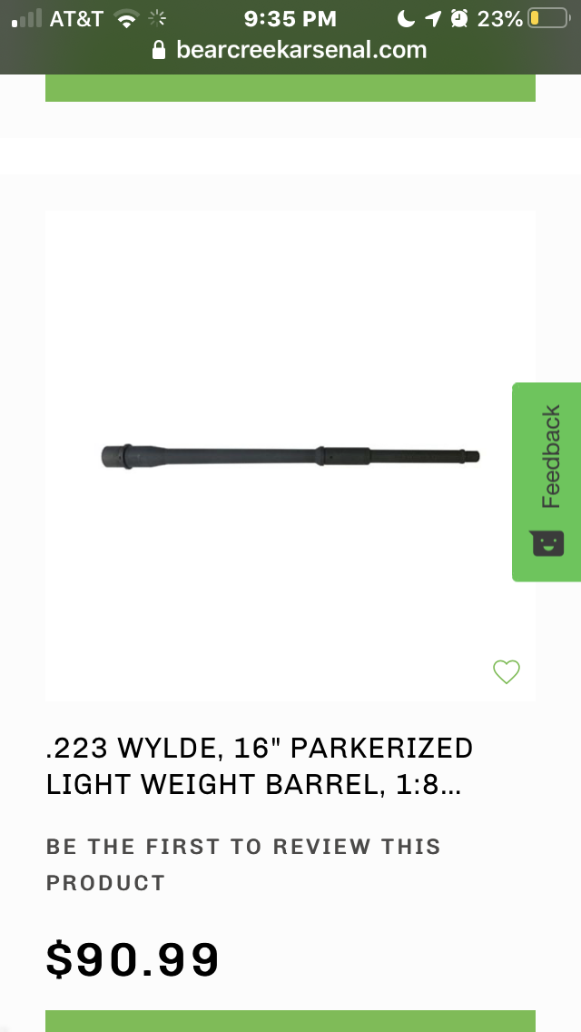

If you just enjoy pulling the trigger Bear Creek Arsenal makes inexpensive barrels. They do have a warranty but I stopped buying from them. After needing to return about three barrels in a row for not meeting the 1 moa guarantee I went to the other extreme and paid more up front.

My home defense AR comes from Spike’s Tactical with a 14.5 inch barrel. It has a recoil reducing cage thing on it that flashes very brightly indoors. I am looking for a flash hider that I can hopefully put a suppressor on top of. That said, if there is a suppressor that is made to put on the one I’ve got, a new barrel becomes moot.

Also, be clear when talking to a gunsmith or shop, there is a difficulty difference between swapping muzzle devices that are simply threaded/locktite/rockset on, and removing a “permanently attached” pin and weld device. As you say, it is definitely possible to end up kind of ruining the barrel.

Since you stated the purpose of this firearm was for home defense a budget barrel would be more than adequate. You could shave some weight with this one and reach 16” without having to make sure that a suppressor compatable device added 1.5+ inches after installing it and then having it pinned and welded.
