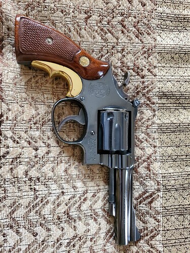

They have been playing around on recoil for along time point in case my Smith and Wesson model 15 Combat Masterpiece has in 38 special has a brass finger inserted wear your fingers wrap around by the trigger it adds weight to the gun to help control recoil.
hope my jpg works
