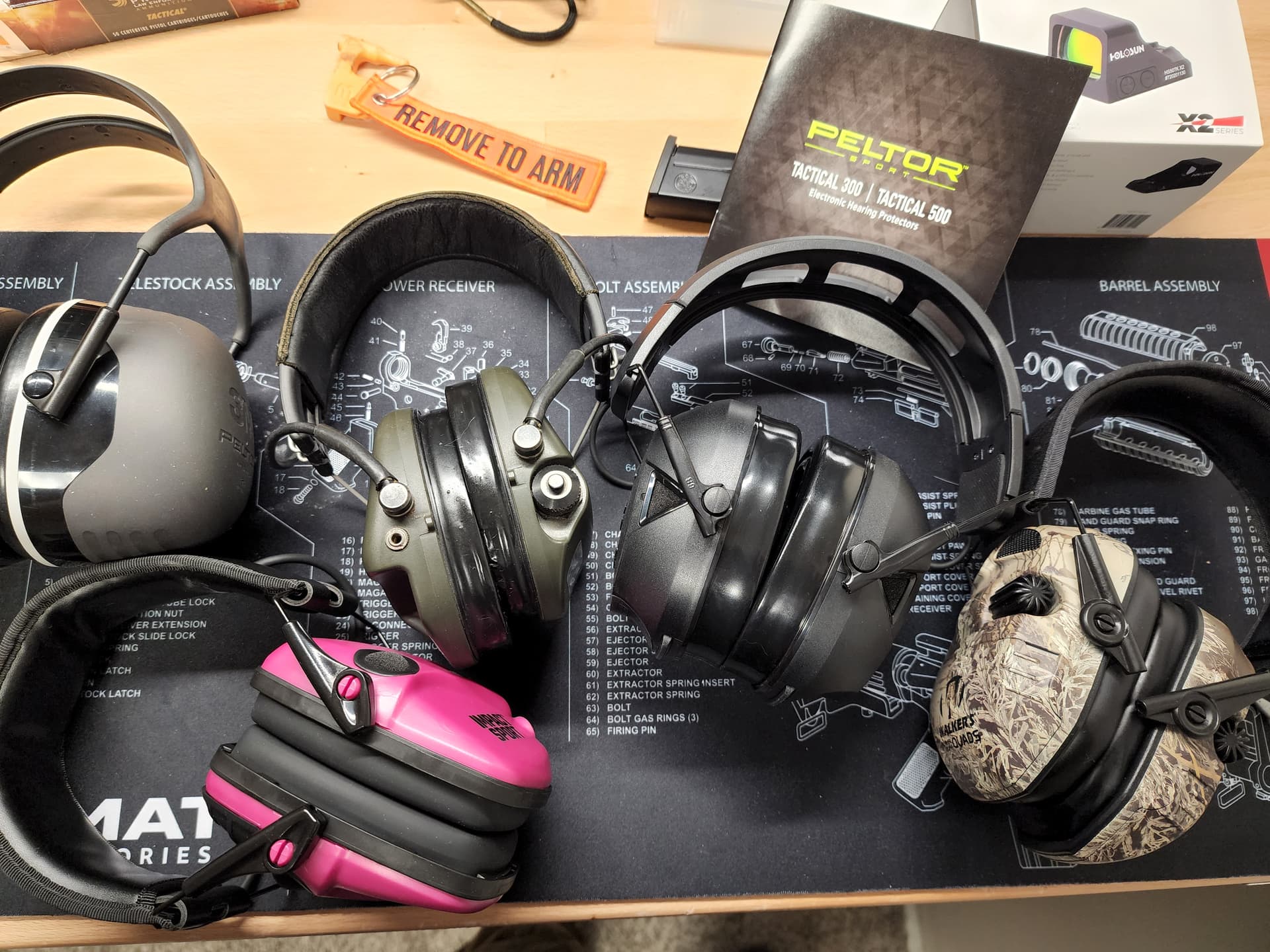

FWIW, here are some of my earmuffs. So far, my favorite electronic earmuffs are the Peltor Tac 500 with the gel earcups
NRR of 26 with outstanding fit/comfort/seal with that gel, and not too bulky. I still put them over plugs around rifles indoors every time.
The huge ones on the left are NRR of 31. When you want all you can get, they are it.
