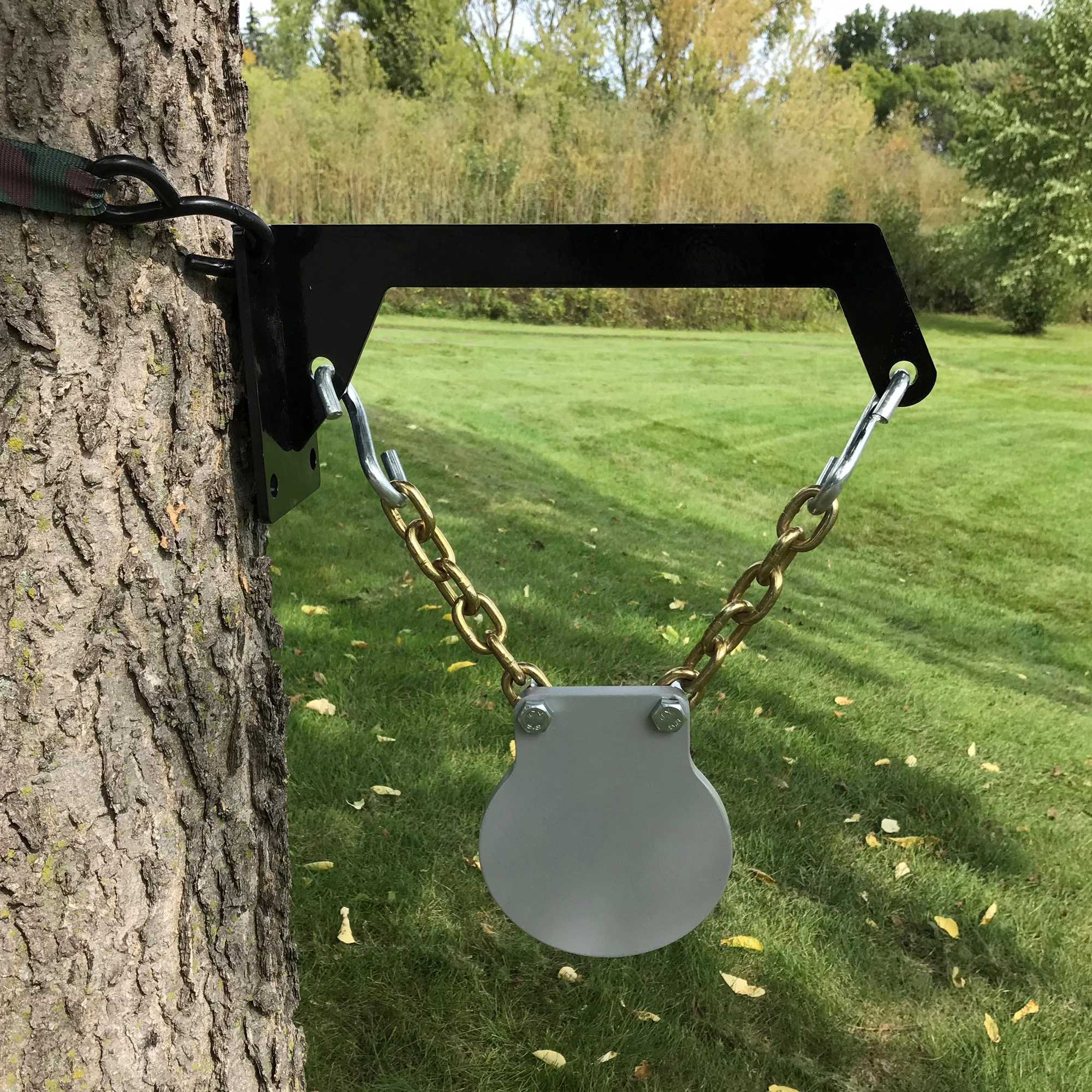

The other piece I forgot to mention is target mounting. It seems like there are stakes with hooks on the top, things that look like small swing sets with targets hanging from chains, and bases that allow items to spring back. We’d want to leave it all in place, so what makes sense?

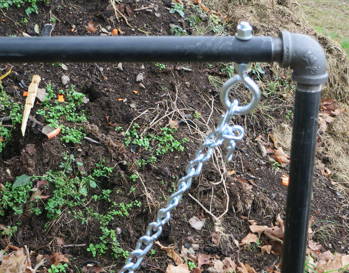

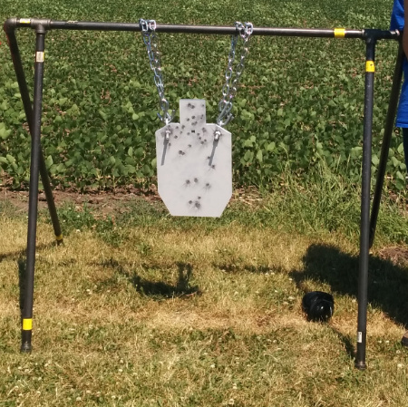

Steel Targets: YES!!! Those do look like good prices for 1/2" AR500. If this is going to be a permanent fixture invest in some “Black Pipe” or rigid EMT conduit from the hardware store. That failing 2X4’s and “Saw Horse” joints will take you a long way but they will degrade over time and WILL sustain FRAG damage from shooting steel. ALWAYS wear gloves when handling them. Grade 78 Truckers Chain from Harbor Freight and Snap Link’s are your friends.

Great advice on the chain set.

@Brad so if you are just doing it to 200’ for pistol and carbine you don’t have to get all hog wild about your steel stand structures. Rigid EMT would probably work well for you and there is a company I am familiar with that has just about every “joint” you can imagine to make assembly that much easier.
They make them in various pipe sizes and are just WAAAYYYY easier than trying to figure out what to do with 90* standard fittings. Think swing set and let your imagination run wild.
I will tell you with an 8" x 8" x 1/2" AR 500 plate it’s probably going to weigh 20+ lbs so it’s not going to move or dance much even with a 357Mag. Most of my stuff is 12" X 16" X 3/8" and weighs north of 30lbs and I have shot them with a 408AI (BIG Frikkin’ Rifle round) at 35 yards and not a dent even with lathe turned solids. That said shooting them with M855 (5.56 Green Tip/Tungsten penetrator) will leave a dimple out to 200 yards. I did shoot my 18"x24" plate with a 50BMG running Black Tip (Armor Piercing) by mistake once but it was at 1770 yards so no damage there. AR500 is the only way to go and with those prices stay with 1/2" and you can zero your 300WM hunting rifle and not worry. OH one bit about steel, PAINT it, A LOT. The cheap Rustoleum white paint is the best. Bring a new can with you for every trip because if you try and use the stuff from the last trip it won’t spray. Also if it’s COLD don’t try and paint unless the can is warm, it will freeze the paint in the nozzle.

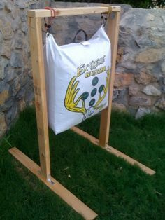

You may or may not be interested in any of my ideas, but I have some that I’m going to use myself that’ll work just fine for me. I have a natural earth backstop in my woods that I use for shooting, and have plans for some basic upgrades that will add some function and comfort. I’m going to take down some strategically located saplings for two purposes: 1- as a stool base onto which I will screw 2" thick wood slices at stool height for seating, and 2- as table legs onto which I’ll screw long boards at table height. If I need extra table legs, I’ll have some sapling posts, and can burn the in-ground length to treat it, and will finish up with some marine grade urethane on all the wood surfacing to help protect it. I have a cured tree conveniently down in my spot, from which to source the wood I need. As I’m repurposing all the materials I can, I have a few shepherd’s hook plant hangers placed about for clipping up targets, and intend to cut a few extra thick wood slices to set up as targets too, and there are always cans, water bottles, and such. Like I said, keeping it simple, but I’m open to ideas as well. Good luck with your range, @Brad.

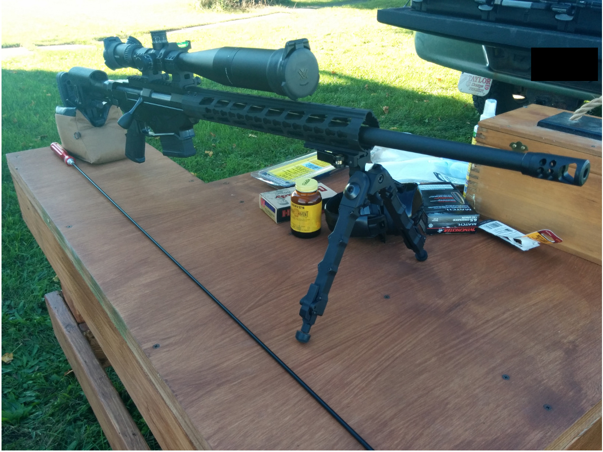

I built a bench similar in design to the one in the video, I built the right hand model. I ended up replacing the top with a double layer of plywood to get a smooth surface. The grooves created by the lumber always seemed to be catching something or causing some issue that a smooth surface addressed. I wished I had made some over lap on one side of the top to cut notches to hold shotguns while we shoot clay pigeons. I also took the boards that frame in the bottom and moving them up a few inches. My bench is not on a level surface like concrete and the framed in bottom made it wobble. Moving the bottom frame boards up a few inches allowed the weight of the bench to settle the legs in to the ground and provide a stable bench. I would also round over the corners with a router before I stained my bench if I had it to do over again.
I like black gas pipe for target stands. It is easy to replace damaged parts, it breaks down, and it can be configured into different configurations with the same basic parts. Trailer hitch safety chains make good hangers for steel targets and a sheet of cardboard can be attached to the frame to put .22 targets on.
Thanks you, guys. I like a lot of these ideas. Is there an easy way to seal the plywood? I had the same question about the top made of individual boards.
I just used Thompsons Water Seal for decks. The ‘turd’ brown color must not have been very popular because it was on sale for $3 for a gallon. I move my bench in and out of a old corn crib, so it is not constantly in direct weather but it is not completely protected from it either. The top is 4 years old and looks as good as the day I put it on… If your bench is going to be out all the time you may want to look at marine grade plywood or a water proof sub floor type maybe?
On plywood, if all the edges are straight you can use the Liquid nails and a 1" x 2" to act as an edge sealant. Curved edges will require “kerfing” the 1 x 2 so that it can bend and filling the “kerf’s” with the liquid nails.

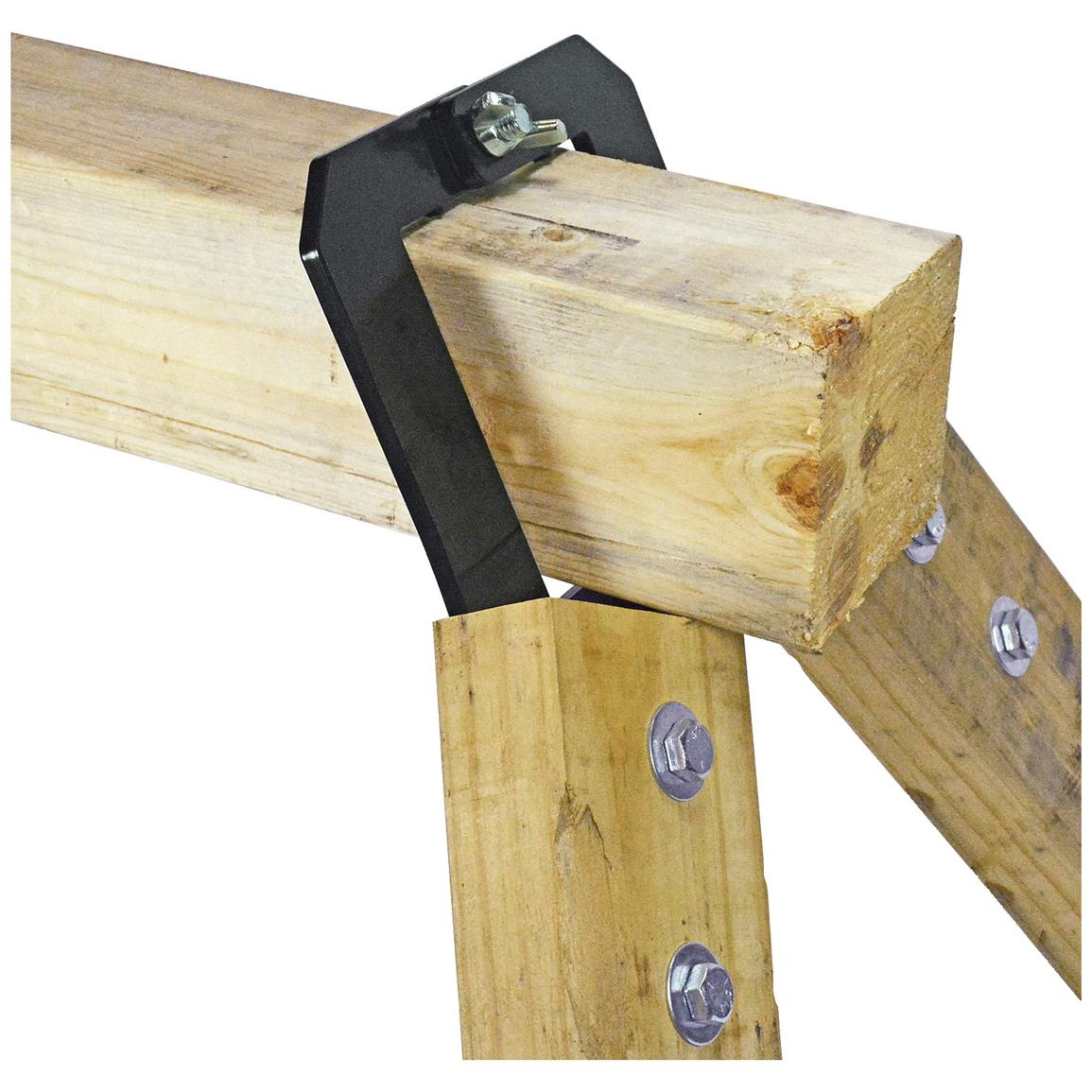

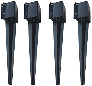

For hanging targets, are 4X4s needed or 2x4s? We’re thinking of putting up some upside down U-shapes to hang targets on chains from. The idea may be to use the items for mailboxes so that boards can be replaced easily as they rot/get shot. ~$15/each in bulk of 4+, or are they even necessary.
