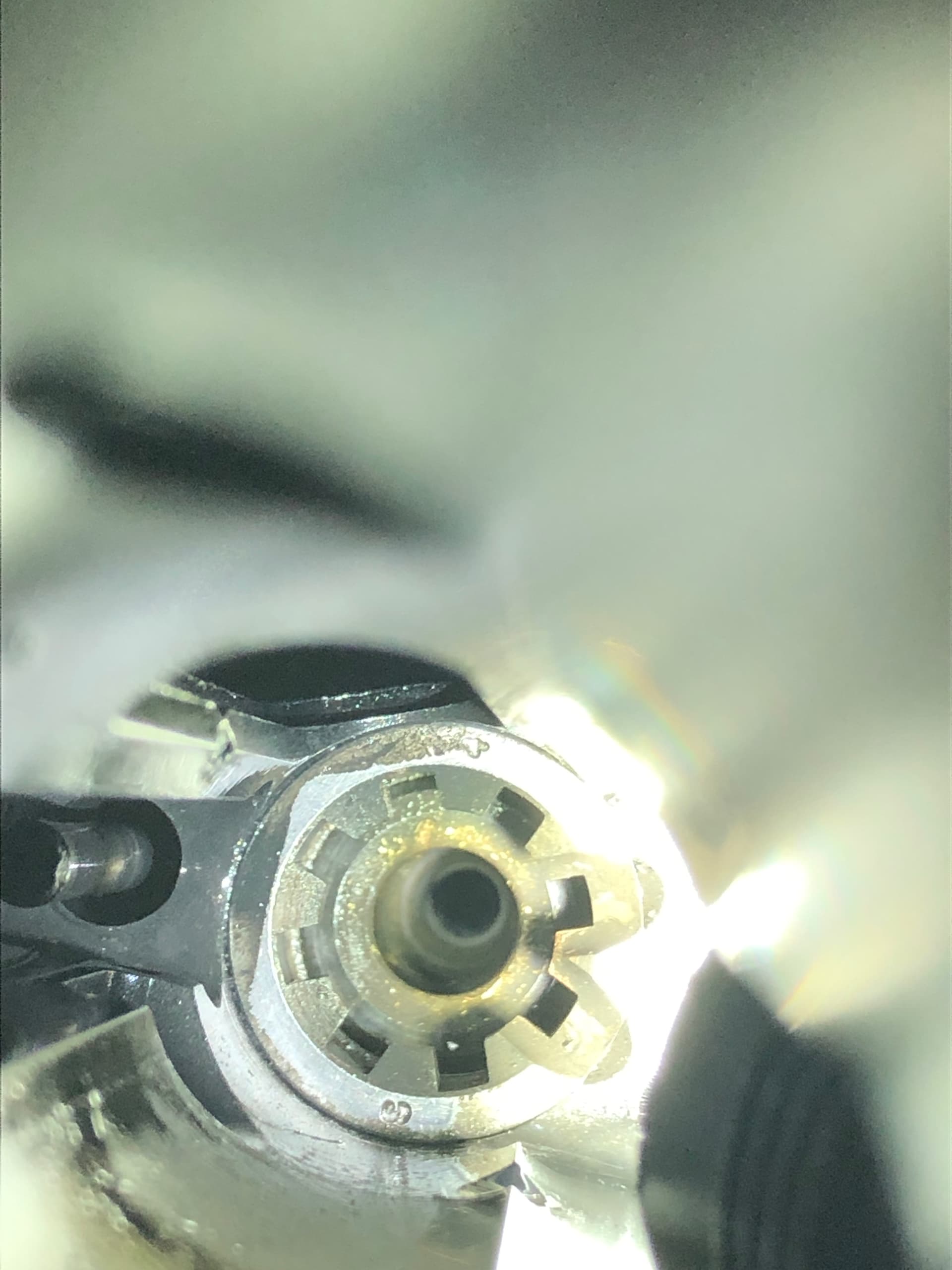

My money is betting on slightly out of spec ammunition. It’s close enough to chamber but hard extracting when not fired. Lots of brass flakes visible in the photos. Although, That could just be indicative of a carbine gas system set up to run anything it’s fed and still be reliable.

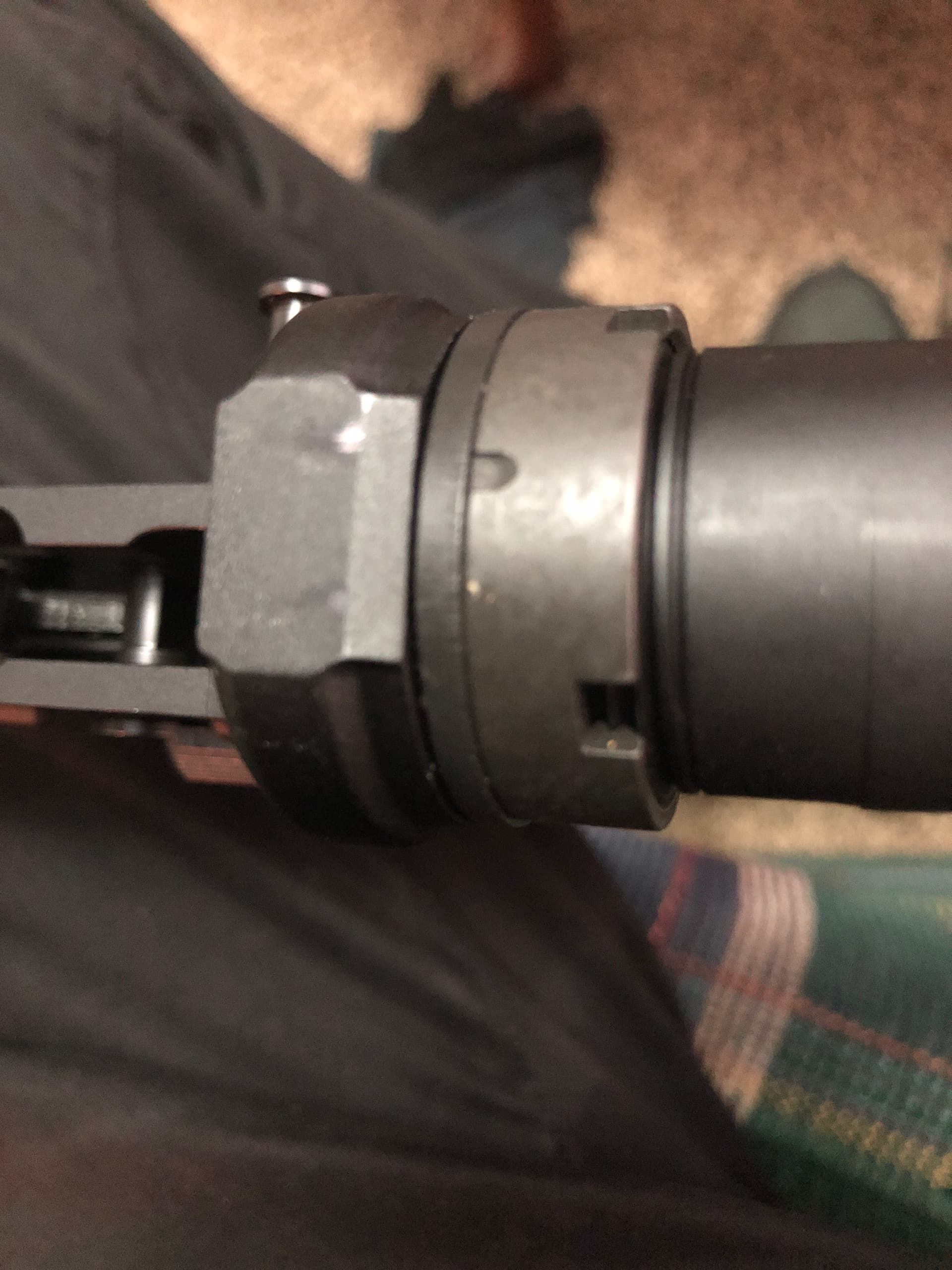

The only other thing besides all the others stated, I would check is the barrel nut, people have reported getting their APF brand new and the barrel but was loose.

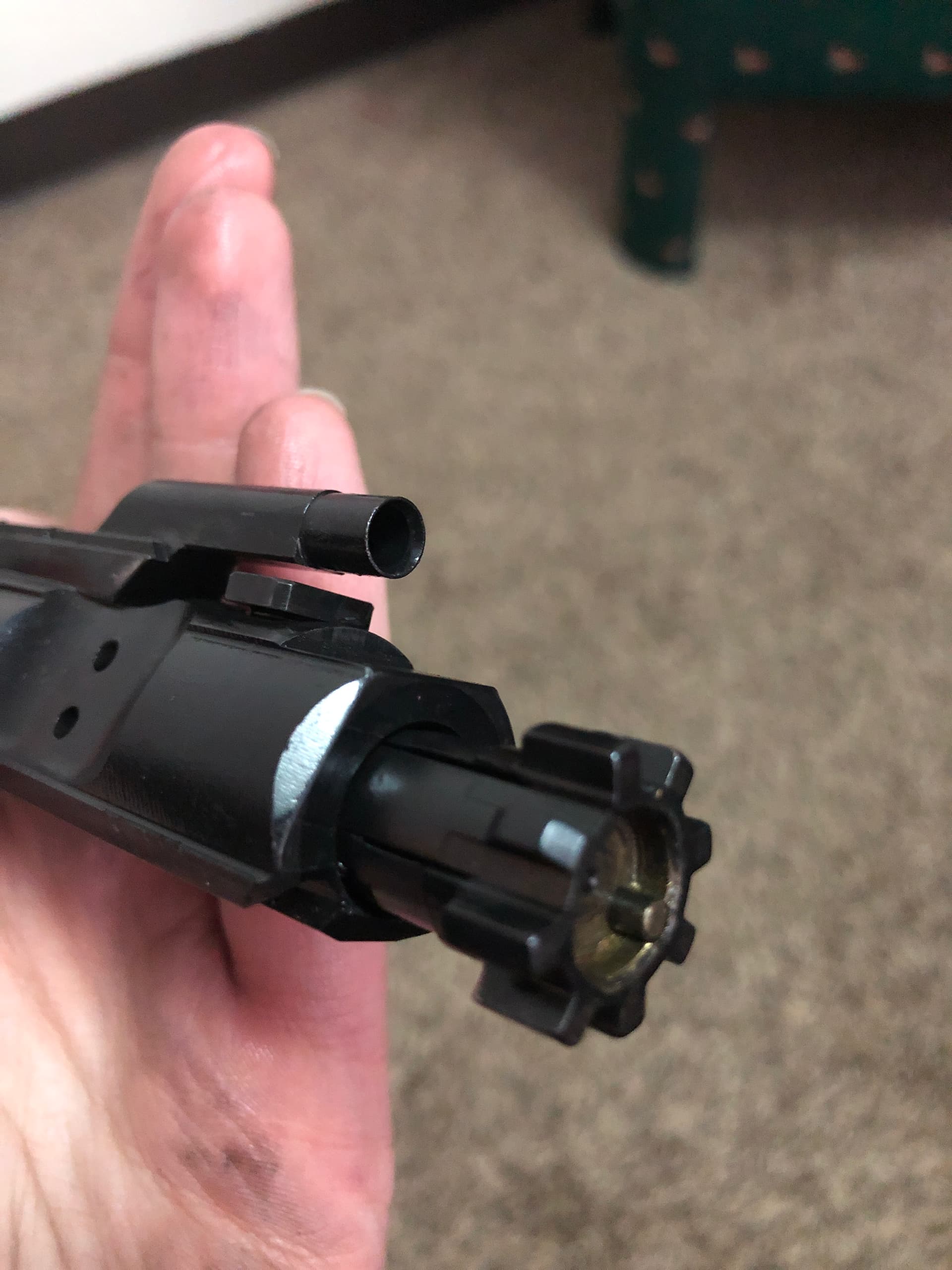

Charging handle looks good, bolt face needs work, but that wouldn’t cause a lockup.

How do I check that?
Remove the handguard, it’s the nut connecting the barrel to the upper receiver.

Another thing you might want to check, but it’s doubtful, is the gas key on the BCG lining up with the gas tub.
