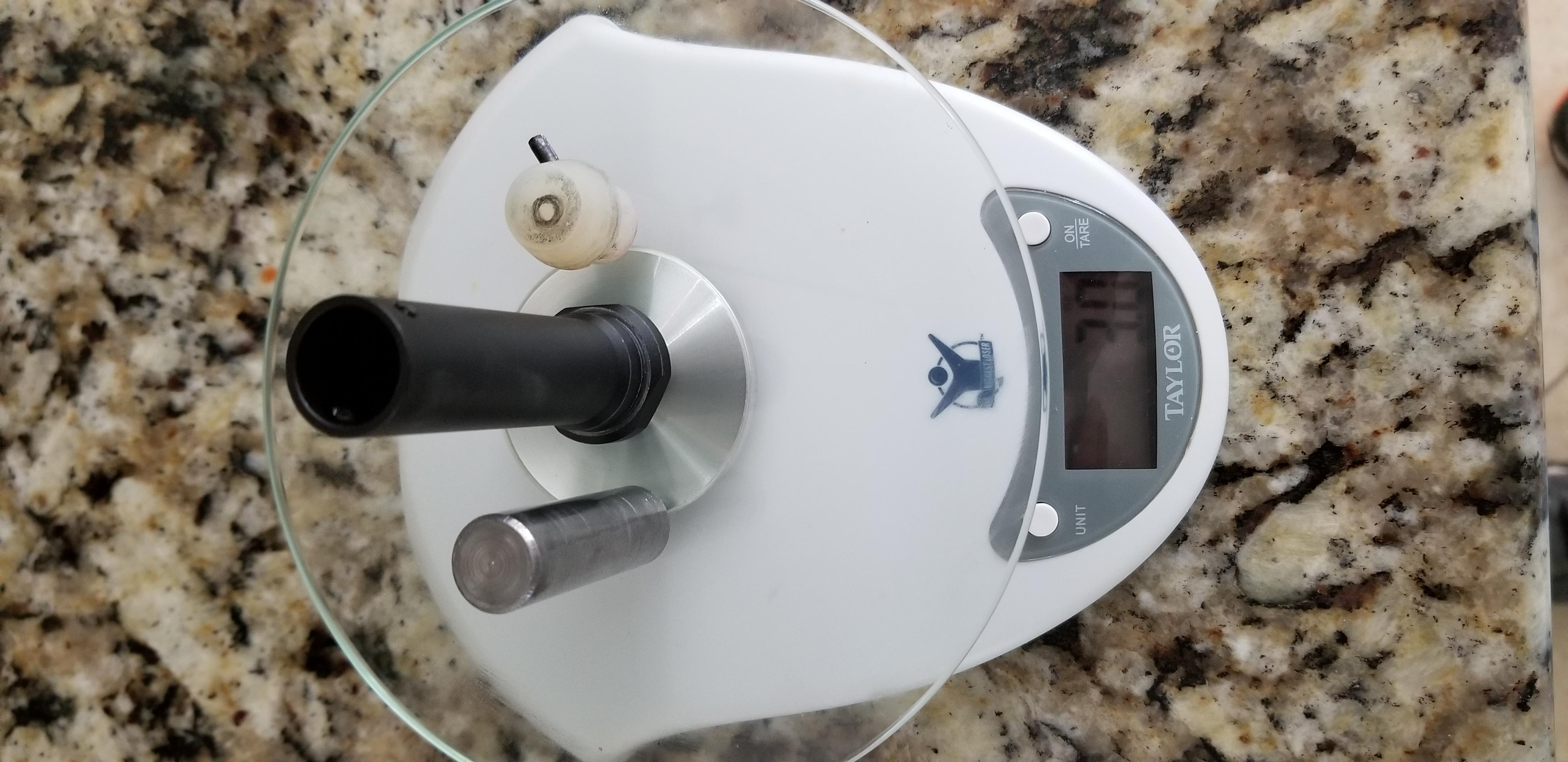

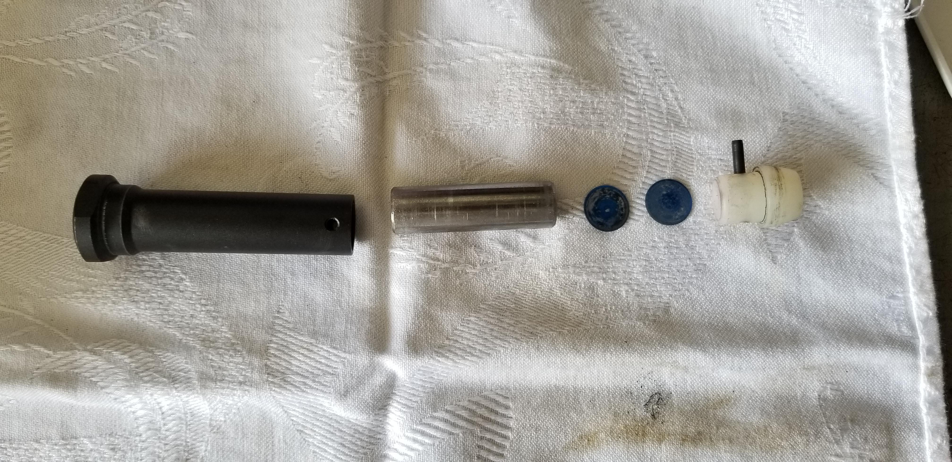

So, I took the current buffer apart to get ready to convert it to an H2 for first trial. What I found inside was not as expected:
I was expecting 3 steel weights with rubber spacers. The single weight is 2 ounces, and the whole assembly is 3 ounces:
So, will have to decide if I want to put together an H3 when the new weights arrive, or cut the 2 ounce weight to make the originally planned H2. The removed spacers appear to be 0.031" Aluminum, both stacked together on the plug end of the original assy. Will have to do some measuring of the new weights and figure out what spacers to scrounge together.

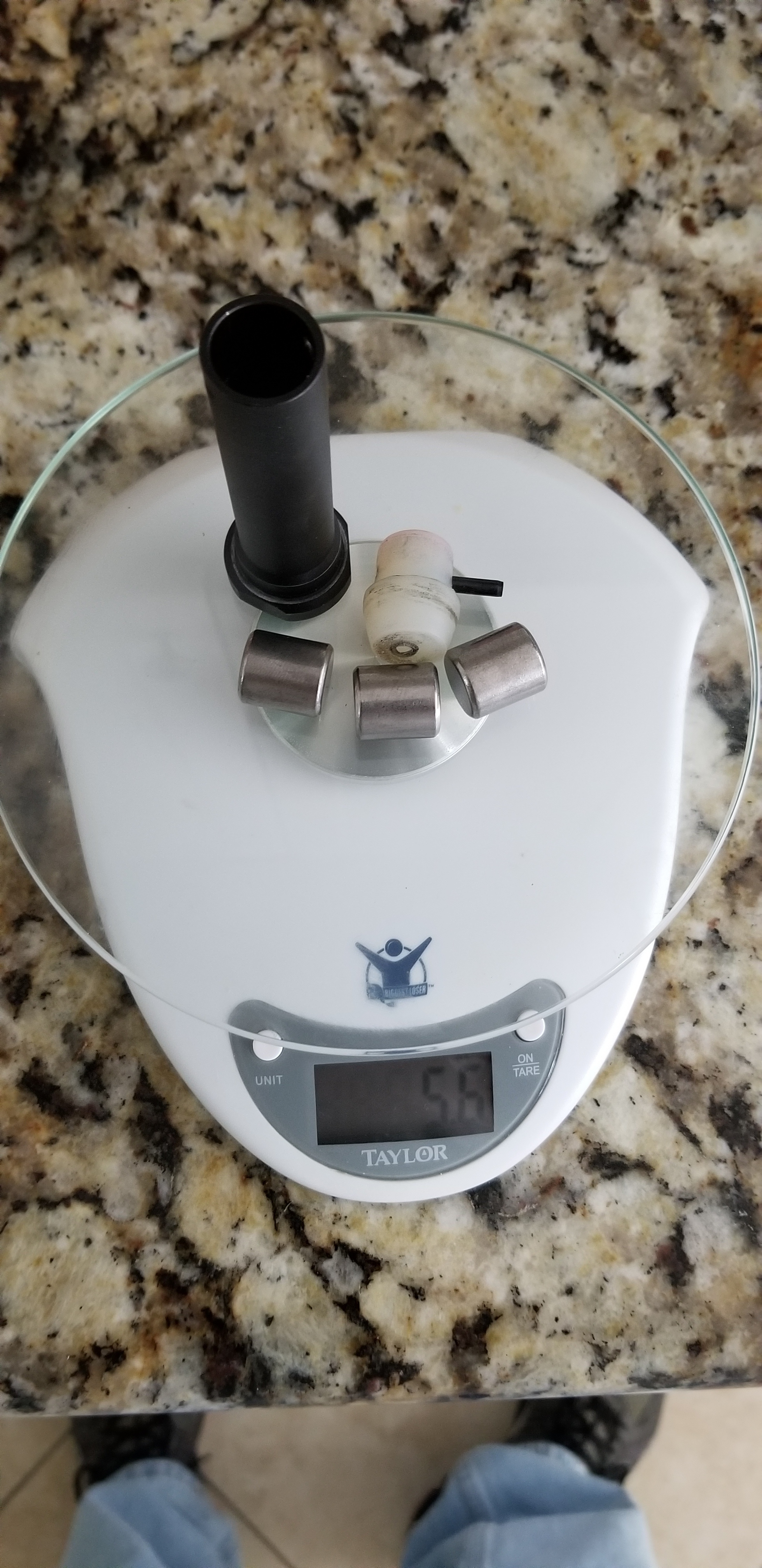

Turns out the spacers are 0.010 plastic. Putting in the 3 tungsten weights plus the 2 plastic spacers still rattled, so threw in a thin SS washer to tighten it up. It ended up almost 2x original weight @ 5.6 ounces:
Hope to try cycling on Wednesday, bolt catch still releases, but requires more aggressive jarring.
