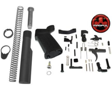

Here is a general idea of all of the little parts that go into the lower:

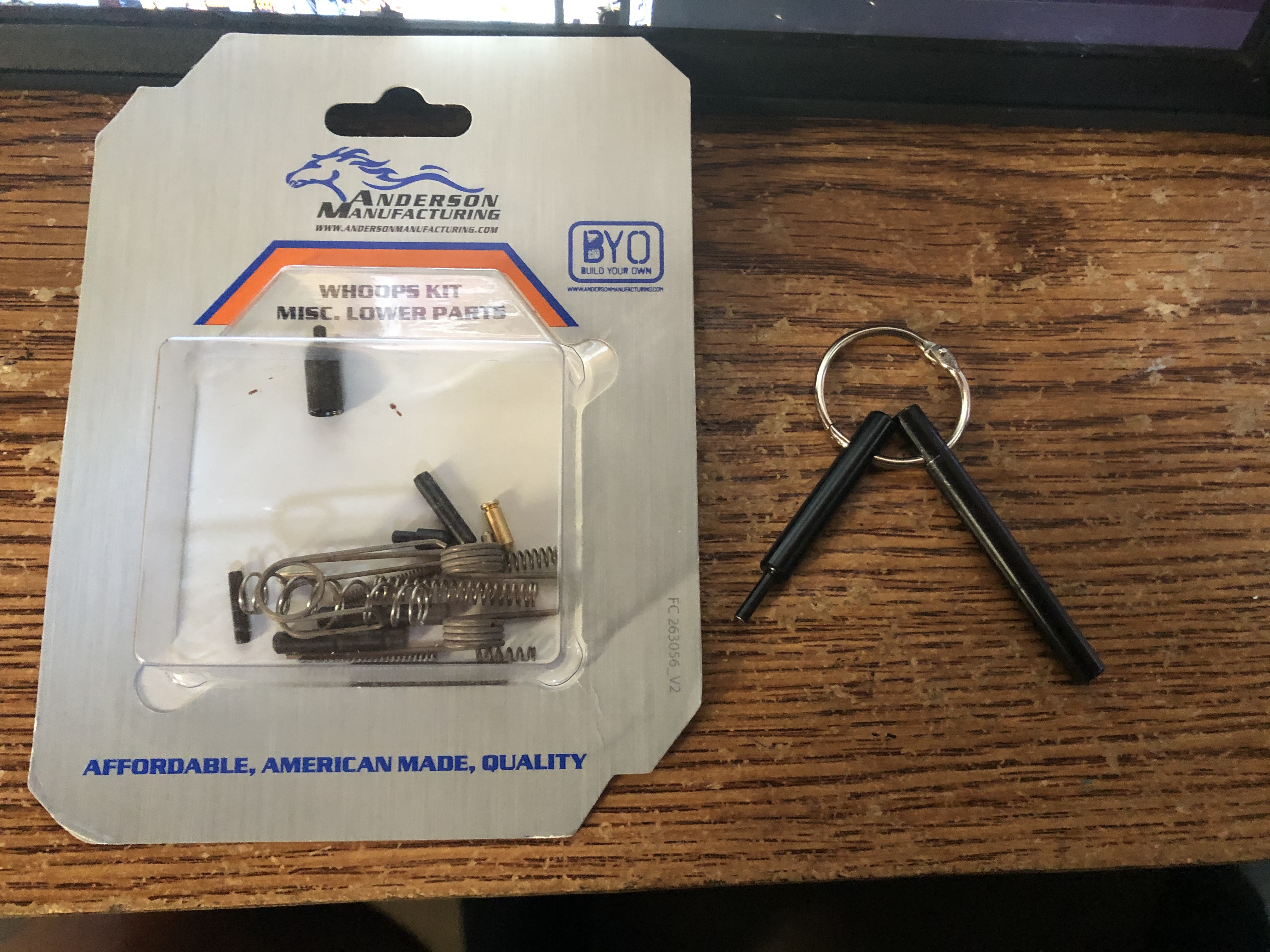

This detent tool on the right for the pivot pin is your best friend. I also keep a few of the whoops kits that has parts that might take flight or springs that could break in the fcg.

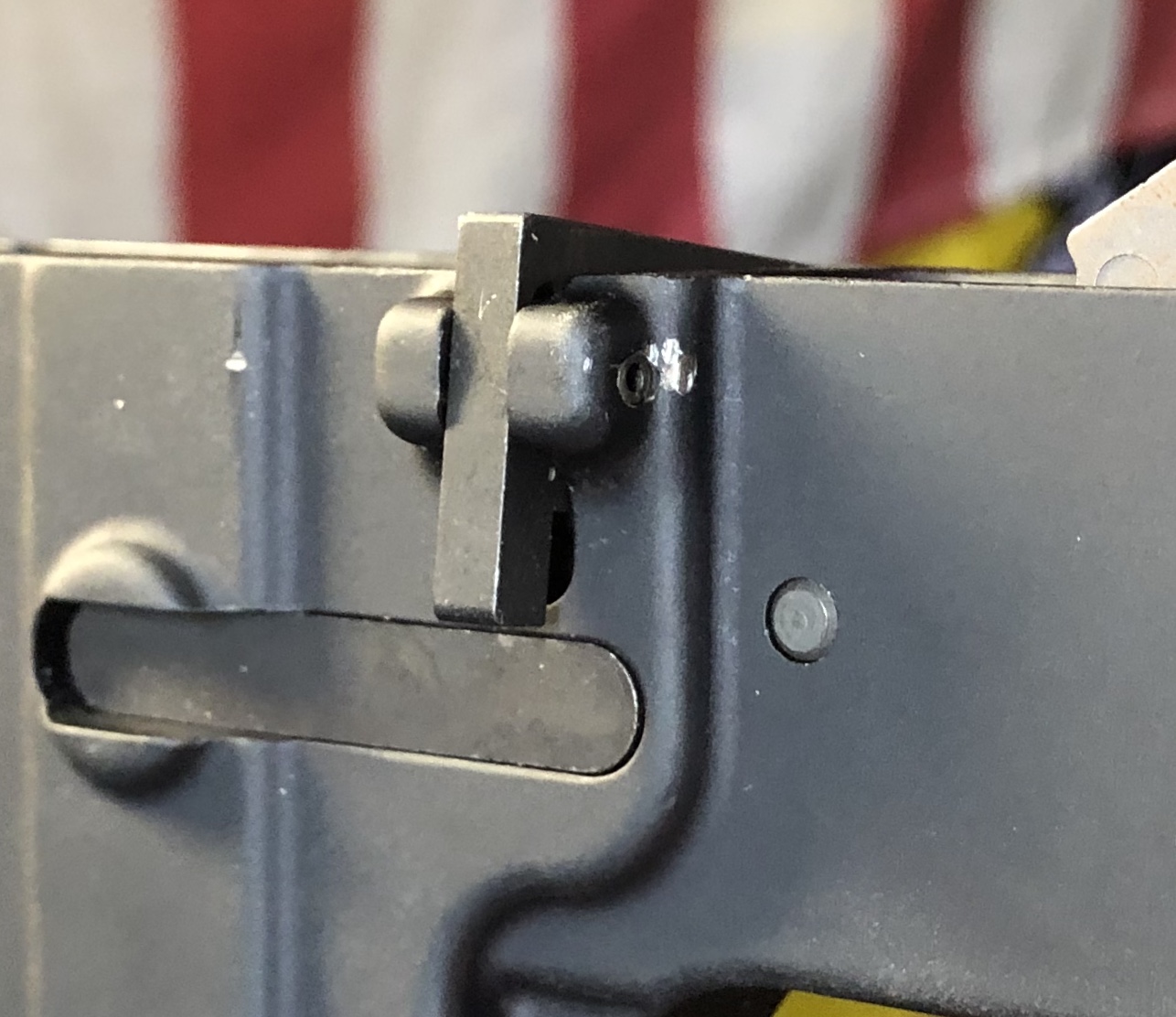

The roll pin that goes into the bolt catch I heard from some is tricky. I’ve found no problem installing or removing it with a punch set aside from marking/removing the anodized finished. Easy touch up.

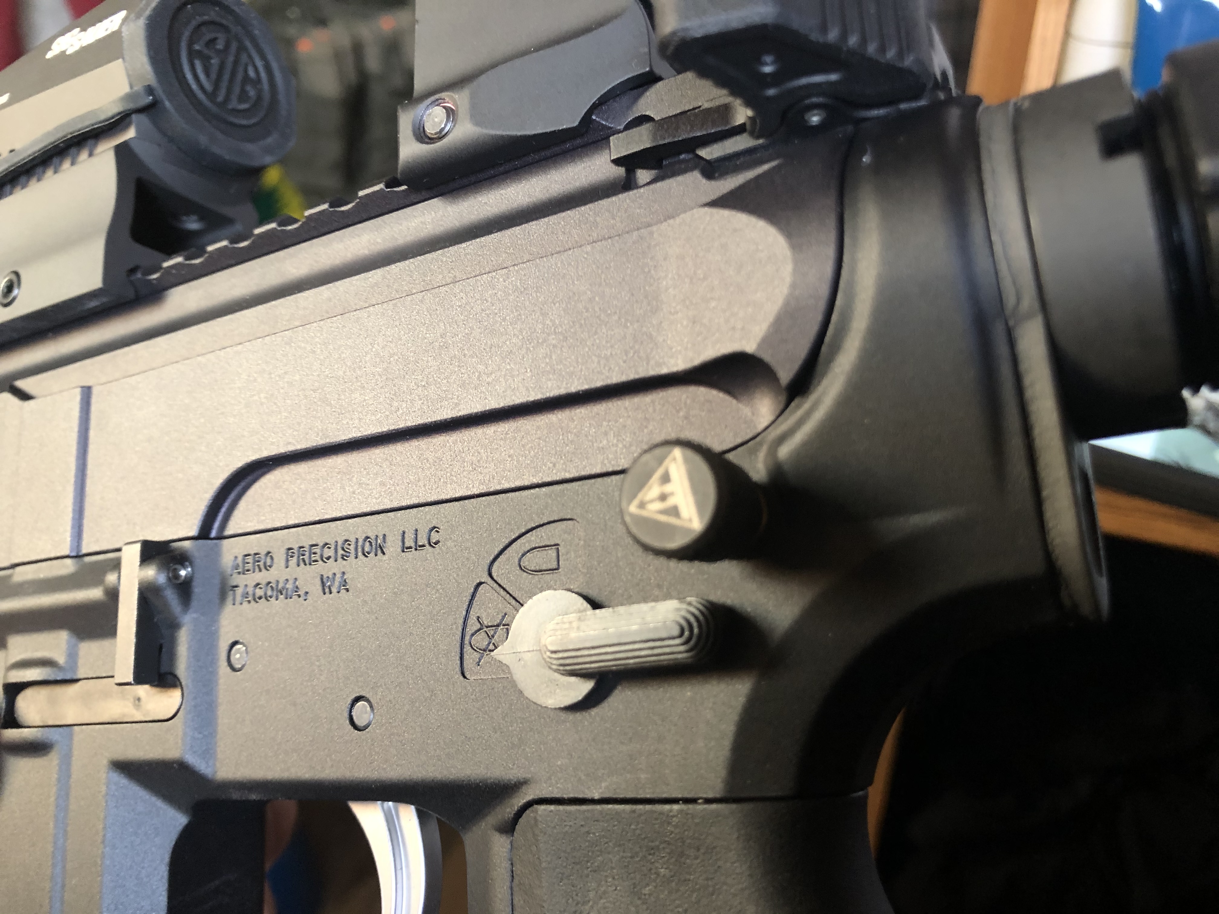

The rest of my lowers are Aero M4E1s and a Juggernaut JT15 that have a threaded pin that a hex key wrench easily installs/removes it in seconds.

:thinking: That would have been helpful! I did launch the detent pin a number of times trying to figure out how to slide in the pivot pin. We used a punch to hold the detent pin down and slid the pivot pin in. (Think Indiana Jones swapping out of the bag of sand for the skull.) It took a bit, but we got it to work.
I’ll be picking up a detent tool the next time I build an AR… Which may be soon because I love my first one!

I’ve sent the front pivot detent and spring clear across the room and have found it every time until I bought this tool.

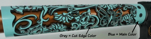

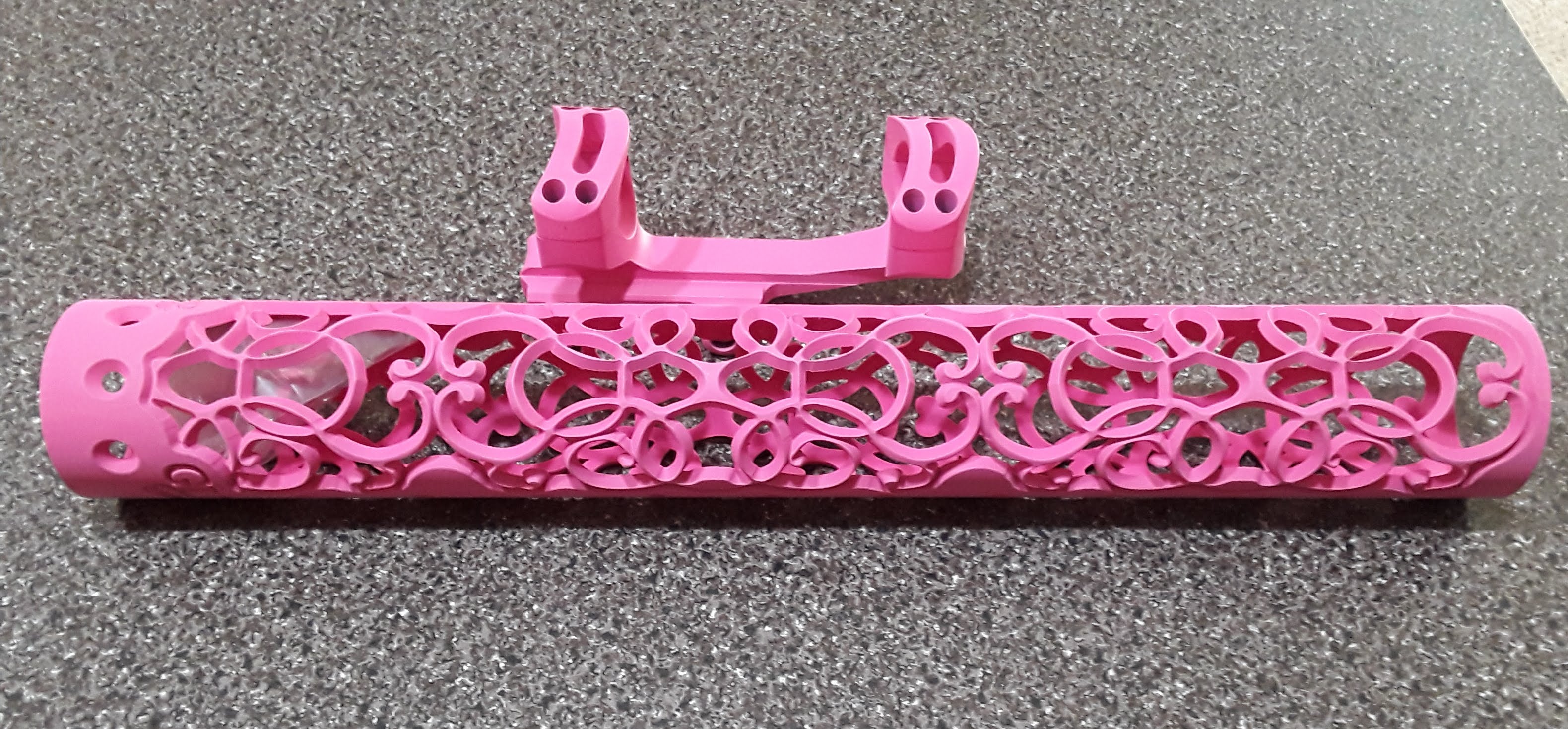

Getting ready to build a new one. decided I needed a theme. Here it is (but will not be this color):
Same place she got hers @Zee. She had it cerakoted along with some other parts so they matched.
@MarkinMT
That’s my plan too… getting the parts together, gonna have them done at one time so they match :smiley:How does she like it? happy with the quality and function?
