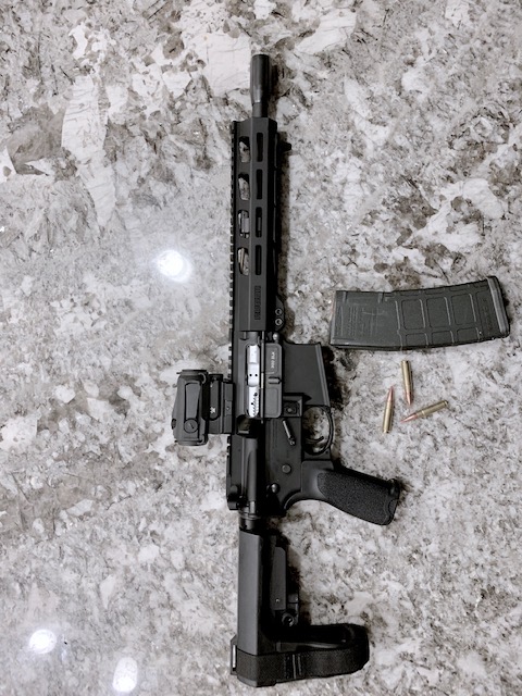

So one of the newest members of the family is a Ruger AR15 pistol chambered in .300 AAC blackout. About 2-3 years ago, I started getting into the AR pistol platform and built one, but then sold it to a friend because it just didn’t have a purpose. When I purchase a firearm, it has to serve a purpose. Either it is for home protection, carry, or for just having fun at the range. I had all these bases covered, so it just didn’t have a fit. Fast forward and I started to want something that was small, potentially concealable and had the ability to fit mounted in the hatch of my vehicle. I started searching the web and came across the Ruger.
These are the specs from the factory of this AR pistol:
10.5” barrel length, 1:7” RH twist
5.8 lbs
SB Tactical SBA Pistol Brace
Max Length 27.6”
Free-float 9” M-Lok handguard
9310 allow steel bolt, shot peened and pressure tested
Pistol length gas system
Cold hammer-forged 4140 chrome-moly steel barrel with a matte black oxide finish
M4 feed ramps
Chrome plated BCG and gas key
5/8” – 24 threaded barrel
Retail price $ 705.99

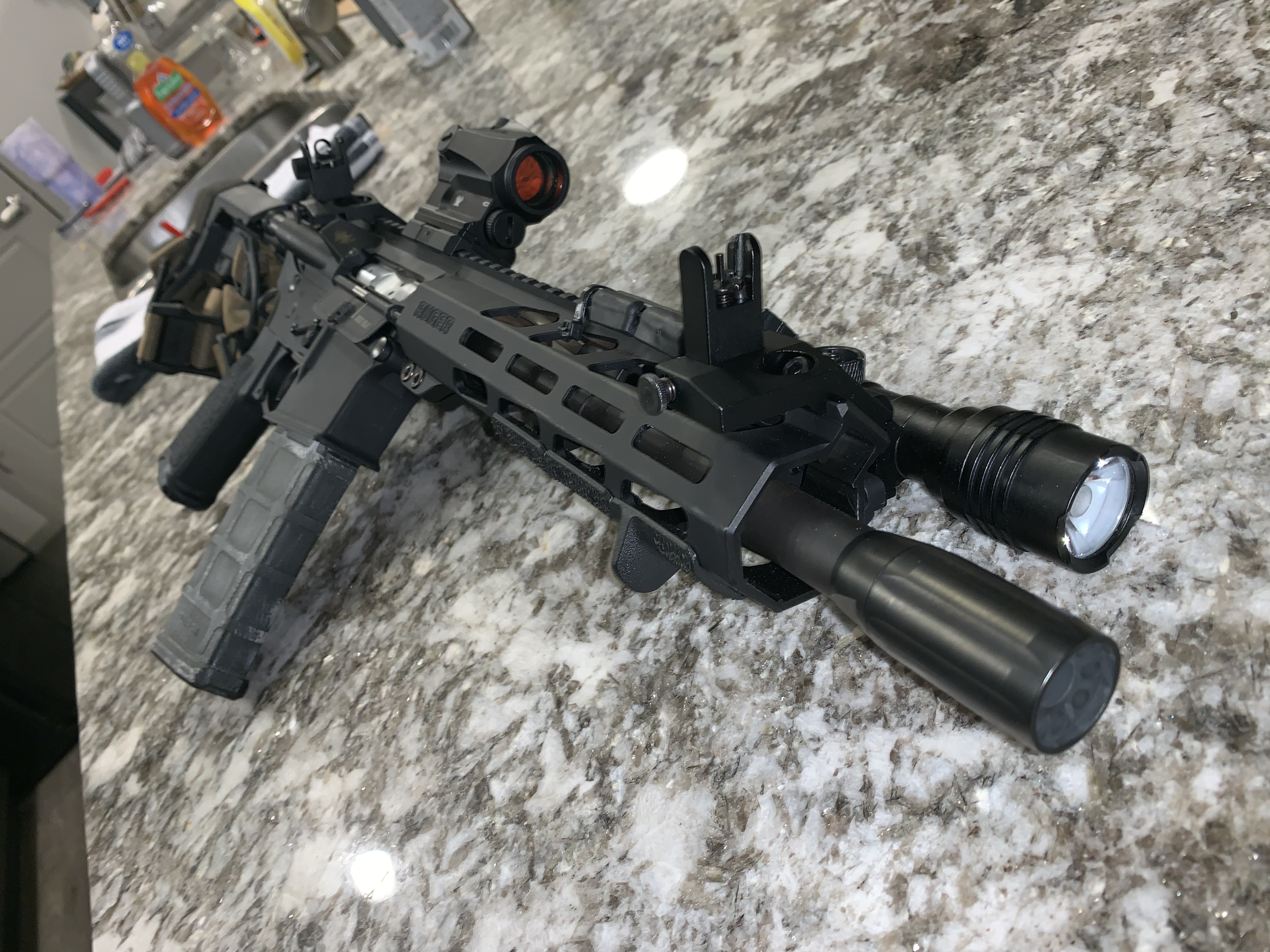

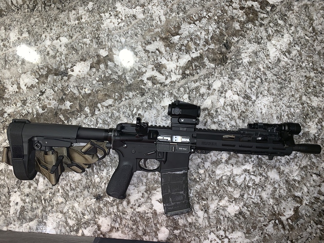

This seemed like a great base to start a build off with. Not able to leave anything stock, some items were added to improve reliability and comfort.

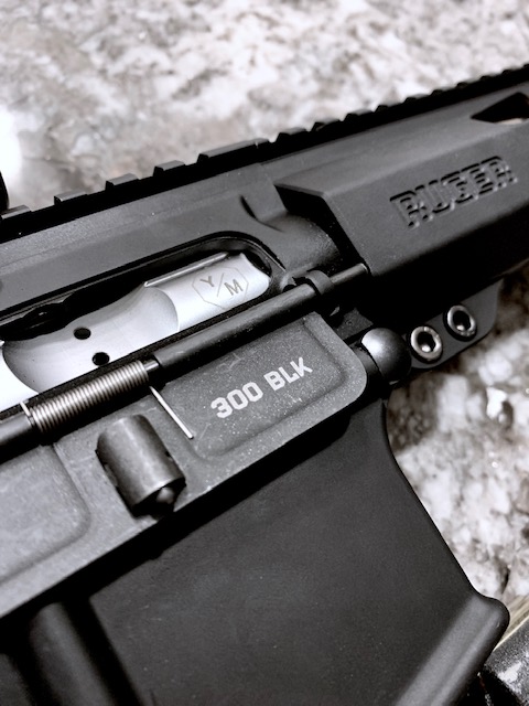

The first item added was a Young Manufacturing M16 hard chrome HMB bolt BCG. The bolt in the BCG is precision machined throughout the heat treat process at the bolt lugs, center support ring, and bolt tail. The bolt has 30% more surface area on the upper and lower guides, improving stability due to the increased contact area. What I have noticed is smoother cycling with this bolt, more consistent ejection patterns, and improved rim engagement. The HMB bolt design increased the structural integrity of the bolt of your standard Mil-Spec, helping to eliminate bolt breakage and failure. Overall, this bolt just devours ammo and keeps coming back for seconds.
A CMC 3.5lb single-stage trigger was added as well. This is always a topic of debate. Swap or not to swap? What are the legal ramifications? Well, I have owned a few firearms with upgraded triggers or trigger jobs, and on the AR15, I just prefer an aftermarket trigger over the standard Mil-spec trigger. I went with the curved trigger as I just prefer the feel on a rifle. These triggers are complete drop in units and have many benefits once installed. The trigger itself has absolutely no creep that I can notice and has an ultra-smooth break and positive reset that I love. Follow up shots during double tap drills are thoughtless and quick and the pull feels consistent through every cycle.

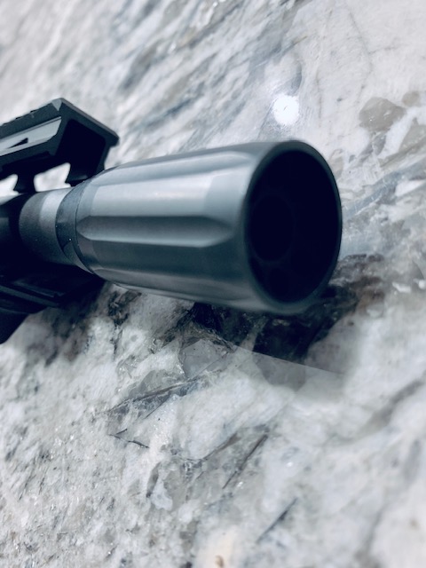

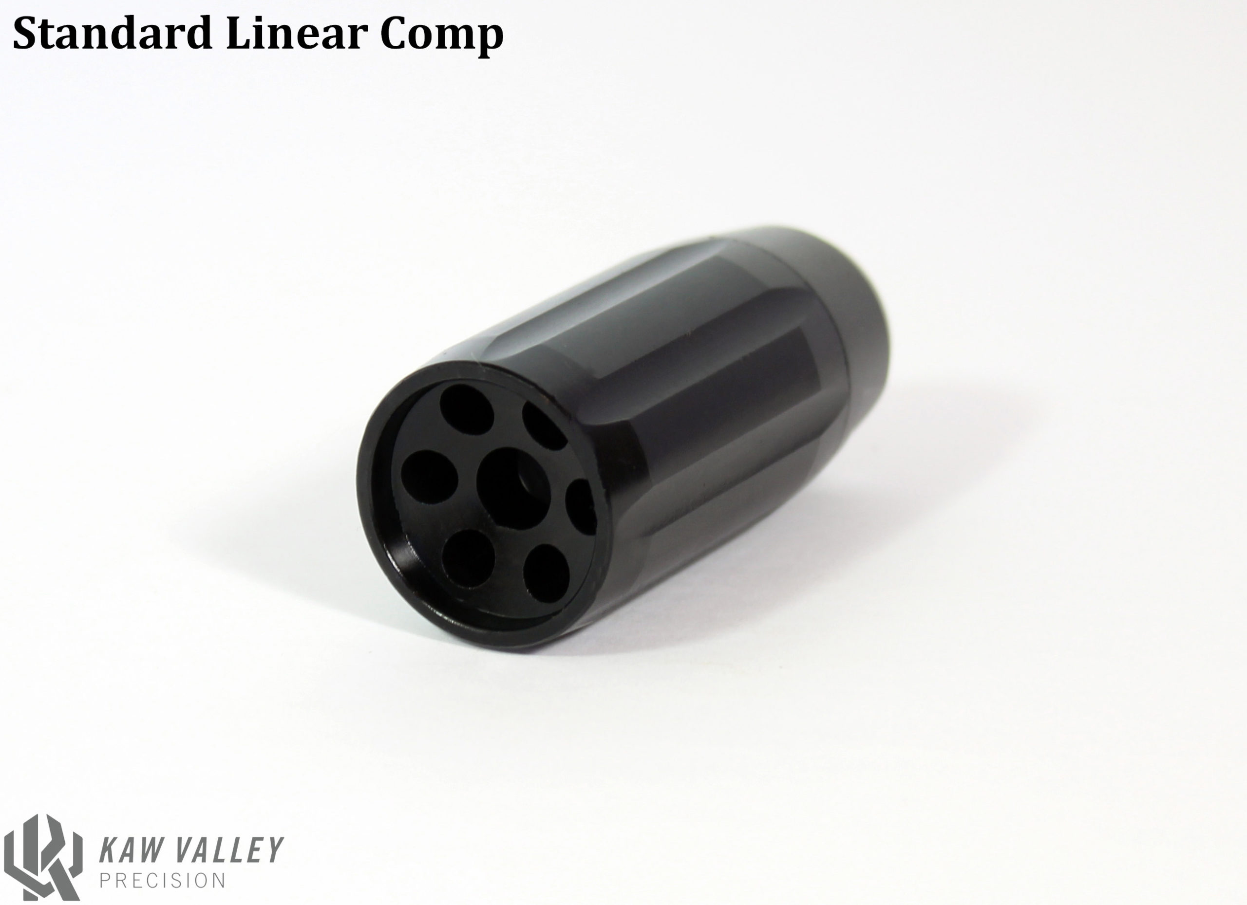

A KAW Valley KVP linear compensator was added as these pistols come with nothing at the end of the barrel. I have always gone with muzzle break on my AR15’s and have been curious on how a compensator would feel instead. The idea behind this compensator is that it sends the gases downrange, decreasing perceivable sound to the shooter and bystanders. The muzzle break on my AR15 M4 carbine is loud as hell. It makes that little 5.56 sound like it is hitting above its weight class. With this compensator, even with ears on, the perceived decibels of the .300 blk are much lower compared to a muzzle break. Another benefit I have noticed is the felt recoil. Compared to other AR platforms I have shot with a muzzle break, the compensator appears to aid with a more fluid and inline recoil. When shooting this and comparing it to my AR15 rifle, I am able to get back on target faster and follow up shots are faster and more accurate, even with the higher grain round.

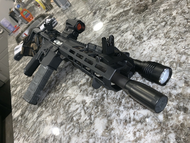

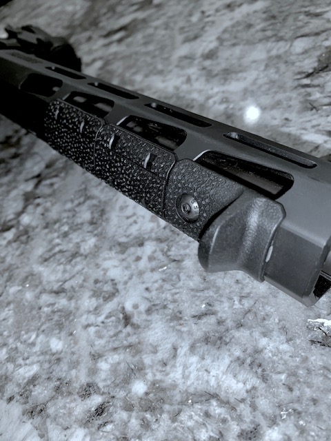

I also added a BCM gunfighter charge handle and a Magpul handstop. These are all personal preference. I like the feel and positive engagement of the BCM gunfighter charge handle. They are not oversized like some other charge handles, make charging the BCG easier, and have a great reputation. The Magpul handstop is a cheaper alternative to some of the handstops currently on the market. I may upgrade this, but for now I am testing the waters with it and so far I am pleased with it.

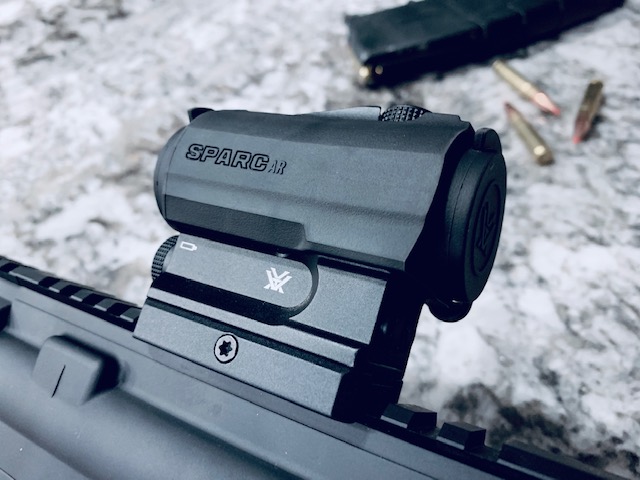

I am a fan of Vortex, so installed on this pistol is a Vortex Spark AR. I do like the simplicity of this little optic. Two buttons cycle the on/off function and the dot intensity. My eyes are aging though and I am starting to notice my astigmatism more. If I am not wearing my prescription glasses, I get the dreaded starburst effect. I may consider selling this optic and upgrading to the prism optic instead. Again, that is my eyes and is not a defect in the craftsmanship of the Spark AR. If I wear my prescription glasses, the dot is a solid circle. Whether indoors, in a low light situation, or in the blinding Arizona sun, this little red dot has enough intensity that it is not drowned out. What I do not like is the flimsy protective caps that come on this red dot. On my strikefire II, it has hinged caps that do not flop around like the Spark AR. The Spark AR caps are designed to link together, but that is just another step to go through in a SHTF situation. I have not had an issue at this time with a cap flopping into view, but the potential is always there. I may investigate a solution to this, and if there is no solution, I will be selling this optic in the future and upgrading to an optic with better optic protection options.

Ruger has done an excellent job in this category. There is no noticeable play in between the upper and the lower and it has a solid joint between the two. The overall finish of the pistol has held up well after multiple trips to the range. There are no odd rattles or wiggles anywhere that I can find. All engageable parts that are factory have a positive feel. The SB tactical brace engages the buffer tube well with no play and the castle nut from the factory appears to be working well. I have not had to go through and tighten anything or consider upgrading due to lack of quality. The only upgrades performed are due to personal preference.
