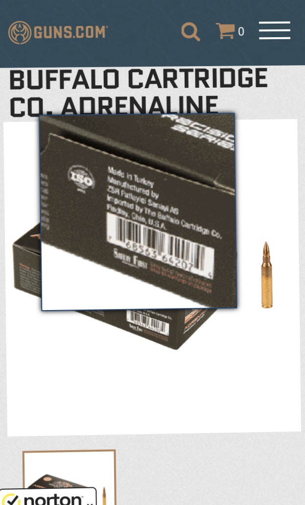

I’ve never heard of this brand. Is it remanufactured ammunition? It sounds like you have narrowed down your problem to the ammunition.
Do all the cartridges in the box have the same head stamp?
Yeah the back of it has a red circle mark all of them say .556x45
Made in Turkey

Okay, I’ll discard the current box I opened, cause I have 2 more boxes of the same brand. I ran one box through the gun as shown here and it worked fine firing. So I thought I was all good with that ammunition. I’ll probably load .223 in it tonight and try it because the .223 had no problems before the range. My local shopped only had .223. The range gave me .556.

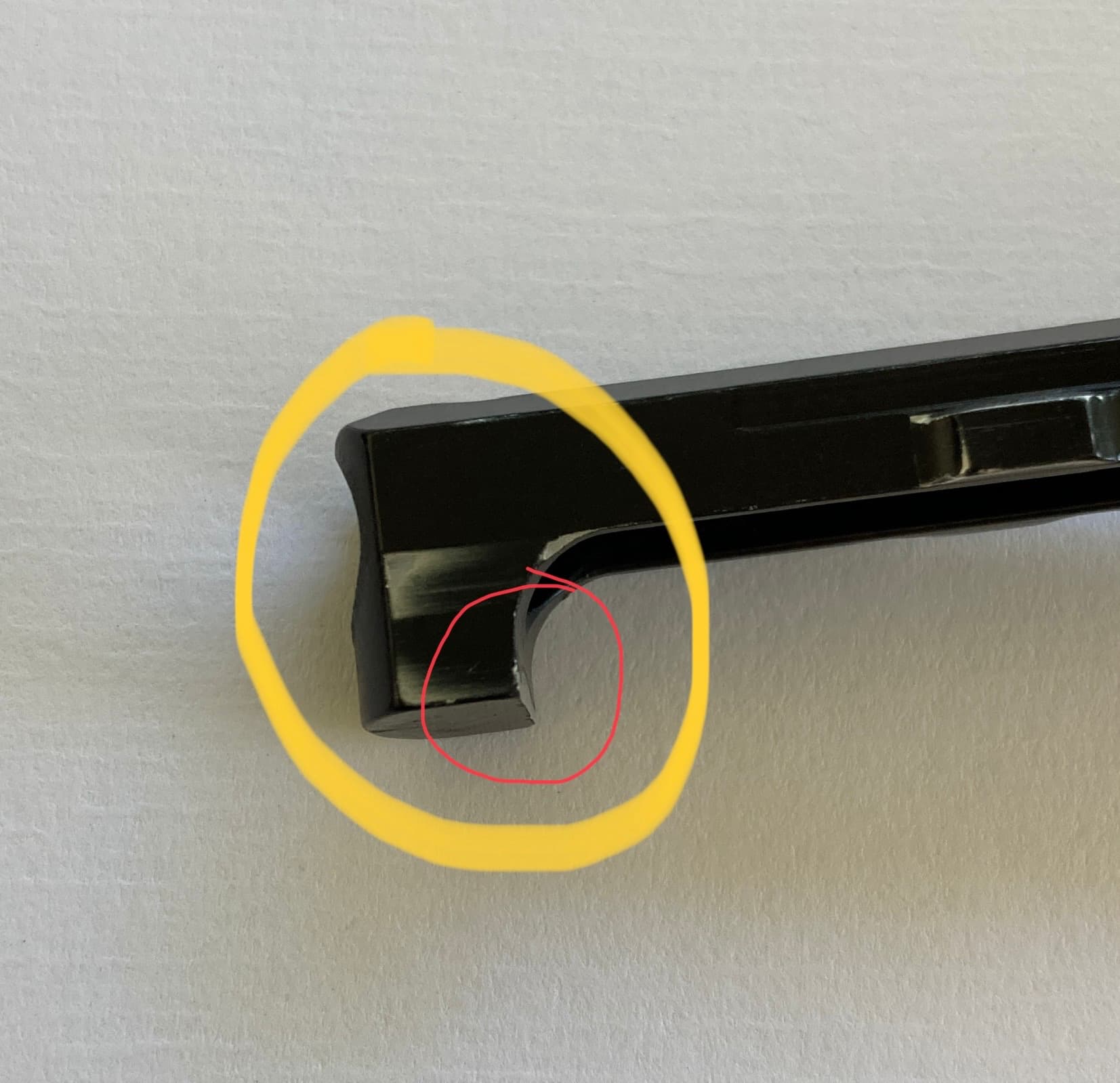

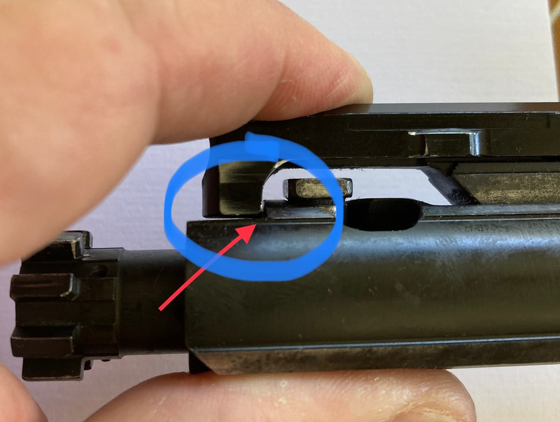

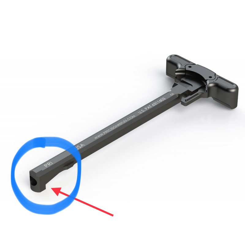

Can we see a real “sharp” picture of your charging handle on it’s side.
Can you tell me, is your charging handle as sharp where the arrow is located, if not, that’s your problem!
Some remanufactured handles are smooth or after extreme use are angled or wedged.
If the charging handle does not catch on the BCG it will ride up and lock into place.
Even from the looks of mine, over a couple of 100,000 rounds, it’s time for a new one!

Will show when I get home.
