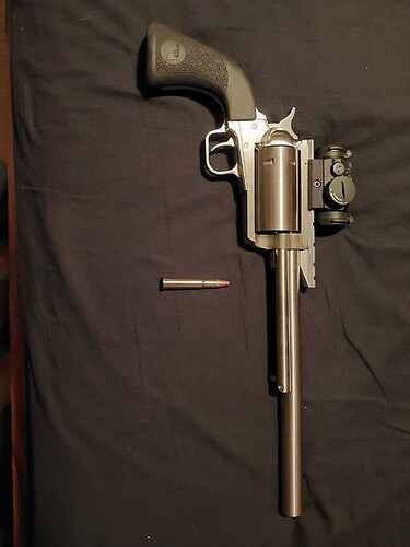

The newest hunting cannon. Chambered in 30-30.
Holy $#!+ Batman. I hope that thing weighs a lot. I can’t imagine what that thing does after the trigger is pulled. Videos???
Actually not as bad as you would think or I did think. It weighs in at about 6.5 lbs. The recoil is comparable to my 4 inch .357 revolver. Its loud as hell though, even with muffs on. Ill try to get a video sometime.
As a dearly departed friend would say.
" a gun that big should have wheels"
:innocent: :innocent:
I had to put my arm in traction after seeing that. :grinning:
