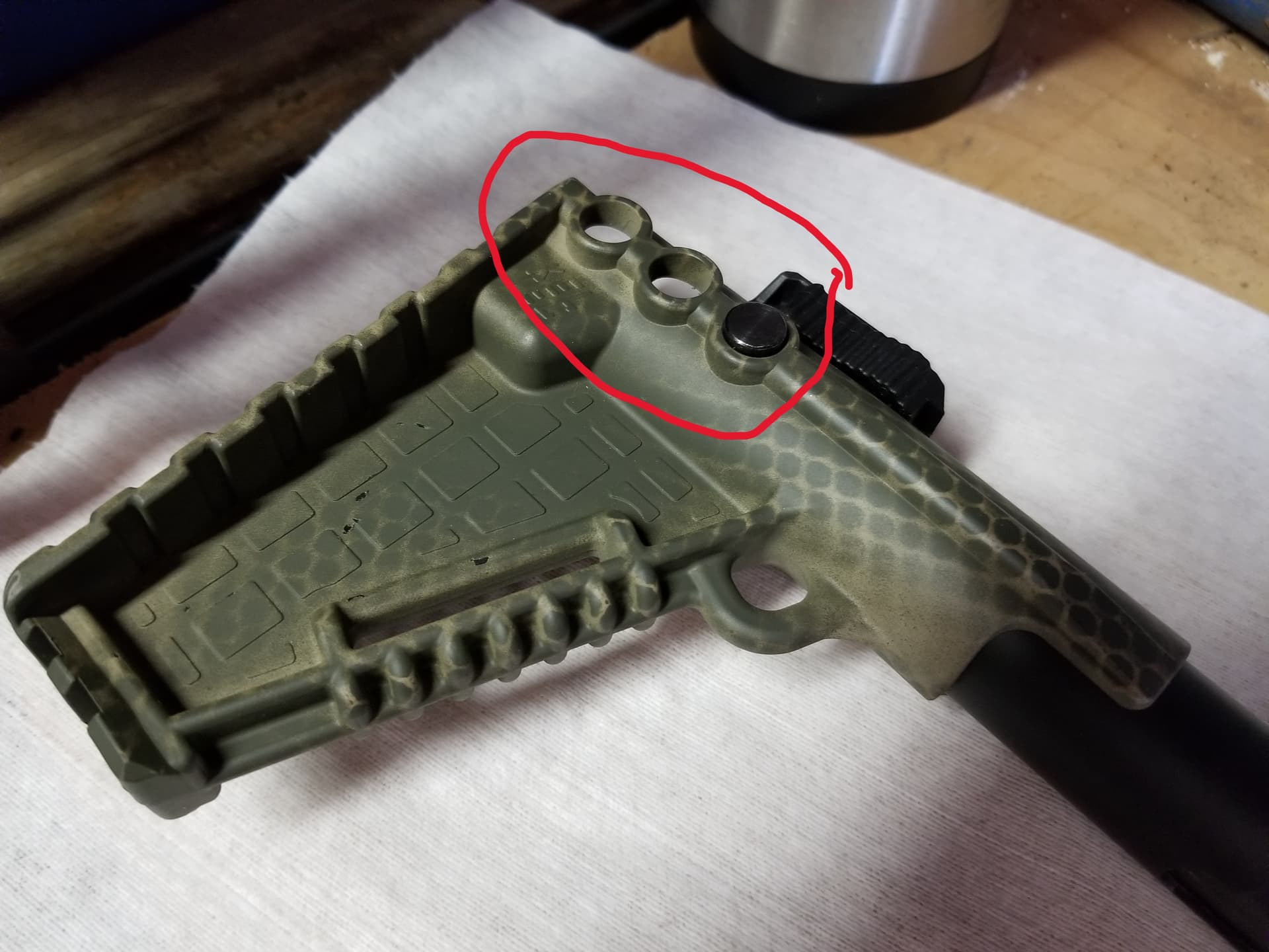

Can ANYBODY tell me the lop adjustments for this gun? I was looking at this for .40 or .45, but it seems to be a deep, dark mystery on their damned website. It looks like there are at least 3 stops to use.
To determine your LOP, mount the gun then measure the distance between your nose and the knuckle of your thumb. It should be about two finger-widths or 1-1½ inches. A stock should be short enough that you can mount the gun without snagging it on your vest, but long enough that you don’t have to pull it a long way back into your shoulder, which can pull the muzzle off target.
There are only 3 holes to adjust you LOP on the Sub2K and it is the same on all the different calibers.
On the top rear portion of the stock there is a slot with a plug in it. Plug is incorporated with the latch that keeps the weapon folded. To adjust, you will need to hold a finger over that plug and push the pin out. DO NOT LET GO OF THE PLUG!! It holds tension on your recoil spring, bolt carrier group, charging handle… Adjust your stock to one of the three holes provided and push the pin back in.

The LOP on the weapon is a little short as it only has three settings with no option (currently) to extend it. I have mine adjusted to the longest setting and I manage.
