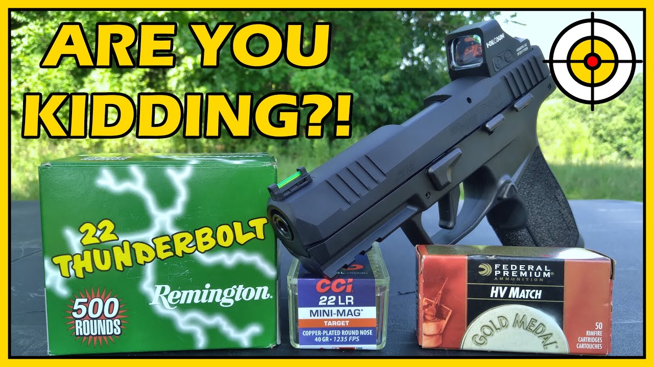

From the video I saw regarding this Sig322 issue, the concern was more with the barrel specs being undersized therefore physically scraping material off the bullet, leading to quicker, heavier fouling of the barrel then “normal” with other 22lr pistols. As we all may know, a .001 mis-sizing can lead to problems.
I’ve read that too. I’ve read others who say that’s nonsense. Gotta love the interwebs. Everyone has an opinion.

Here are the videos I’ve seen about the leading of a Sig322: seems a bit excessive after a couple of magazines
I have a GSG Mosquito with 3000+ rounds with no appreciable lead build up using a myriad of ammo brands and configurations.
Only time I noticed leading was on my CMMG insert after shooting several hundred Rem. Thunderbolts. jacketed rounds don’t seem to cause any issues.
Exactly!
You’re pushing bullets made for a .222” barrel down a .224” barrel. Plus the long running start the bullet has before it hits the rifling in the barrel.
