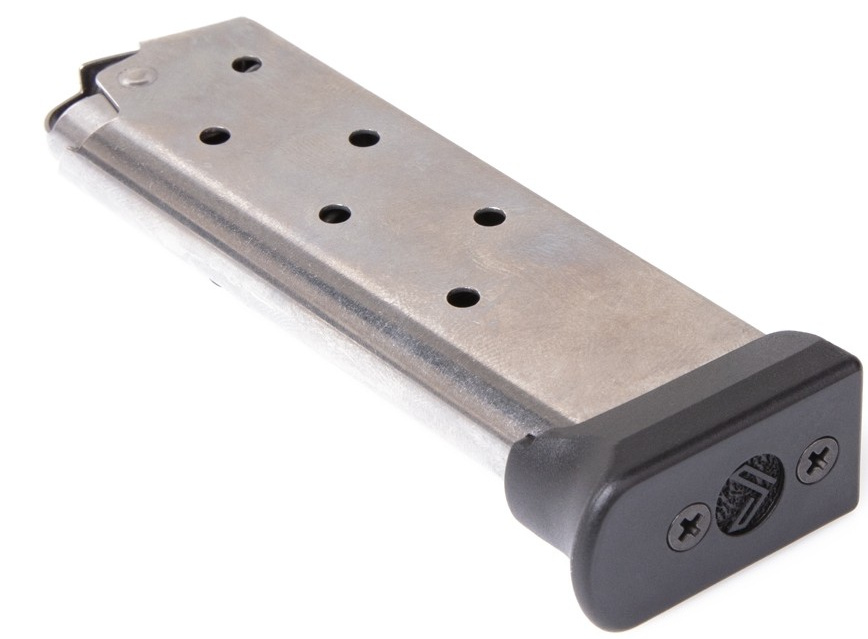

What would happen if it’s a P938 (that’s my daily carry)…just curious if there’s something to look out for.
I have experienced issues with the “pinky extension” sliding up on the P938 7-round magazines. I first noticed when I was doing magazine swap drills and letting the dropped magazine hit the floor. What was happening is it felt like the “new” magazine was locking into place, but upon racking the slide, it would chamber one round and the magazine would fall out on the floor. This photo shows an obviously exaggerated slippage, so I have trained myself to insert the 7-round magazines with my thumb on the very bottom pushing up against the metal floor of the magazine.

It does not take much, maybe 1/32" to 1/16" sliding up to prevent full engagement with the magazine release.

Ooph! That’s a great tip. Seems like Sig needs to release a product fix and free replacement of those. You have a solid workaround, but I would expect that the be fixed in place.

Yes, they have improved it for the P938 Legion, but not for us average guys :frowning:
SIG Store - Shop Online at the SIG SAUER Web Store
And, no it does not work in “our” P938 - at least that is what I have been told, I have not tried it myself.
