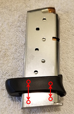

I guess I am :hushed: Shown exaggerated in photo below, the pinky extension had slid up making full insertion into the mag well challenging. There is a retention feature that should have prevented this, but it didn’t.
Regardless, it did not hurt to R&R the mag release, it was pretty nasty!
Just got off the phone with Sig Sauer. They do not maintain configuration control by Serial Number. Therefore, they have no idea what Revision my magazine release is. They did offer to inspect my firearm if I wanted to ship it to them for analysis. I will not be exercising that option at this time.
Regarding the slip and slide on the pinky extension, they also offered to have me ship the magazines for their analysis. After I analyzed the design I have concluded two things:
  1. The retention feature is only molded into one side and should be as a minimum molded into two sides
  2. The retention feature should be at least twice as deep for long term reliability.
Short term workaround (for me) will be to press on the metal bottom of the magazine to insert (as opposed to pushing with the palm of hand). Long term, I will probably match drill a couple of holes thru the side of the magazine and the pinky extension as shown below. A small diameter stainless steel wire will be pushed thru the new holes and trimmed to length to retain the pinky extension in place.

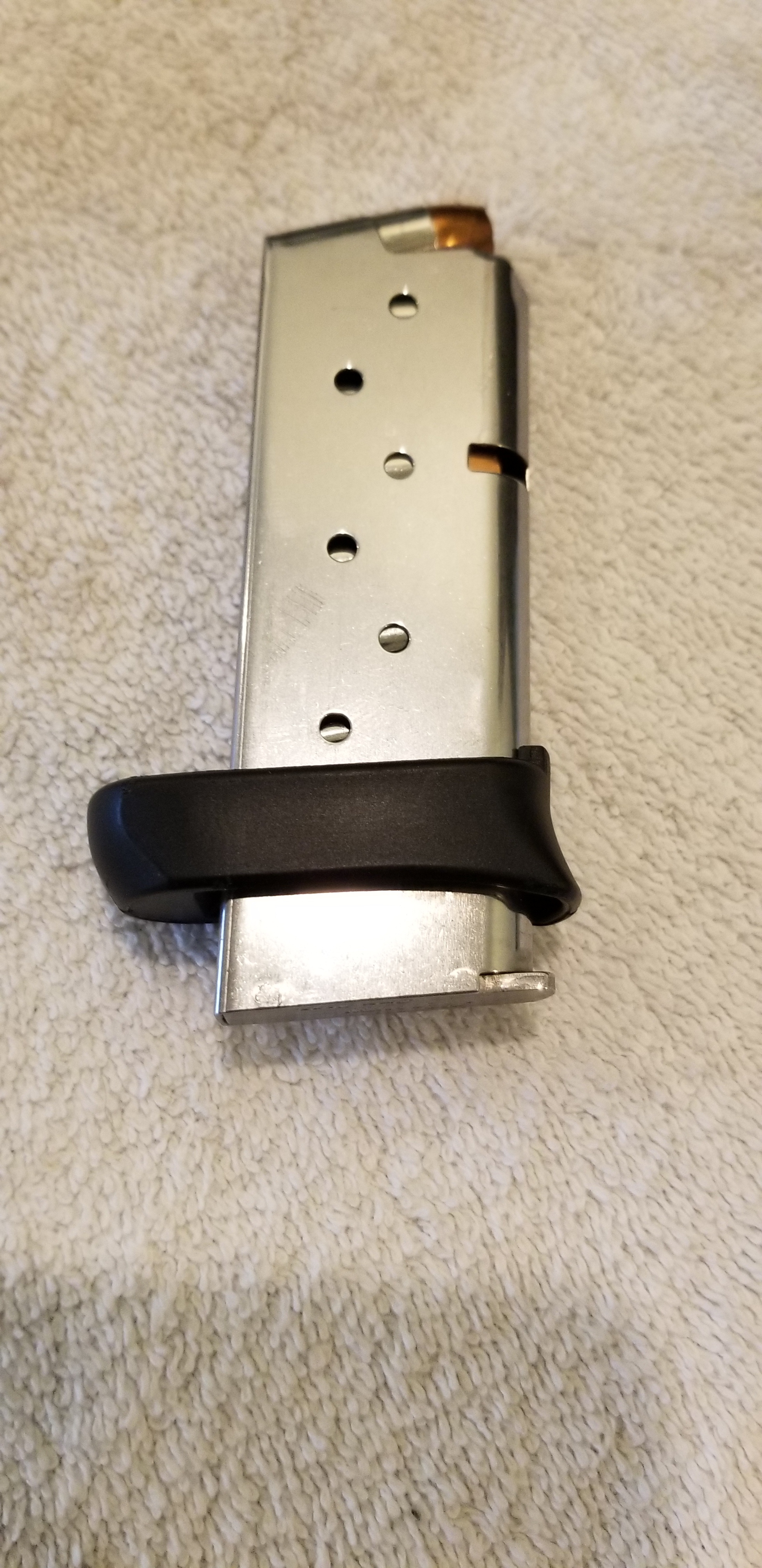

(FYI for those of you who don’t know, this is what it should look like)
