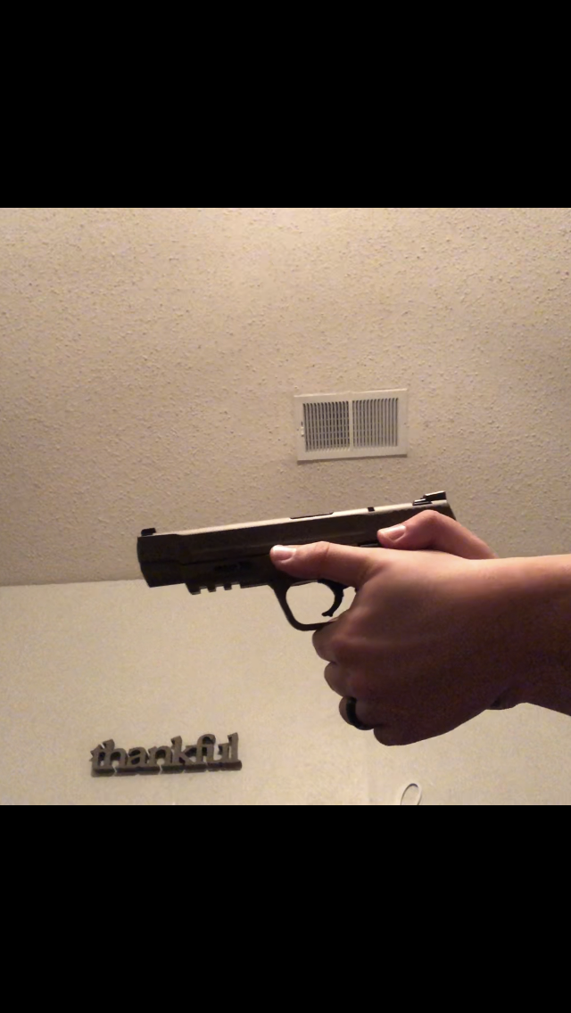

Just for fun, I’m going to show how the other m&ps are different. I really love the size of the shield .45 though. Maybe one day I’ll venture to an M&P compact or subcompact, but that will be years away… my wife would kill me if I bought another gun right now :rofl::joy:.
The full-size, slide release wouldn’t even be an issue if the safety was gone. The shield 9s release is actually smaller and my thumb barely reaches it even though it’s a much smaller gun than the 45. It’s also not functional as a slide release, and is not in any way sensitive enough to keep the slide from sliding back.
I like to keep the same system among my guns because they all operate extremely similarly if that makes sense.

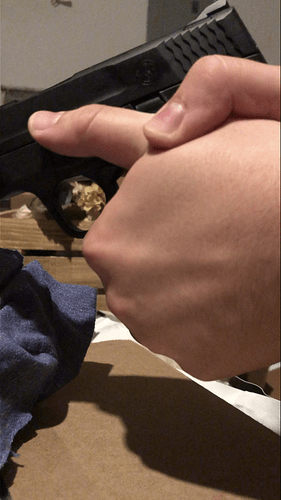

So I did this. While I was playing a round I think I found a viable solution. It’s a combo of what you and Craig recommend, and what I originally was doing. If you look at my full size and 9mm my thumb actually curves with the safety. My grip is not the same as it was on the .45. I think I have been inconsistent with where I put my right thumb while at the range. Some times it arches on the safety, other times it finds its way to the slide release.
If I do what I do in this picture, I have a good grip on the gun and I’m not near the slide release. I basically put my thumb in the same angle as if it where on my hand, but instead it anchors on the safety.

So here’s what it looks like.
Today when I had trouble locking back, this was my grip
This is the grip I talk about when I don’t have issues. This is the grip I ride the safety at an angle. I just realized I often do this grip when shooting slowly, when I do rapid fire my thumb has the potential to drift like the first pic.
I do not like this grip. This is the grip Carry Trainer recommended to fix the slide lock issue.
