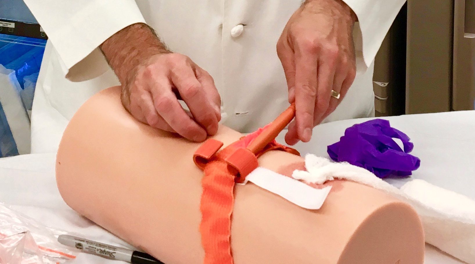

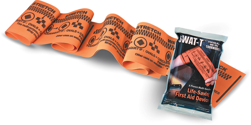

What do you all think of the SWAT-T tourniquets?
Image from Walmart’s website.

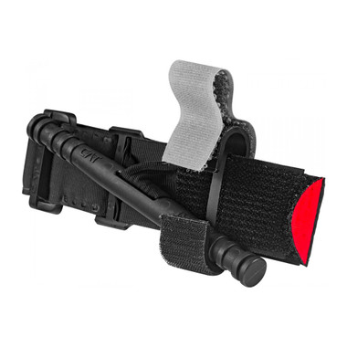

I have CAT-T type like this
Recon Medical BLK-1PAK-FBA Tourniquet - Kevlar Metal Windlass Aluminum

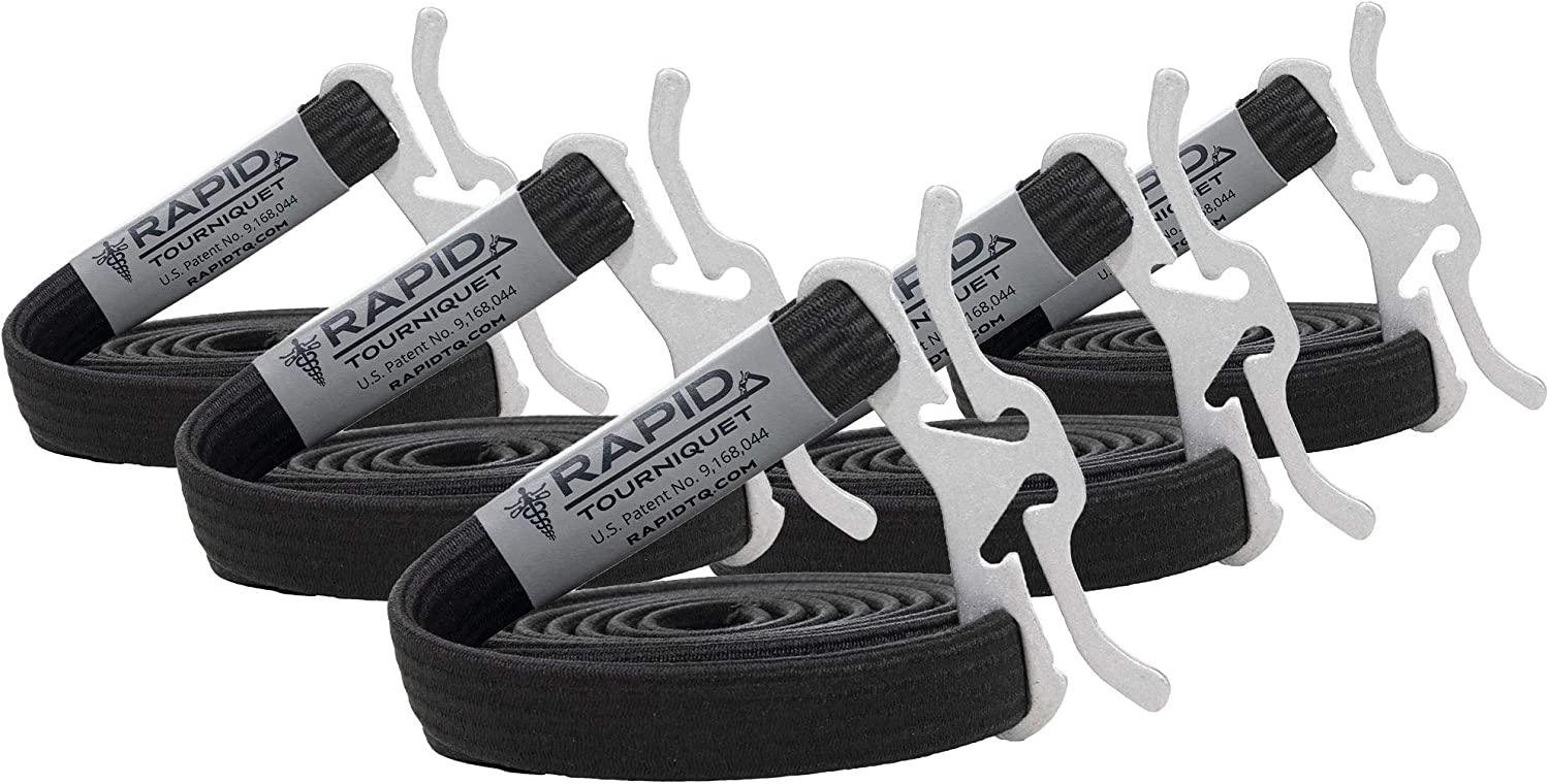

I have RATS because they will work even on small kids with thin limbs
RATS GEN 2 Rapid Application Tourniquet System

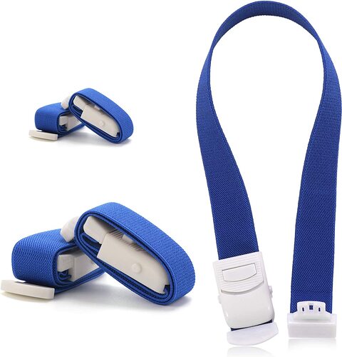

And I have these, if someone who didn’t know anything had to use them, this is a very familiar design.
Medicook Tourniquet

I carry a SWAT-T and a CAT as part of my EDC. I like the swat because it’s real easy to carry and can also be used as a pressure bandage. Also great for “buddy wrap” applications. Self application on say your arm, would be tricky but is possible. I practice by holding one end with my teeth while wrapping with my “injured arm” with the other.

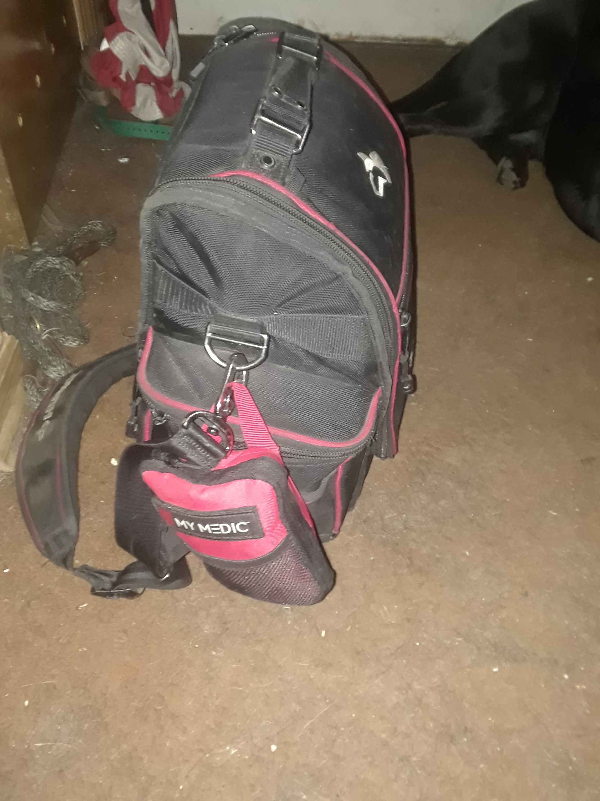

I carry a trauma kit and tournakit in my toolbox at work , one in the car and one in my range bag. Have tried a bunch of companies but dont think you can beat the kits from mymedic.com

I’ll also mention that I wouldn’t trust the “Medicook Tourniquet” listed above (@Zee) on Amazon for a life threatening injury. I use one for medication delivery and would worry about it snapping with any movement. It appears to be a tourniquet such as those used for phlebotomy or other intravenous procedures.

They had this type in my Stop the Bleed class as one to try out. The whole pulling it tight until the squares become diamonds was too fussy and I am not sure how my grip would be with slick bloody hands. The CAT-T was the one I chose for my carry, it is not as compact as others but I can put it on with only one arm.
