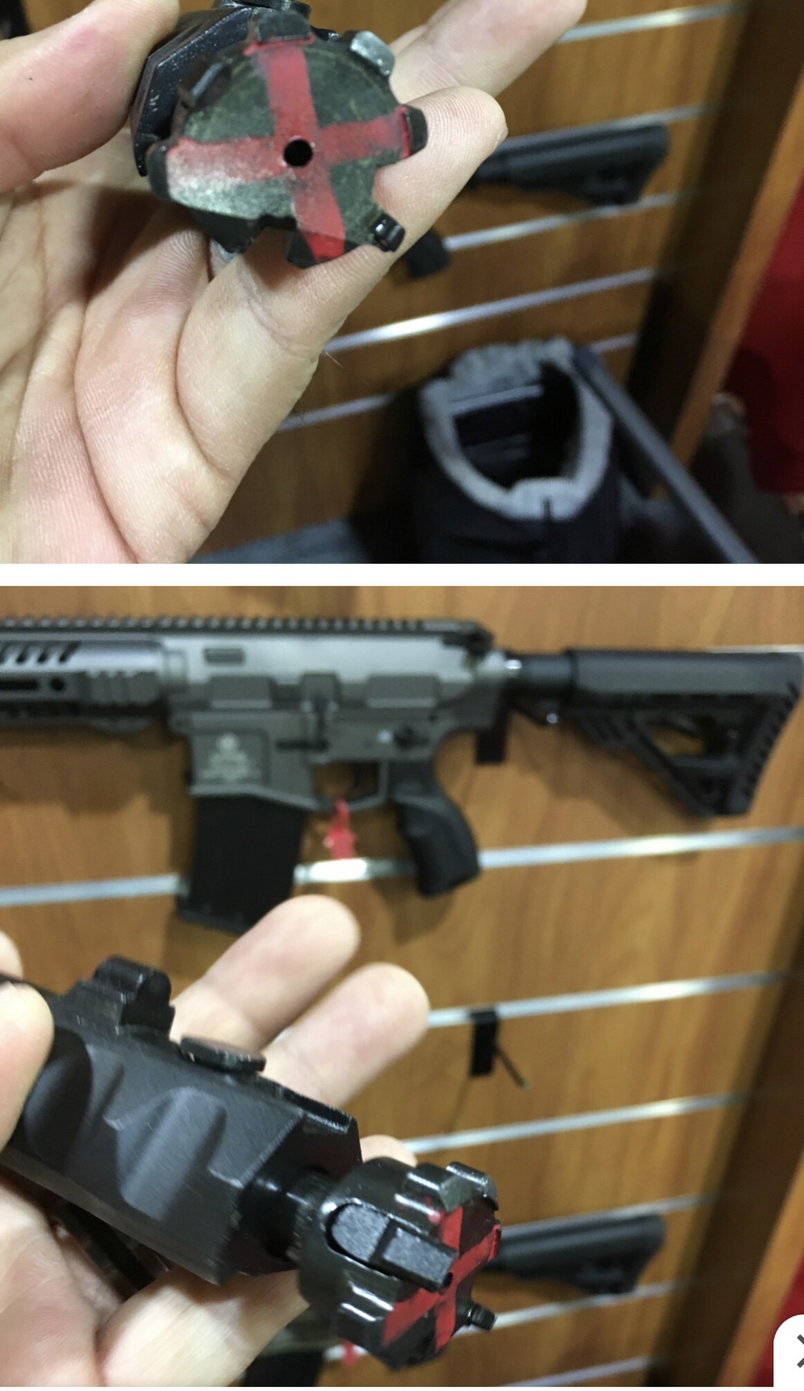

Might want to check the fingers on the bolt.
Are the bb/slug weights the same in both rounds? Velocity difference? High brass/low brass shouldn’t make much difference as the propellant charges are very similar between the two.
Also, what happened to the bottom of that bolt ![]()
That’s a new stock bolt pic
Looked like there’s a chunk missing… guess not lol

That’s the flat side of the bolt, it’s a shotgun:wink:![]()
Lol I see the flat, smart ass ![]()
