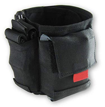

I took a “Stop the Bleed” class and they provided us with a IFAK and instruction on how to use it. How to carry the kit was the issue. Most of the items could be carried in a ankle cuff similar to the one in your picture, the tourniquet was an issue for me. There are a lot of TQ’s that are more compact than the CAT, but the CAT was the only one I could apply one handed (and that wasn’t very easy either). So I went to a second ankle cuff. The first one has CELOX gauze, vented chest seals, compression bandage, duct tape, light, and EMT shears. The second has the CAT and a spare mag.

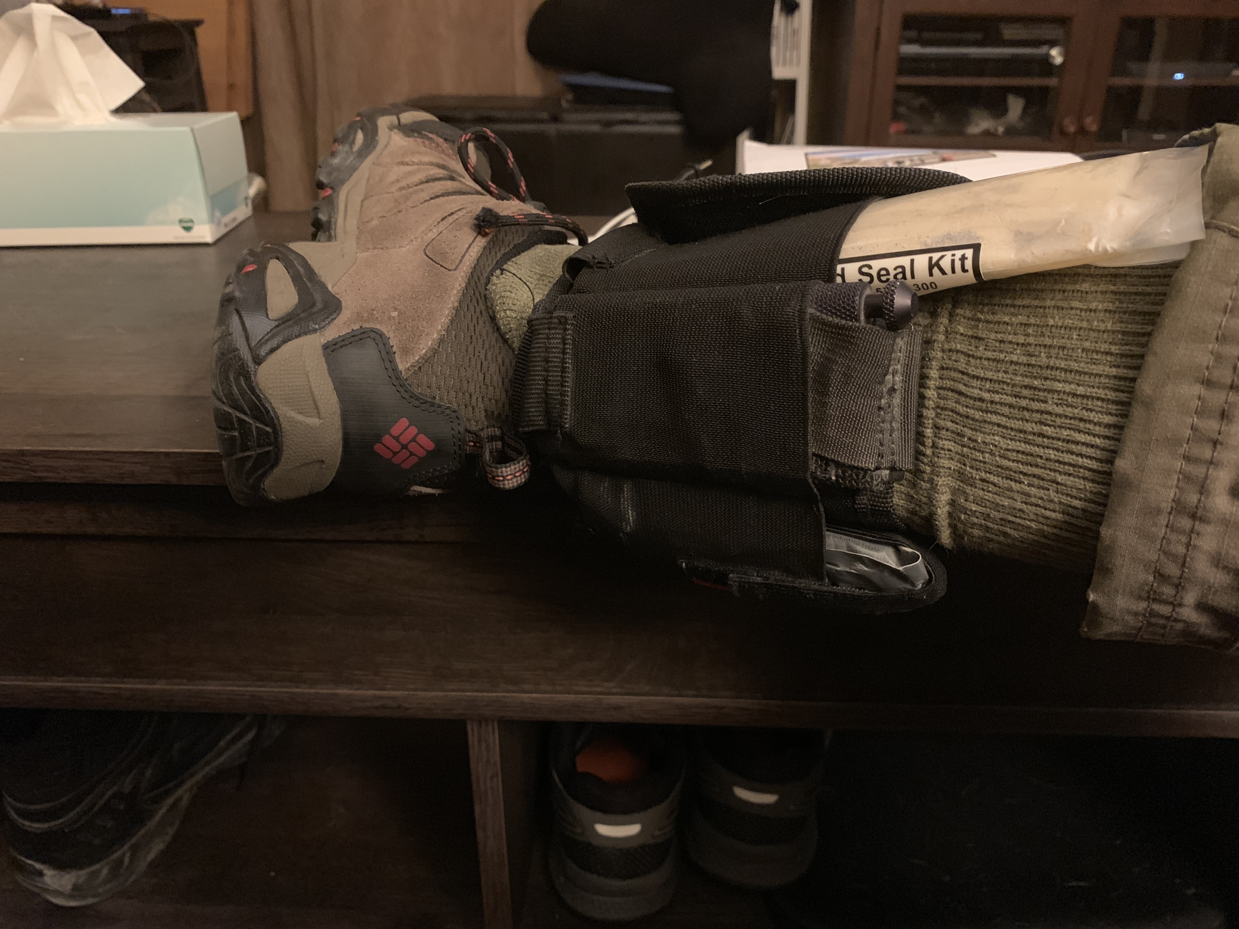

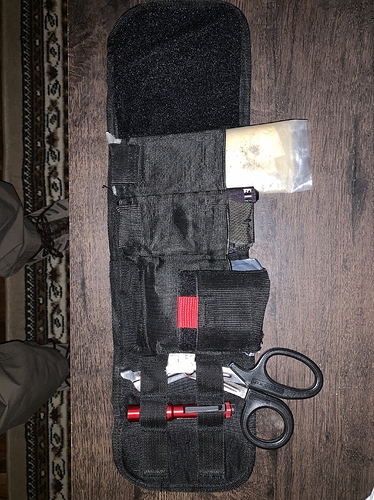

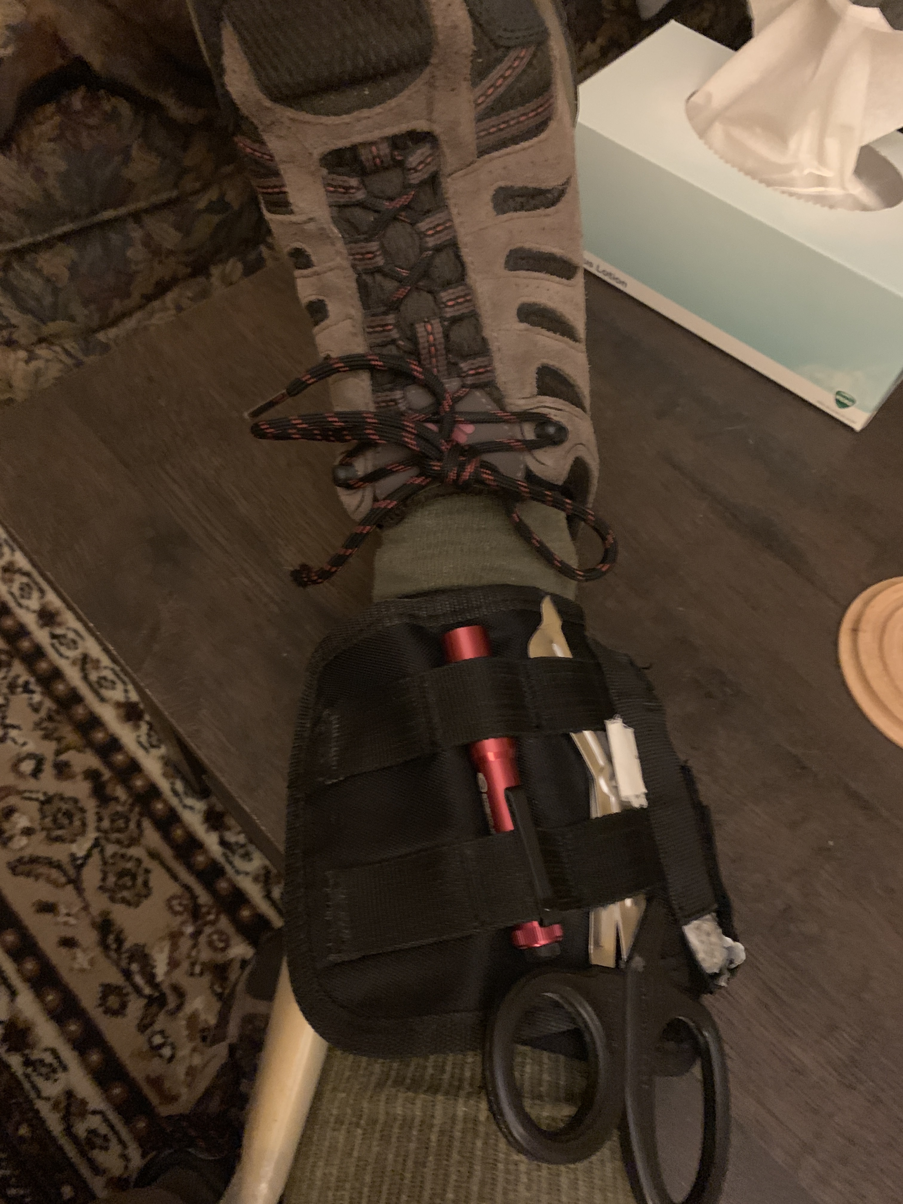

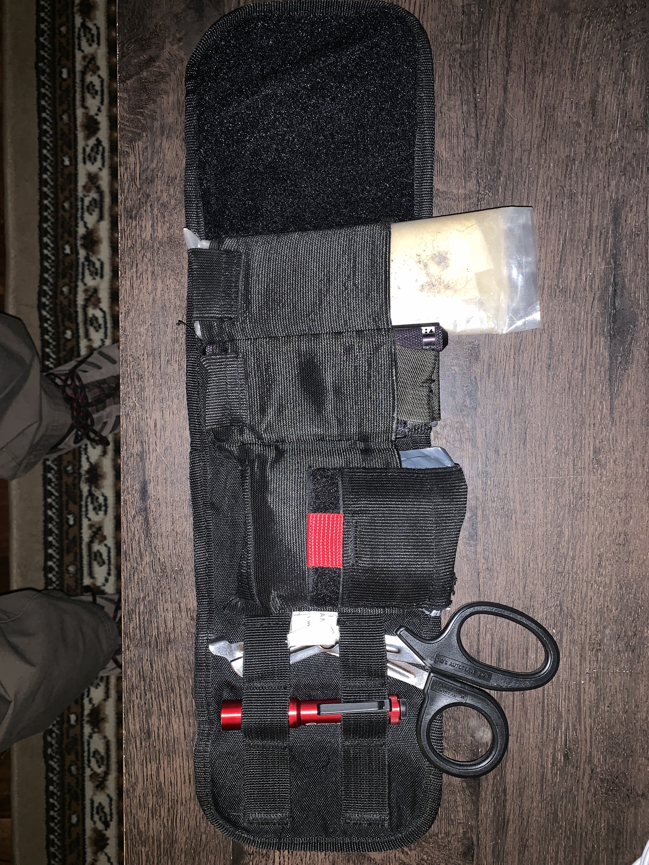

I use an ankle IFAK everyday. I got it from Recuse Essentials. I carry a rechargeable streamlight flashlight, shears, compression dressing, NPA, pair of chest seals, and a TQ (SOF-TW). I have a separate kit on my gun belt, another on my range bag and large trauma kit in my truck. Each kit has more equipment than the previous kit but I won’t bore you with the details.
@zee No problem. I can only post one pic at at time so there’s gonna be three replies to see it. I don’t find it to be bulky or uncomfortable. I literally wear it everyday and everywhere.
