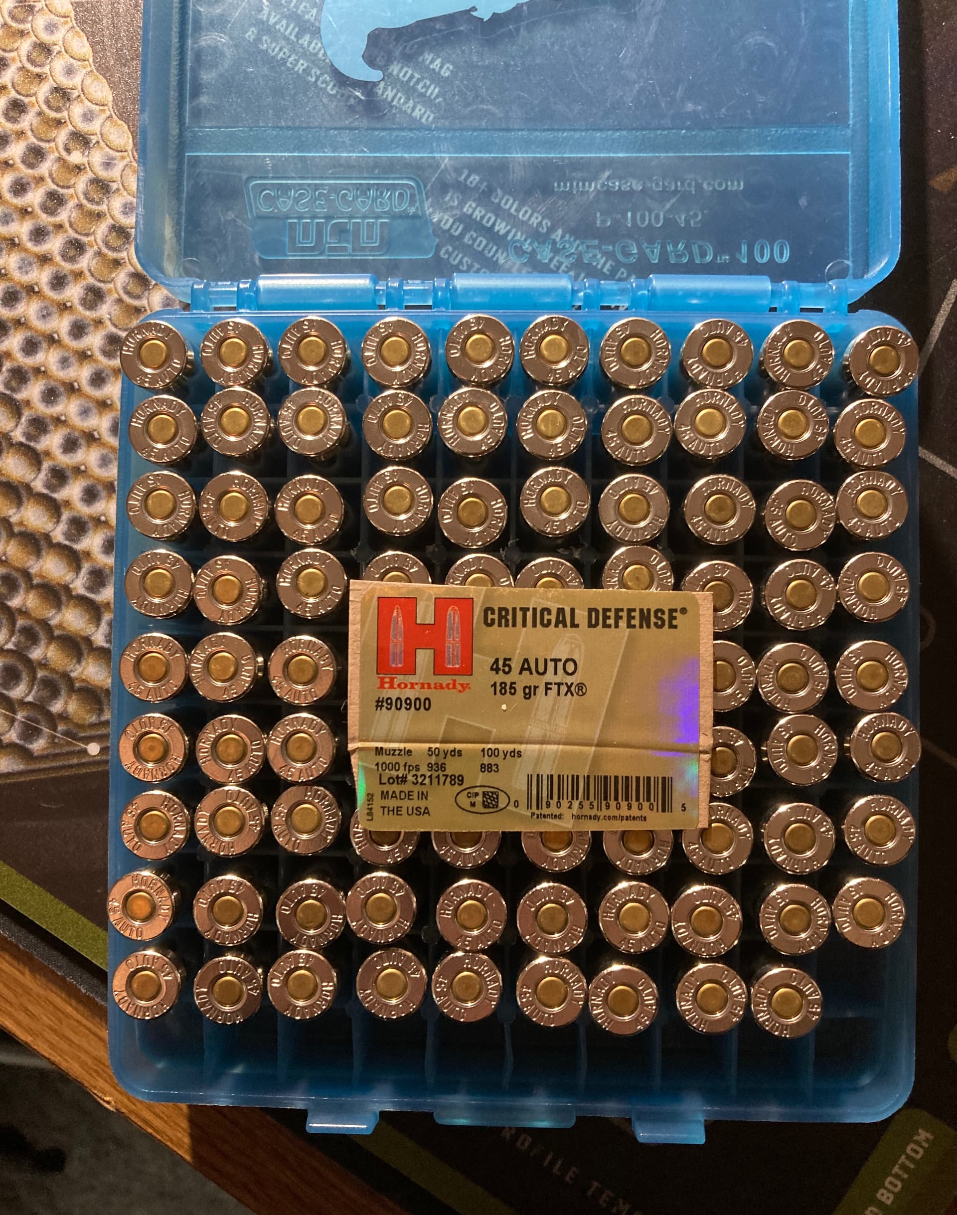

When storing my ammo, I use flip-top ammo boxes. They come in different sizes for different calibers. I have mine color-coded for the different calibers and it is quick to grab a few boxes when going to the range, instead of taking multiple ammo cans. I usually order them from Amazon, if my local store does not have them in stock.

Thanks for the info! The pros and cons listed make a lot if sense. Calvin, I actually have a half dozen or so of those MTM boxes. I got them after some ammo I purchased came in 500 round bags. I use them for transporting small quantities to the range.

I’m with @Calvin_USCCA all the way. My MTM containers are color coded by caliber and the type of ammo. eg: “Orange for defensive loads”, “Blue for ball ammo”, etc. this also gives me the opportunity to inspect the ammo for any imperfections! Or stored in color coded magazines then rotated after every range session! In addition, just in case there’s a problem or a severe malfunction with the ammo, I log the date and the LOT # in my shooting journals.
