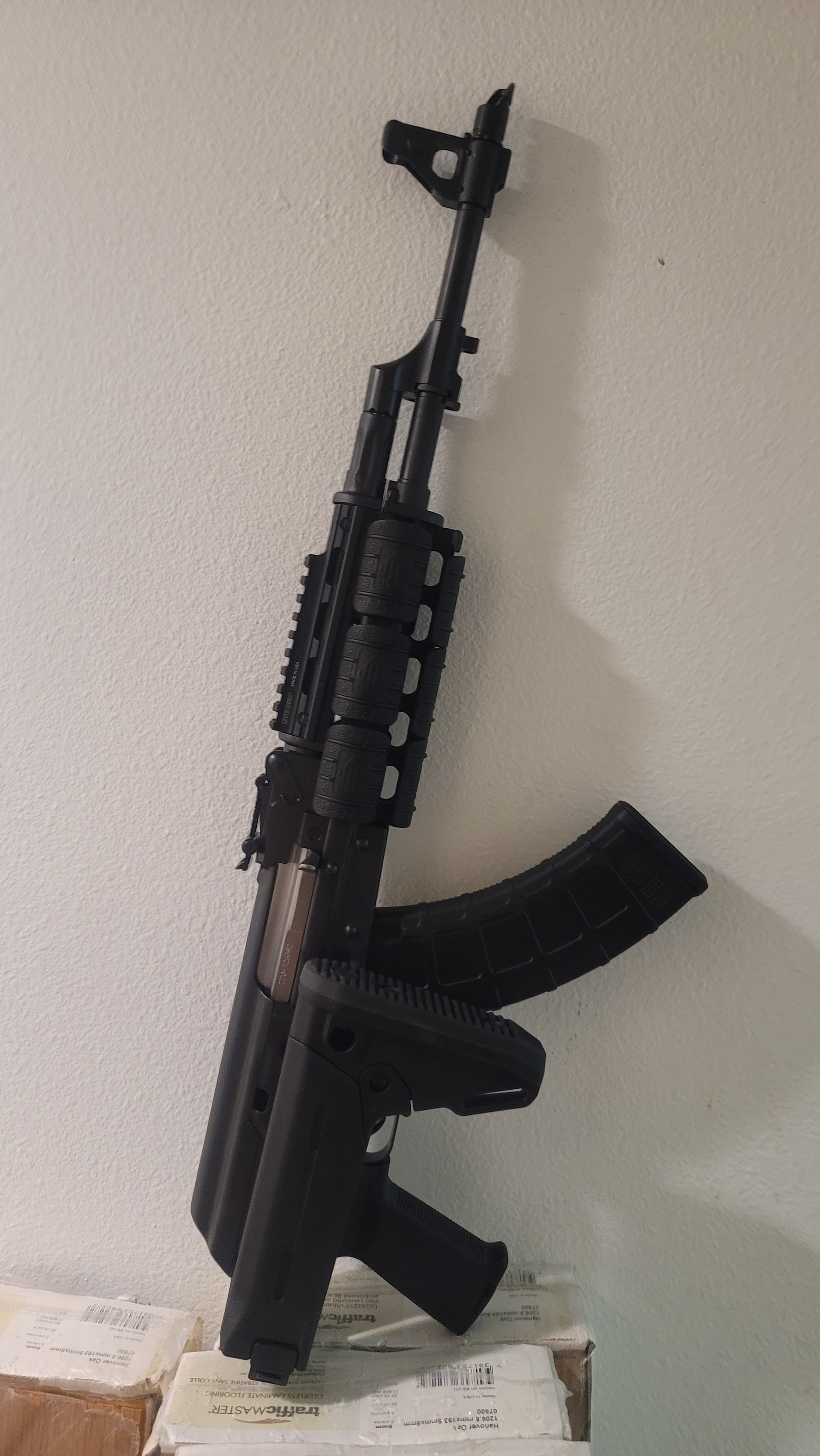

I sold both of mine, pistol and rifle in 7.62x39 and got a nice AK, ZPAP M70. It eats through any ammo.

I did like the 7.62x39 uppers but ended up selling them for an actual AK and I love the AK more for that caliber…
Im still an AR guy, just with the 7.62x39, functions better in an AK…
