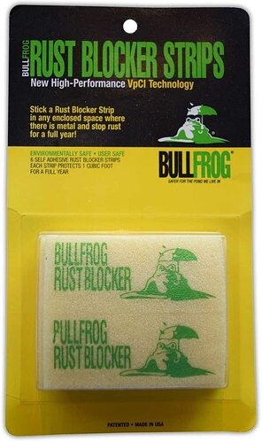

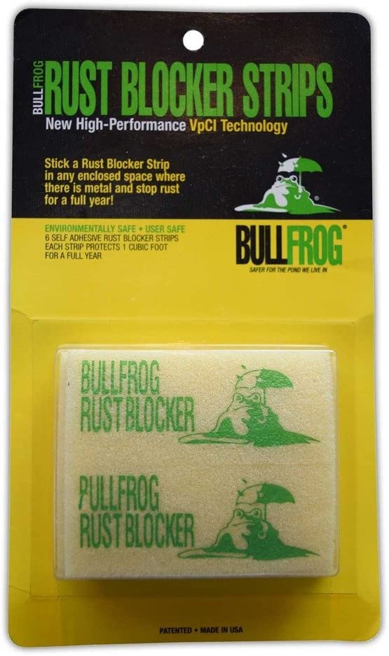

I would also put a BUllfrog or ZeRust inhibitor in the container (not touching the firearm)

I have a very hefty but small safe in the garage, Maybe OD of 2.5’ by 3’ and weighs 1500 lbs. Walls about 5 inches thick with 3/8" plate all around. Went down one afternoon (I am in wet Oregon) and the entire safe was just sweating water, whole outside totally wet. I even keep it covered in a couple layers of burlap… After seeing that, first thing I did was put a huge Bull frog VCI in the safe, and now any gun I lock up I first clean, put in a silicone cloth, put a small VCI inhibitor on top then vacuum pack it so no water can get to it even if the safe went under water.
