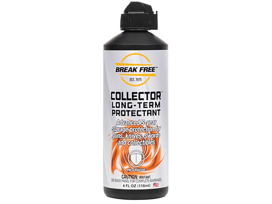

People had firearms in humid places before Mr Carrier brought us air conditioning. Humidity affects wood. For the rest I’d use this.
