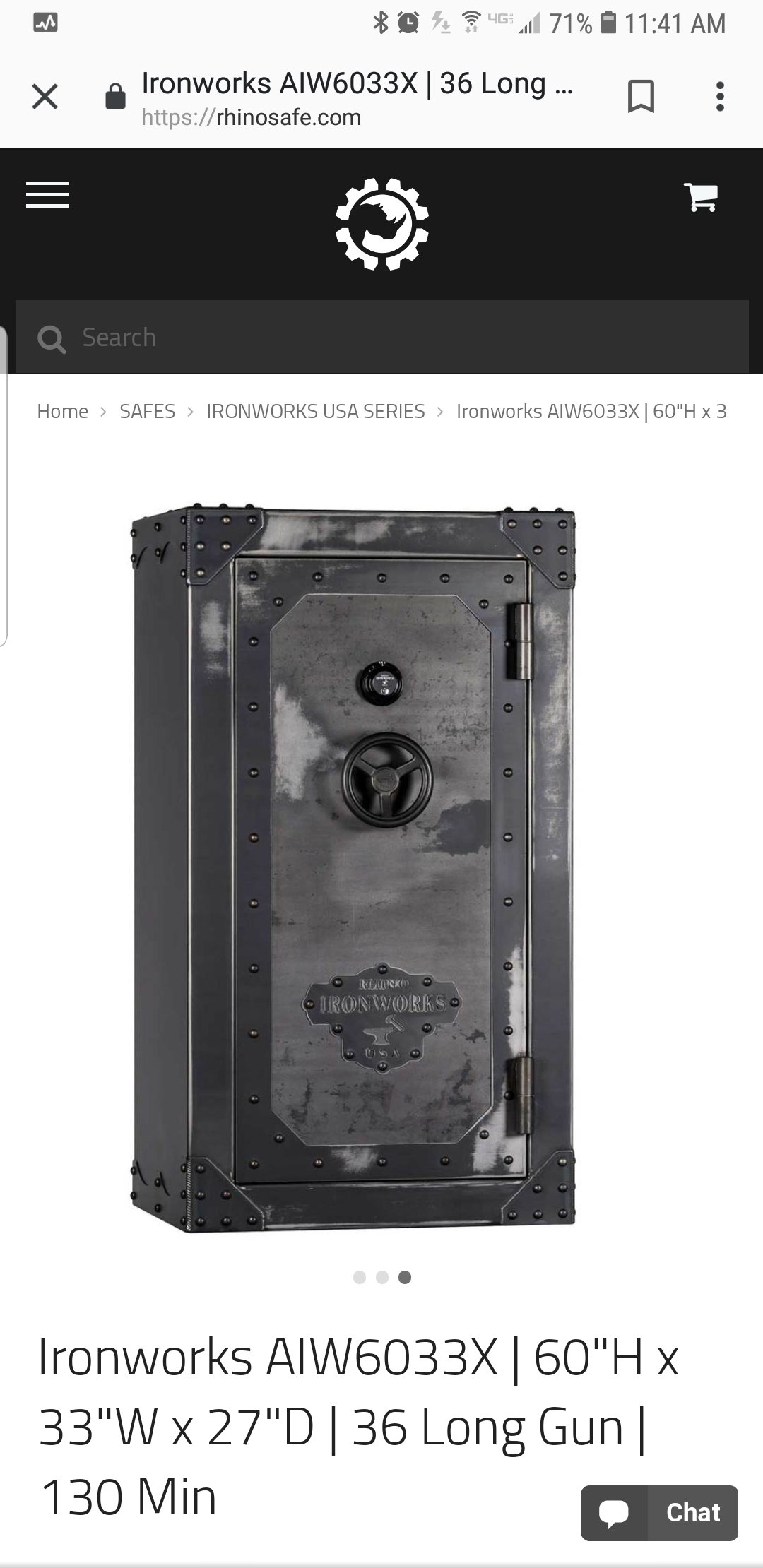

Here is the one I just purchased, last week. It is supposed to be delivered this week.

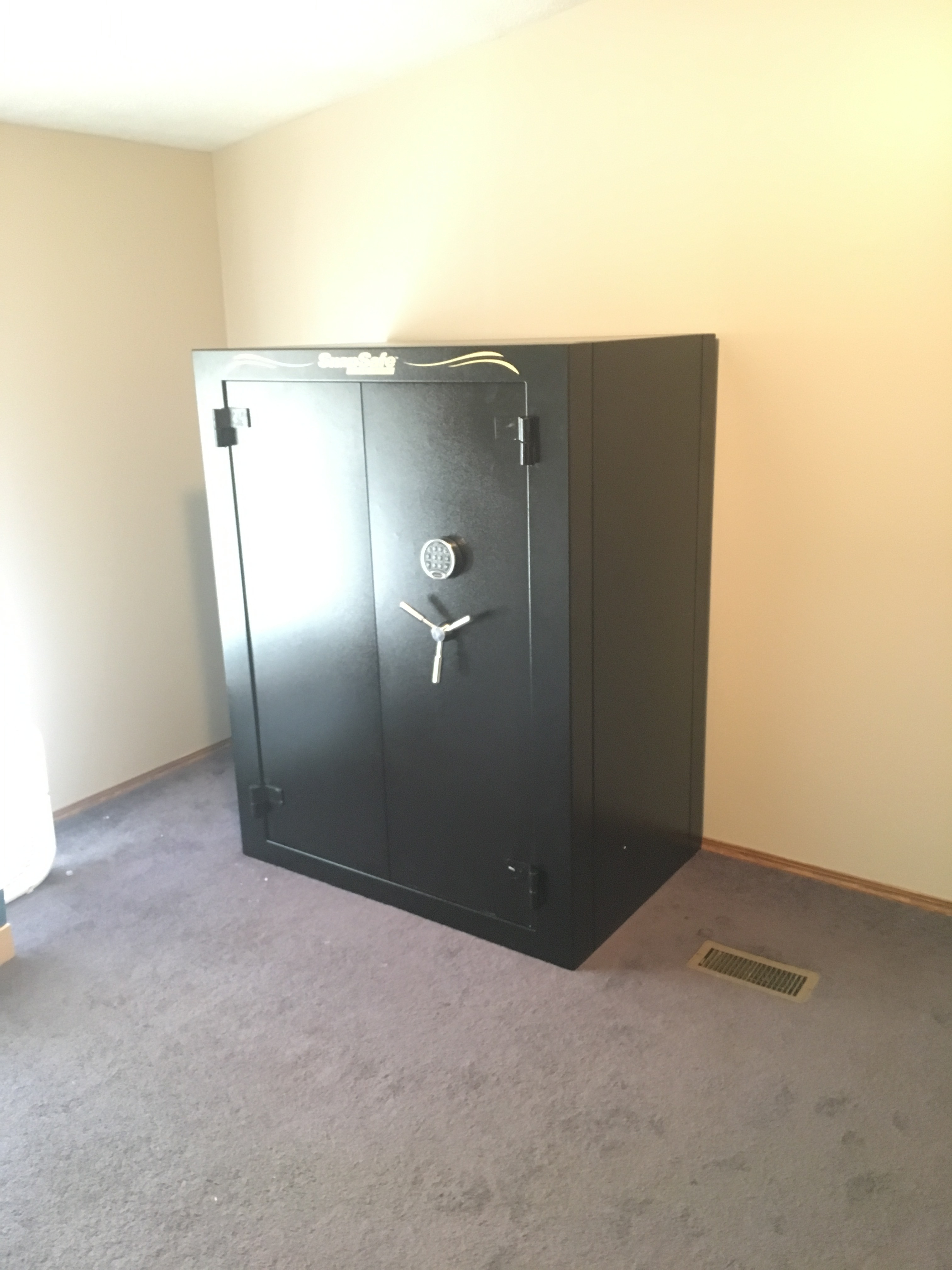

I purchased a 56 long gun safe from Snapsafe, whisch is modular and has a great fire rating. I got it on sale and delivered. 2 of us put it together in about 35 minutes. It is configured by me and holds more than 80, long guns, shotguns, and pistols. I am extremely pleased with the product. I will buy another one someday. Great product at a fair price.

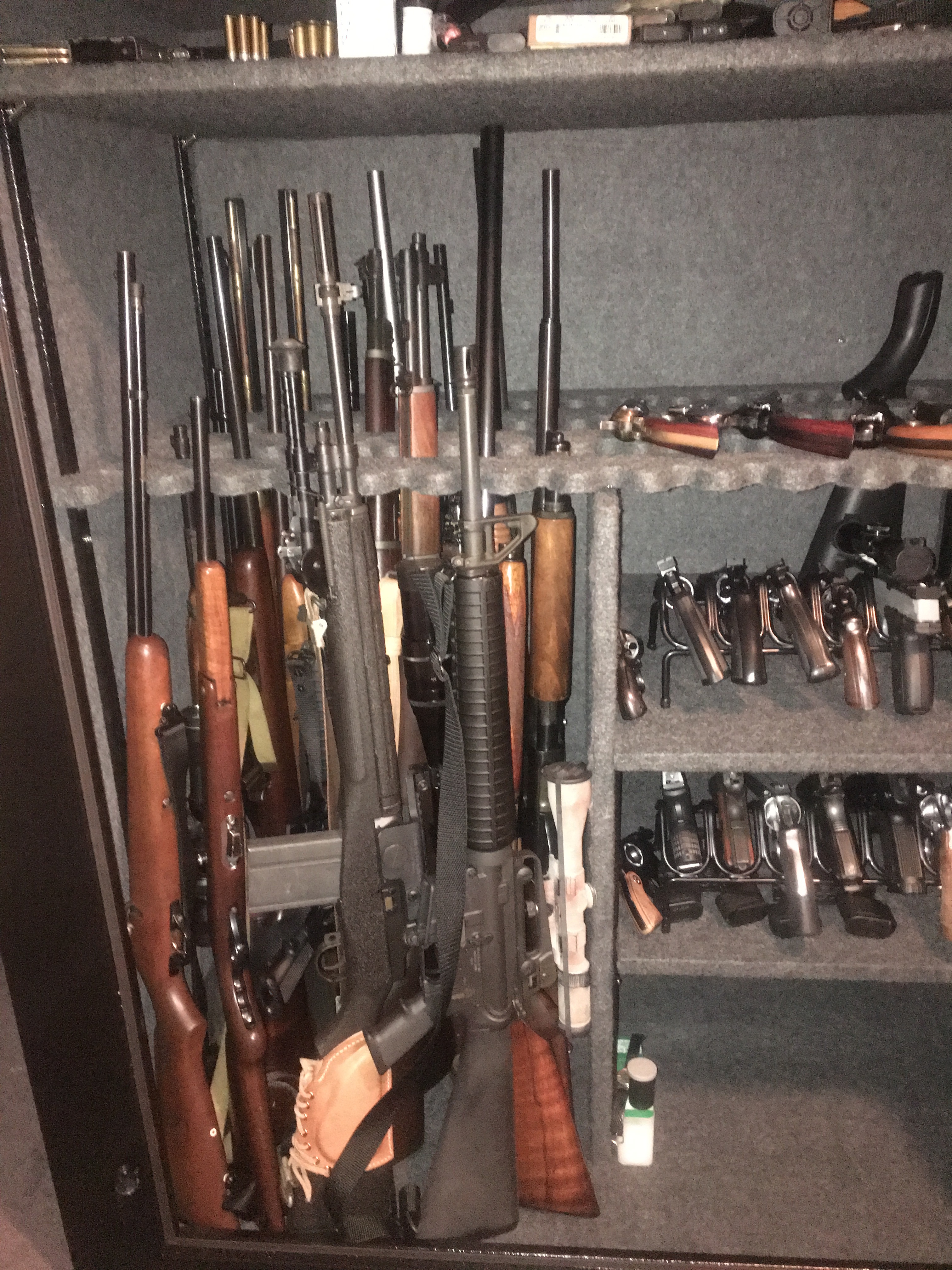

It looks like you have an open shelf in your safe??
It’s full now…I was so excited about it I took the picture early…lol
I stuffed 7 shotguns up top and brought those pistols down to the shelf…
