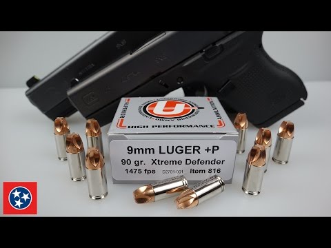

Ruger jumped on the bandwagon for this type of ammo a few years ago. I saw some tests by tnoutdoors9 on the ARX and it didn’t perform well. Underwood seems to have a better performing bullet design.
Underwood uses the bullets designed and manufactured by Lehigh Defense, who also does their own non +P cartridges. The Xtreme Penetrator in 380 or higher is exactly that…frankly too much penetration. It is a 90 gr bullet in 380. I greatly prefer the Lehigh defense Xtreme Defense which has the philips nose, 65 gr, solid copper bullet, penetrates to 15" in FBI gel consistently but opens a cavitated wound channel. You get the wound channel of a hollow point but the penetration of a FMJ. This is particularly important for .380 acp since it does not pack enough power to get great expansion of a hollow point without sacrificing penetration. It also travels pretty straight to achieve those penetrations and does not tumble like the polymer ARX rounds.
Once you get to 9mm, you can get both expansion AND penetration out of a hollow point. 380 acp is at the crossroad between expansion and penetration.
One nice thing about Xtreme Defense rounds is that they are NOT hollow points and can be used in the states that ban hollow point ammo.
Oh yes…They run well in an LCP II 380.
For .32 acp Lehigh Defense has a round called the Xtreme Cavitator. It has four scalloped sides that some to a small square tip.
They are rumored to have a .22lr round in the works but it will be crazy expensive vs. say CCI Velocitor and would only be bought by folks actually using their .22lr as their EDC.
I chose the X-Defender for my Beretta .32, I thought it was a good match for the 2" barrel.
I saved out 8 for tryout rounds and fired a 4" group at 25yds. with 1 flyer. Better then I anticipated. :+1:
There are companies I trust… i.e. Black Hills, Underwood, and Lehigh because they have a name to protect and have proven themselves.
