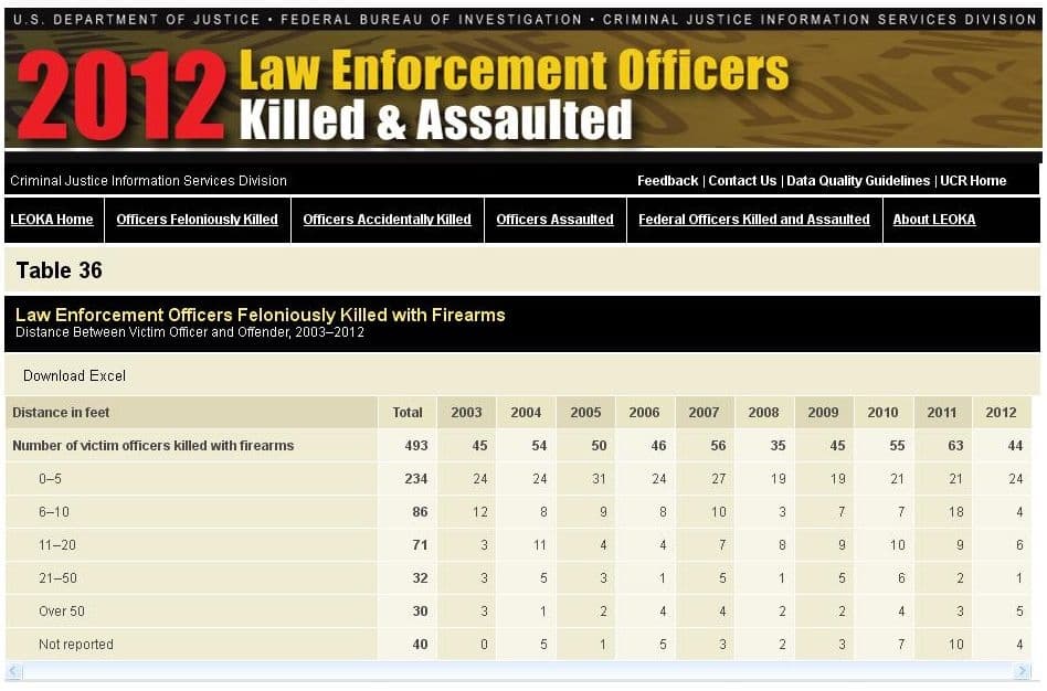

If a person can cover 6 yards a second that means at 20 yards, it would take about three seconds to cover that distance. That would be a total of 60 feet from you. The FBI say that most shootings happen around six feet away, and last 3 seconds. All of that is well but what is the idea distance to train for self-defense? Or should I ask How efficient are you at different distances? Can you place 10 rounds
in a 16-inch target at 25 yards?
Training is a vitally important part of effective concealed carry. Different schools of thought have you practice your defensive shooting skills at various distances. While there are different scenarios, 3-7 yards is a good distance to practice self-defense shooting. That would cover a vast majority of encounters where an officer was killed with a firearm. This distance covers the conditions in which you will likely need to defend yourself. Should I put it at 11 feet since half of law enforcement fatalities happen within 11 feet? Should I put it at 9 feet since an “average” self-defense encounter happens within 3 yards, lasts 3 seconds, and 3 rounds are fired.

I am not familiar with this statistic. Would you mind sharing?
Everything I can find indicate that the majority are at 3-5 yards…9-15 feet.
But longer definitely happens. Tom Givens’ data set of only sixty-some (all wins, all justified) self defense gun uses (shots fired) by prior students has one in the teens of yards and one at 20+ yards.

I also don’t know that cops are the same since their literal job is to close distance and go hands on with suspects.
Tom Givens, Concealed Carry Class, Page 88-89
93.1 % of shootings occured between 3 and7 yards, and more than 80 percent at 3-5 yards.
I haven’t seen data for defensive firearm uses showing that most are as close as 3-5 feet. Those tend to be outliers.
Edit: Here is a USCCA resource giving rule of 3s as yards per the FBI
https://www.usconcealedcarry.com/blog/the-statistically-perfect-gunfight/
“FBI stats say the average gunfight includes three rounds fired over three seconds from a distance of 3 yards.”
