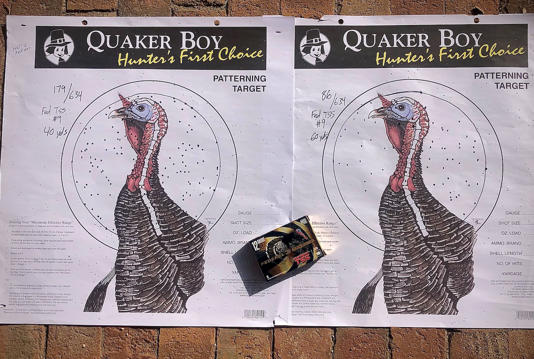

Patterning for Turkey Hunting, Varmints, and Small Game
Here are two turkey gun patterns at 40 yards (left) and 60 yards (right). You can see how pattern density severely drops off at 60 yards. Alex Robinson© Provided by Outdoor Life
Since most turkey hunting shots will be from the sitting position, that’s how we’ll pattern.
For turkey patterning, I like to bracket my distances. What I mean by that is to pick what I think is going to be my ideal harvest range and pattern at that range as well as either side by about 10 yards. For example if I expect my ideal range to be 30 yards, I would pattern at 20, 30, and 40 yards to have solid data. The standard for evaluating turkey targets is to count the number of pellet strikes within a 10-inch circle over the core of the pattern. For consistent kills, you want to put at least 100 pellet strikes inside that 10-inch circle, centered over the gobbler’s neck. If your gun/choke/load combination cannot do this at a given distance, then you know that specific distance is beyond your effective range. A 12 gauge turkey gun with a turkey-specific choke and TSS loads should put at least 100 pellets on target at 50 yards. So if you are shooting this kind of setup it makes sense to shoot at 40, 50, and 60 yards. If you are shooting a sub-gauge or lead loads, it’s wise to pattern at 20, 30, and 40 yards.
There are a variety of turkey targets out there, which are fine for getting a visual representation of how your pattern might impact a turkey. But you still want to shoot at a larger piece of paper to get a true understanding of your pattern. So if you do shoot a turkey target, staple it over a larger sheet of paper (48 inches by 48 inches is ideal).
Now that we’ve got our target and distance figured out, follow these steps.
  1. With your hunting ammo, take your shot from a comfy seated position with a solid rest. Aim for the turkey’s neck, not its head. (Read our guide on where to shoot a turkey).
  2. Shoot from the closer distance first.
  3. Assess your pattern. Don’t worry about counting your pellets in your little circle yet, but do look at pellet strike concentration and its relation to your aim point. If you’re not dead on, then we need to do some adjusting. If you are shooting with a red dot sight or adjustable open sights, then simply sight it in just as you would a rifle. If you are shooting with a bead, then you might have to adjust your aim point to get on target.
  4. Now with a dialed in sight or aim point, let’s bracket our distances. Shoot three times (three different targets) at each distance.
  5. Evaluate your targets at all ranges. If you see a dense smattering of pellet strikes over the turkey’s vitals on all targets, you’re good to go. If not, you either need to decrease your max range or tweak your load/choke combo (and possibly do some more practicing with your turkey gun).
  6. Take one final shot at 10 yards. This will give you an idea of how tight your pattern is at close range.
