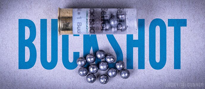

I like the Federal flight control/Hornady critical defense versa tight, in a cylinder bore or with a cylinder choke. Maximum tightness. 8 pellet 00 is probably best although the 15 pellet #1 may have a good argument

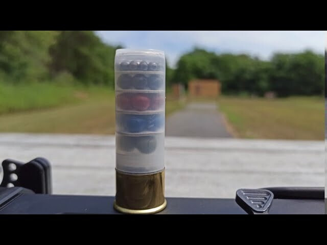

Can’t figure out if you want 00 or 000 buck? why not both and some 0000 to boot? Maybe toss in some bird shot. The shredder took all the guesswork out and put it all in one round. I fired a few a year or so back. Fun rounds.
I know there are some others that use a combined slug/buck round. I haven’t fired any of those, though, but they seem like they’d be good for home defense. I believe Estate makes (made?) a police round that had a slug with buck.

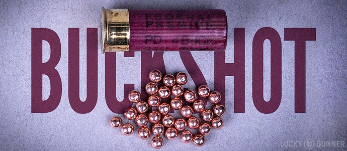

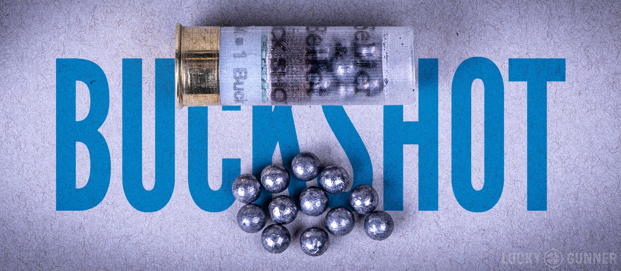

#4 buckshot is .24 size, while #1 buckshot is .30 in size. A 1.2-ounce slug leaves a 5/8-inch entry wound and variable exit sizes. I like the #1 Buckshot myself.
For my home defense Remington 870 with a 20 inch barrel, cylinder bore; #1 Buck seemed to pattern better at 15 yards.

I’m new to the shotgun world and it isn’t really a SD option for me. But when considering it and researching the options #1 buck seemed like a good choice. Sufficient penetration with less risk of over penetration. Some #4 bucks did not penetrate sufficiently in testing, though plated #4 usually met the minimum standard and may be a good option if you have neighbors nearby. 00 over penetrates and goes through multiple walls. Unfortunately #1 isn’t the most available option.
