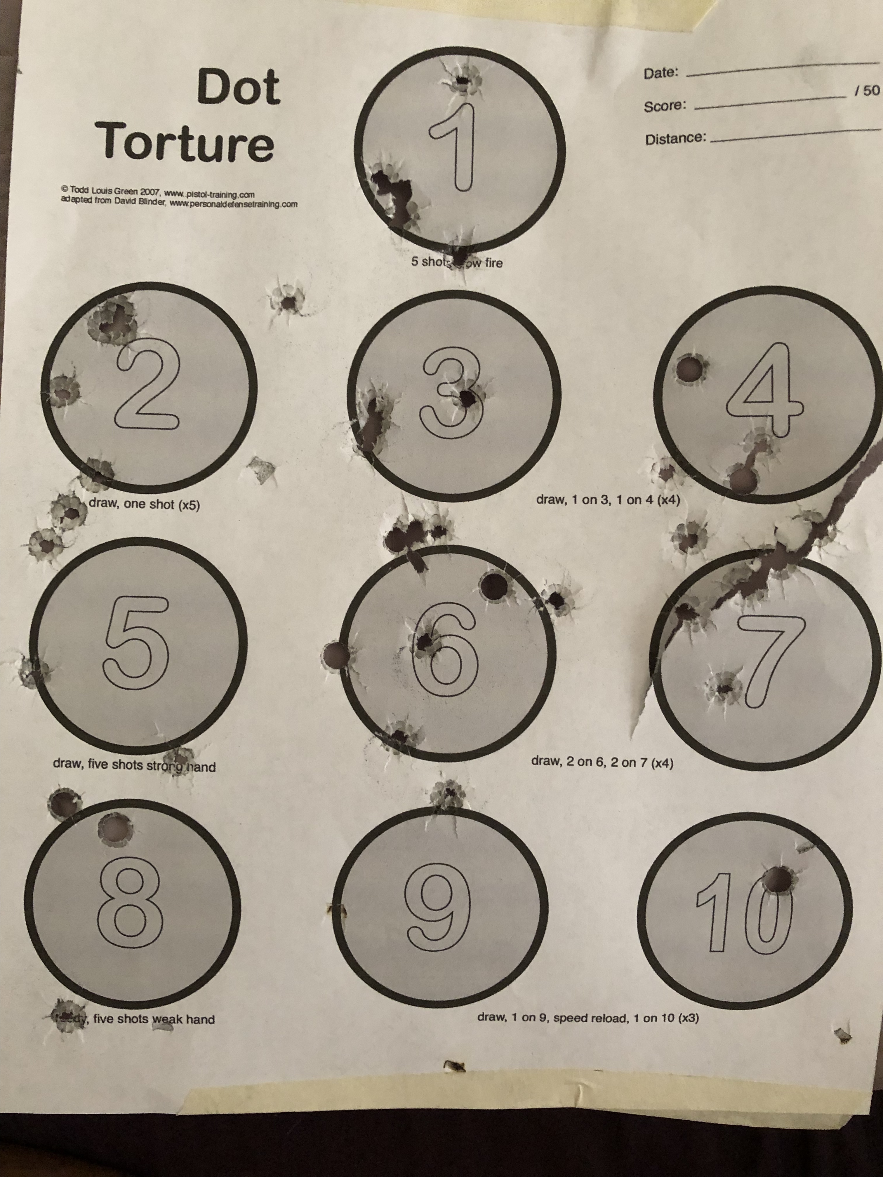

I have a Google Drive File of printable targets that I rotate through depending on what I feel I need to work on. Dot Torture always kicks my butt.

I’m gonna try that one, see if it kicks my butt too.
@Zee not sure if the full folder is accessible but here’s all the targets and drills I have saved.
https://drive.google.com/drive/folders/1KwsEOaeNP9dboegYxQFZTnqEGyY7JpXu
@Zee here’s my last attempt (Tuesday) at dot torture.
What distance and which gun?
And gonna go with … it’s all still center mass.
@Zee that one is the shield at about 10’ both eyes open. Trying to train myself away from dominant eye shooting (it’s how I was taught many moons ago when Jesus was a child).
